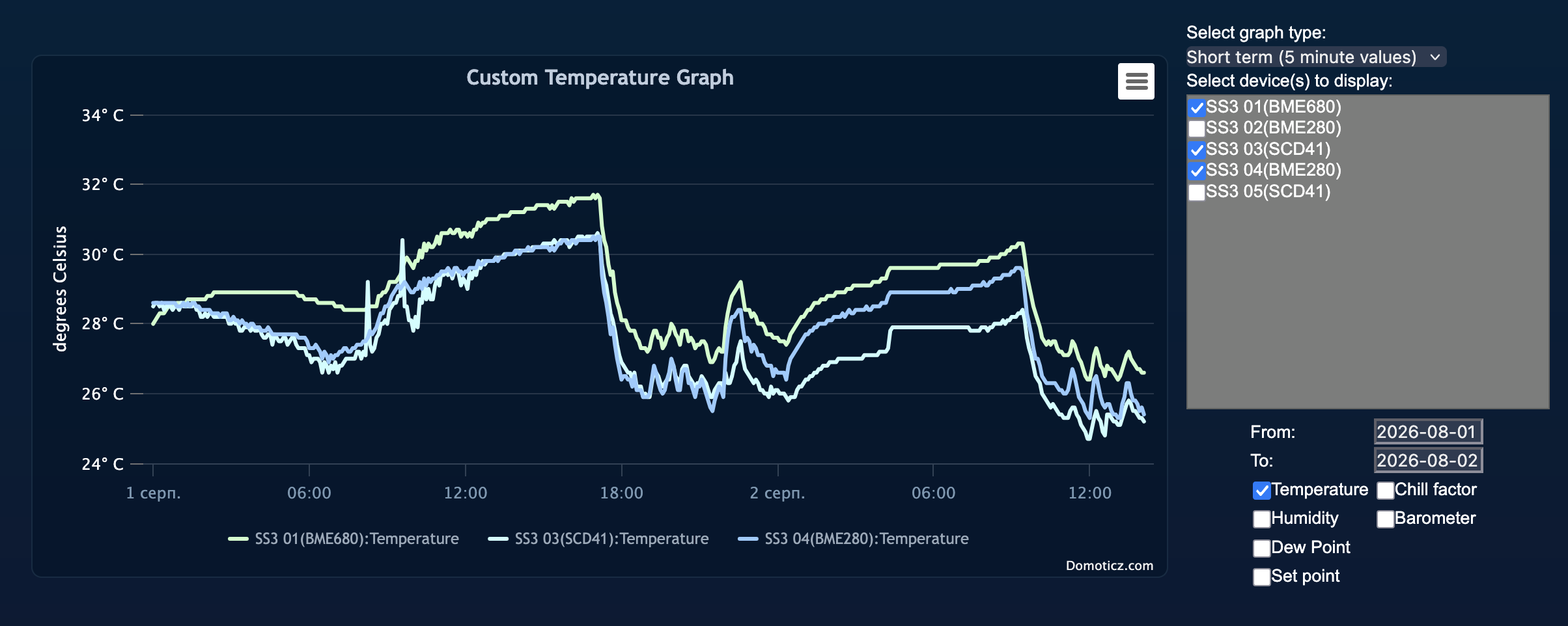

    I finally got my hands on an SCD41, added driver support for it, and landed a few other improvements along the way. The sensor arrived together with a couple more CYD boards, so the fleet is now five stations: one BME680 (with BSEC), two BME280, and two SCD41.
    That's when the party started.

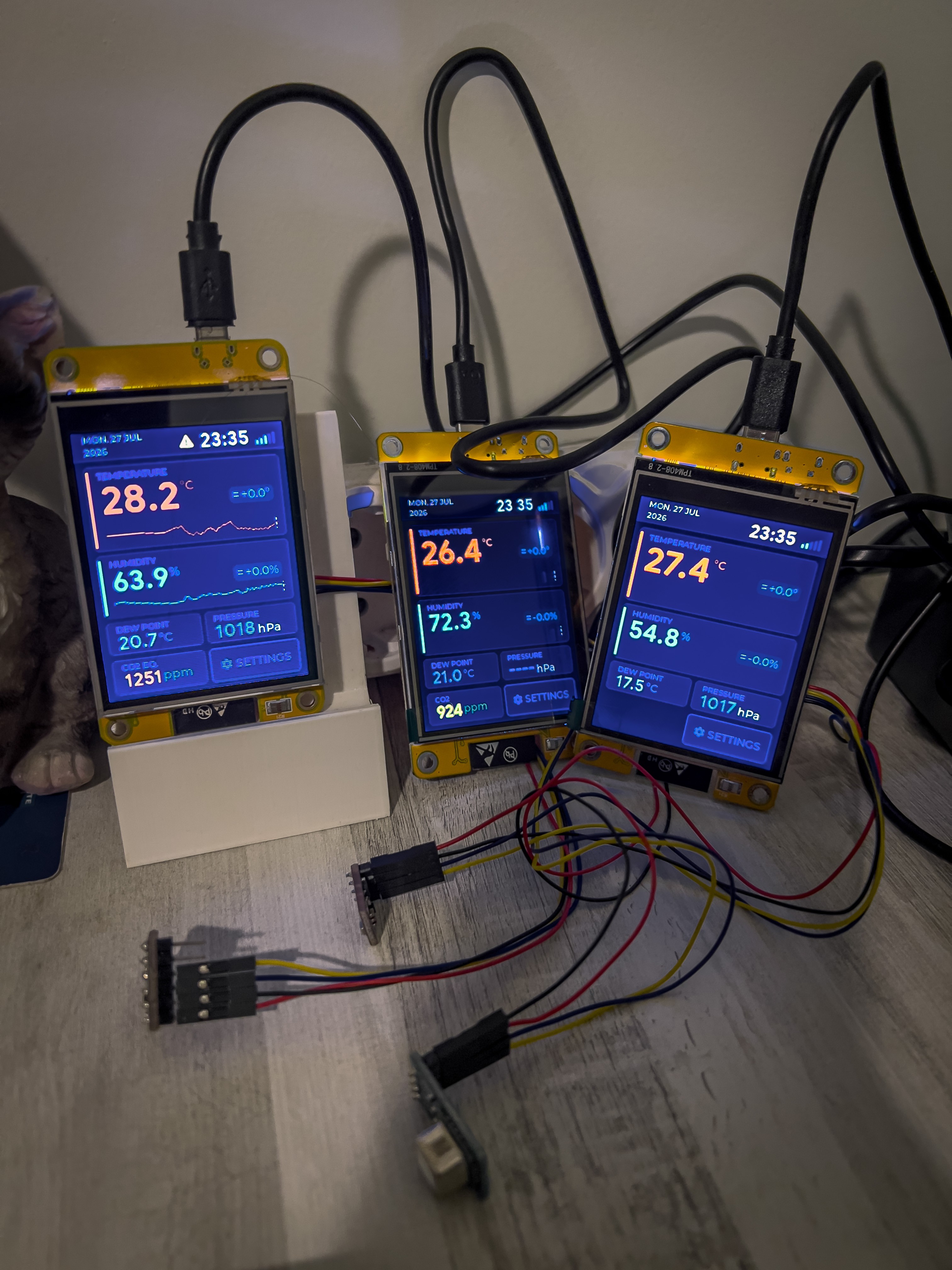

    The setup
    Units running the same sensor agree with each other closely, so there was no point comparing all five. I narrowed it down to three devices, one per sensor type, all sitting in the same spot with the sensing elements inside a 3 cm radius of each other. Same air, same room, same moment.
    The SCD41 runs in periodic measurement mode (one reading every 5 s).
    The numbers
    DeviceTemperatureDelta
    SCD4126.4 °C−1.0
    BME28027.4 °C0.0 (arbitrary zero)
    BME68028.2 °C+0.8
    Almost 2 °C spread. The zero point is arbitrary — I picked the BME280 purely so the numbers are easy to read in both directions, not because I think it's correct.

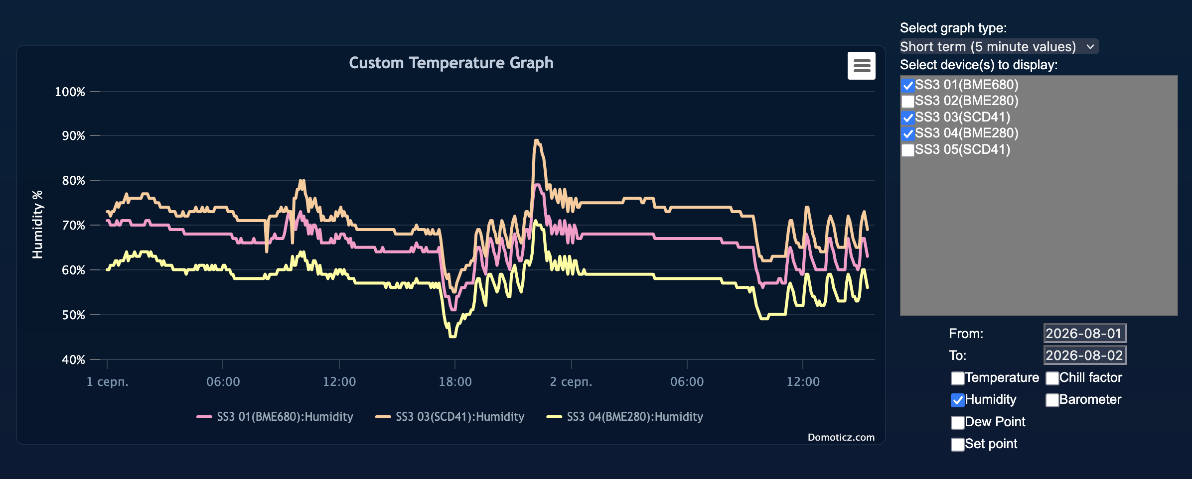

    Humidity is worse, and CO2 from the BME680 and the SCD41 might as well be measuring different rooms.
    What is not the problem
    Two BME280s and two SCD41s both stay inside their datasheet specs relative to their twins: ±0.3 °C, ±5 % RH, and ±50 ppm for the SCD41. Pressure across all the BME parts differs by no more than 1 hPa. If everything were that well-behaved, I would not be writing this.
    So the disagreement is between sensor types, not between boards.
    Then it got more interesting
    I hooked all of them up to a server running Domoticz, Home Assistant and ThingsBoard to collect proper telemetry, and left them alone for a day.
    The next evening I sat down to work out how to reconcile them and pick a reference. And the floor fell out again: the difference between sensors is not constant. It drifts, over a fairly wide range, and the largest divergences line up with the moments when the room temperature is changing fastest.
    A constant offset is easy — you calibrate it out once and forget about it. A drifting one means something in the system is modulating the readings, and I don't yet know what.

    Relative humidity is a function of temperature, so with the units reporting temperatures up to 2 °C apart, some of the %RH spread has to be an artefact rather than a real disagreement. I checked dew point for exactly that reason — and it differs substantially too. So the humidity readings genuinely disagree; the temperature offset is not the whole story.
