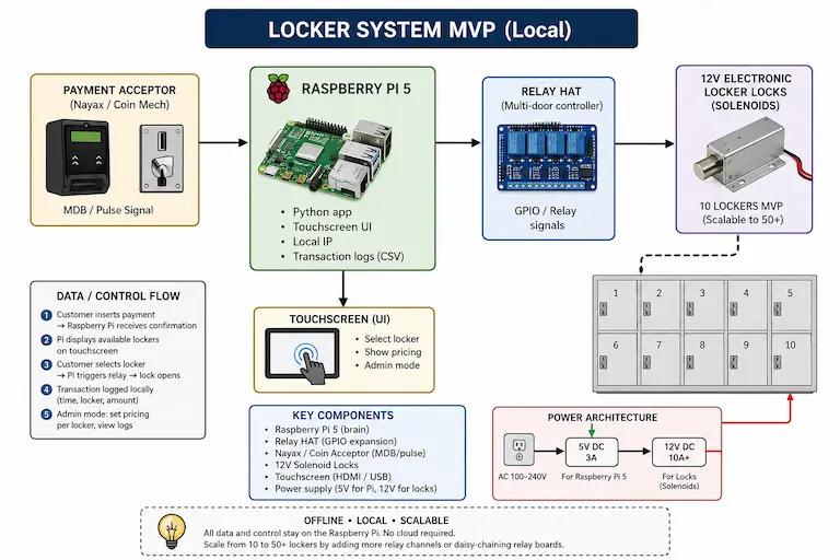

We've all been there. You need to pick up a package from a locker, but the interface is clunky, the screen is unresponsive, and you're left jabbing at a resistive touch panel from 2008. Or worse — you run a small business selling specialty goods, and you're stuck with off-the-shelf vending machines that don't fit your product dimensions.
So we built our own. A smart locker system running on a Raspberry Pi 4, paired with a Nayax VPOS payment terminal. It's a customizable vending machine that handles cashless payments, remote inventory tracking, and live door status monitoring. And it ships as a complete prototype — PCB, firmware, 3D-printed enclosure, the works.

So we spec'd out a system around a Raspberry Pi 4 (4GB), a Nayax VPOS Touch, and a bank of solenoid-driven locker doors. Total BOM cost? Around $180 per 12-locker unit, not including the terminal.
Features
Payment agnostic. The Nayax VPOS handles Visa, Mastercard, Amex, Apple Pay, Google Pay, and even WeChat Pay. We talk to it over a simple serial UART connection — no proprietary SDK lock-in.
Modular locker architecture. Each locker door has a magnetic reed switch for status sensing and a 12V solenoid for release. We used a MCP23017 I/O expander over I2C to control 16 solenoids from a single Pi. Need more lockers? Add another expander.
Real-time dashboard. The Pi runs a Node-RED instance that publishes door status, transaction logs, and inventory levels over MQTT. We feed this into a Grafana dashboard hosted on a $5/month VPS. You can see exactly which locker is empty, which one just dispensed, and how much revenue came in today.
Fail-safe operation. If the Pi crashes mid-transaction, the Nayax terminal still records the payment. We log all events to a local SQLite database and sync to the cloud when the connection returns. No lost revenue.

    We didn't just throw parts on a breadboard. The PCB is a custom 2-layer board designed in KiCad 7.0. It routes the I2C bus, power distribution for solenoids, and screw terminals for each reed switch. The enclosure is a stack of 3D-printed PLA trays — each tray holds four lockers. We used Fusion 360 for the mechanical design and printed on a Bambu Lab X1 Carbon. Took about 14 hours total print time.
    The firmware is written in C using the WiringPi library on Raspberry Pi OS Lite (64-bit). The Nayax integration uses a custom serial protocol — we send a simple ASCII command like `PAY 1.50` and get back `APPROVED` or `DECLINED`. No JSON, no REST, just clean serial.
