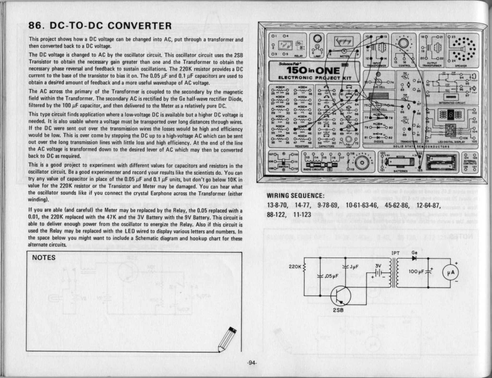

    What was once called a joule thief, during the green revolution.
    Everything relied on a single transistor oscillator.  If that didn't work, the whole kit was cactus.  This one seemed to always use a transformer with the transistor to make a sustained tone.
    Their basic single transistor oscillator used a transformer + transistor.

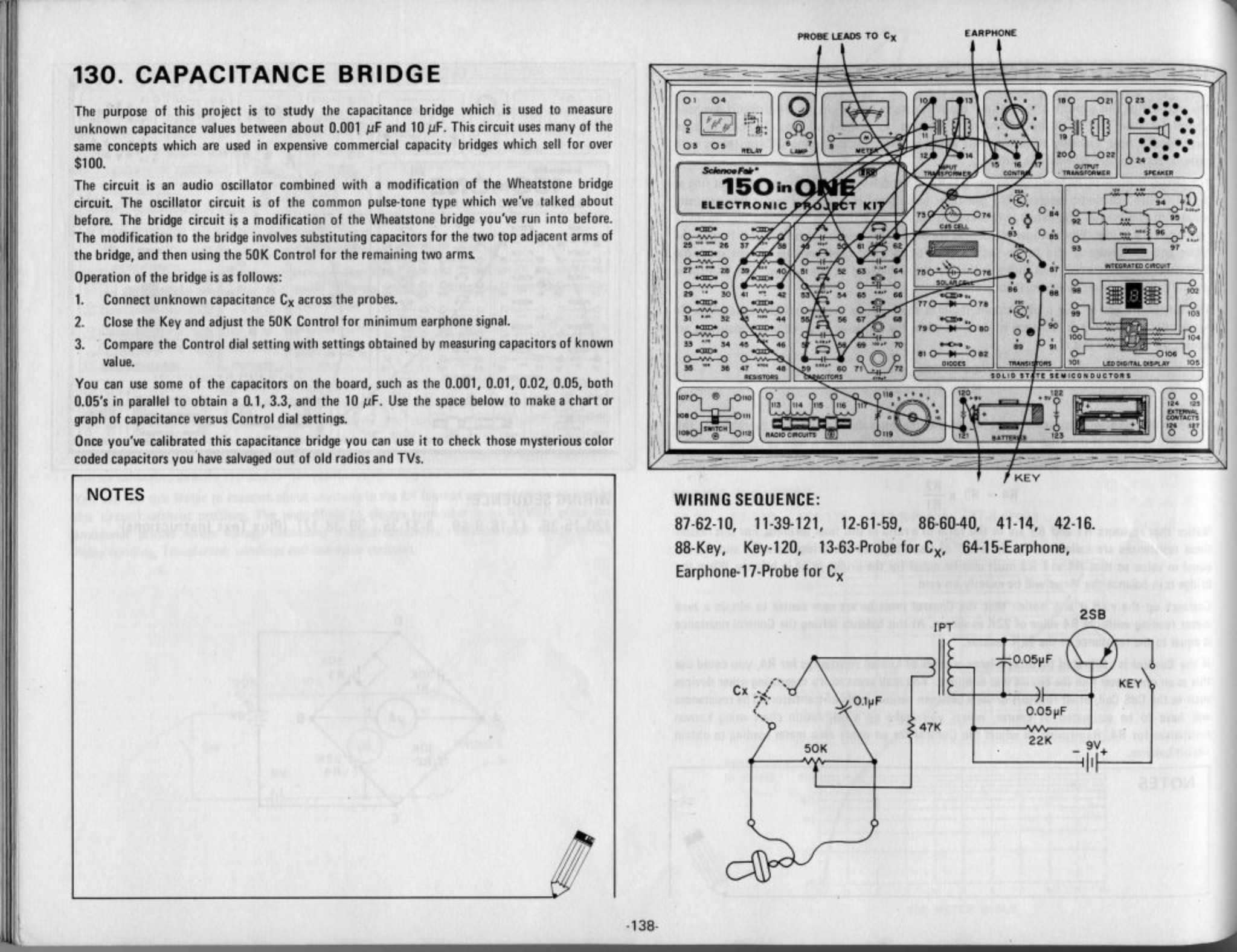

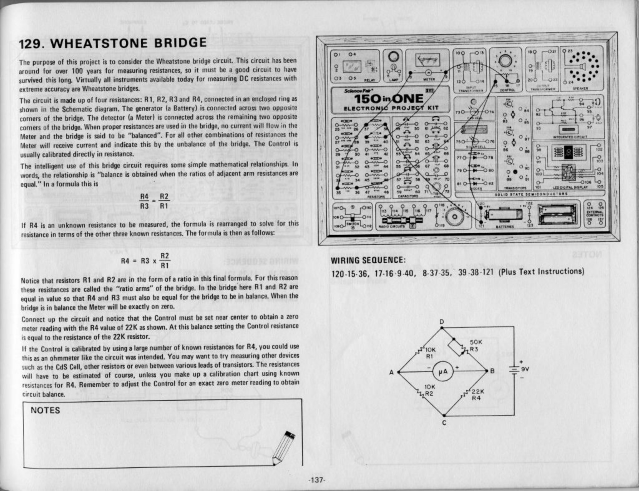

    Lion eyes started watering with the wheatstone bridge & the capacitance bridge.
