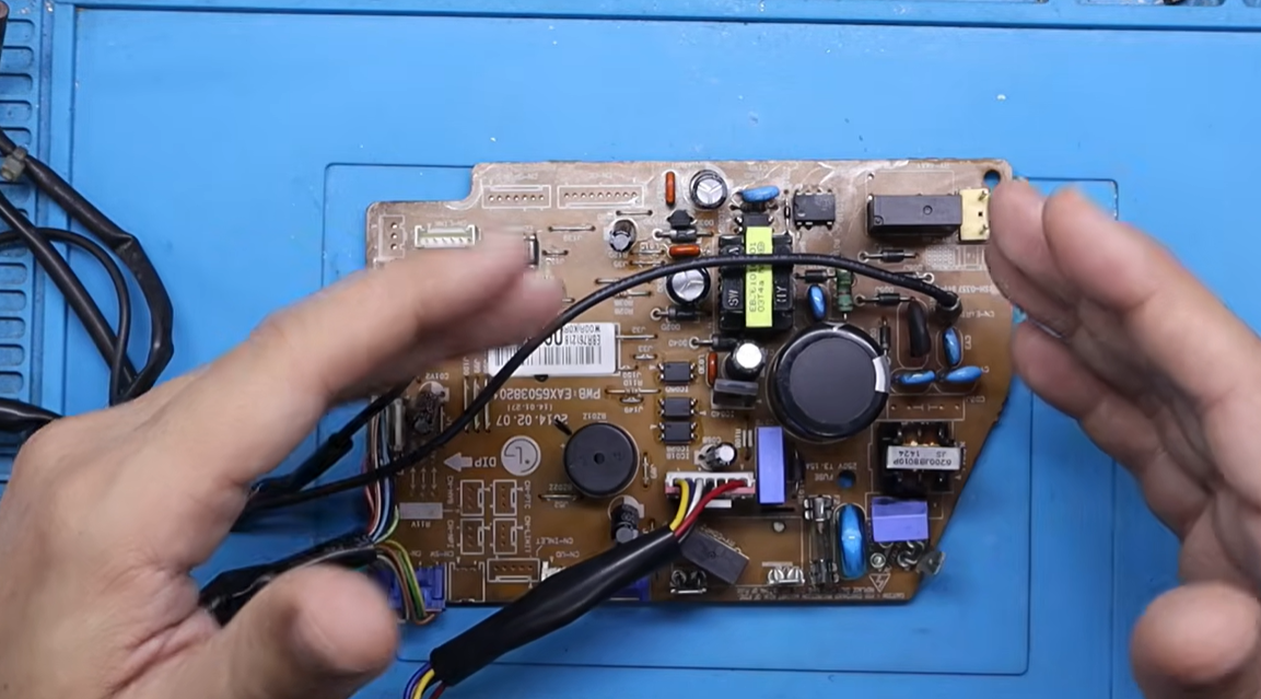

Brief overview of diagnosing a dead electronic card (in this case, an LG air conditioner indoor unit PCB that refuses to power on). Emphasizing methodical troubleshooting over guesswork.
Have you ever plugged in an appliance only to find it completely dead? Instead of tossing out expensive electronics or paying hefty service fees, standard debugging procedures can help bring them back to life. In this project, we break down a common failure mode in switch-mode power supplies (SMPS) using an LG air conditioner indoor unit control board as a case study.
By following a systematic approach involving visual inspection, multimeter diagnostics, component isolation, and safe power-up testing, we can locate and eliminate dead shorts.
  • 1
    Step 1

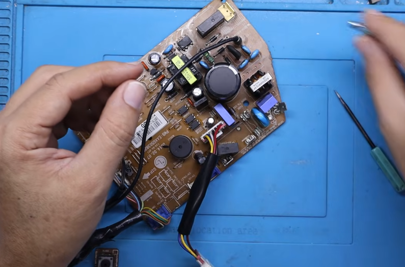

    1. Visual Inspection (The Blown Fuse): Spotting physical damage like shattered glass fuses and cracked components (NTC thermistor).
  • 2
    Step 2

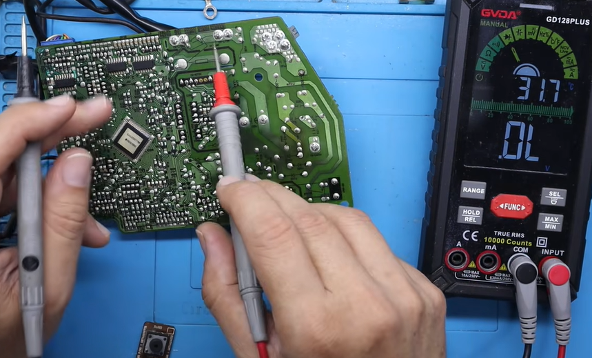

    2. Multimeter Testing & Short Detection: Using a multimeter in diode/continuity mode to track shorts from the AC input to the switching regulator stage.
  • 3
    Step 3
    3. Component Removal & Verification: Desoldering damaged NTC thermistors and bridge rectifier/diodes (such as 1N4007 diodes), then re-testing the circuit traces.
