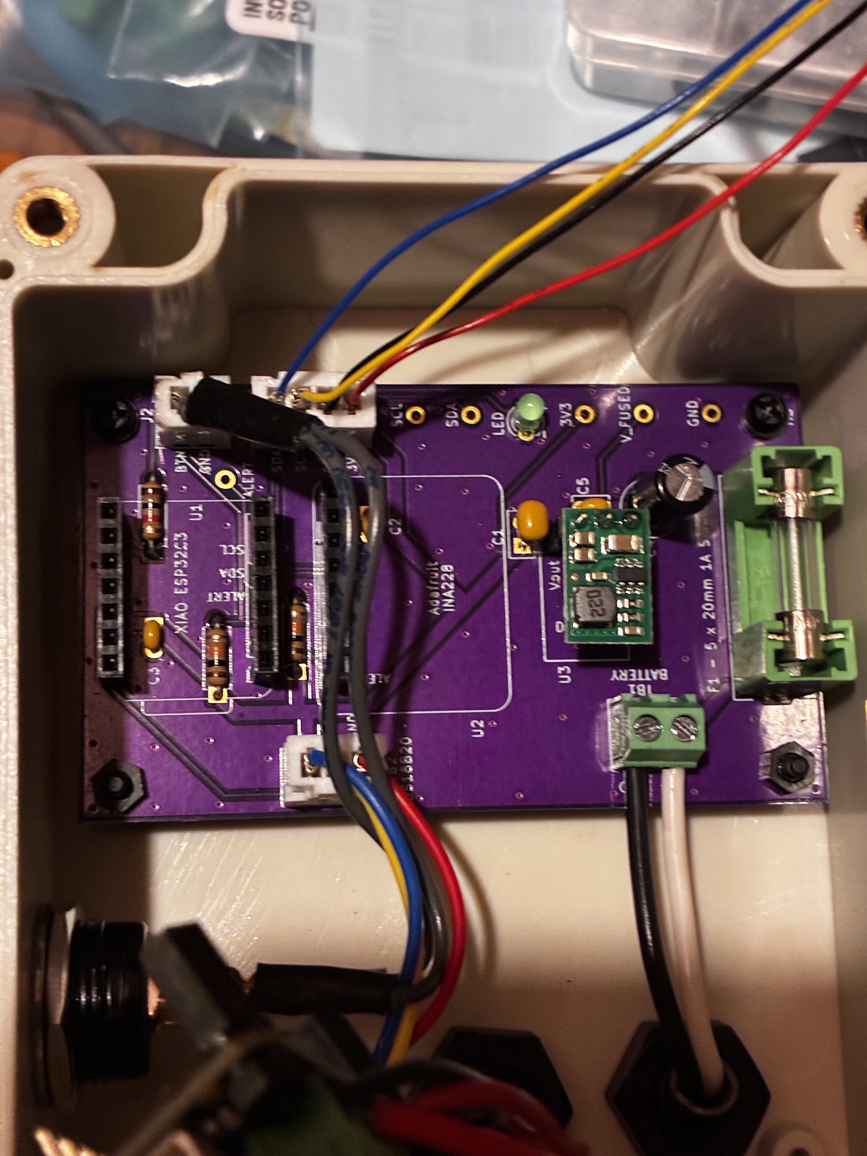

Same carrier philosophy as the UPS-MONITOR-THT V1 you shipped to OSH Park:
  • Sensor: Adafruit INA228 breakout, on-board 15 mΩ shunt removed, 20-bit, ADCRANGE 0 = ±163.84 mV, 4120 µs x 128 averaging, 2s poll, Kelvin taps to DROK 200A / 75mV manganin shunt (375 µΩ) in negative leg, low-side
  • Voltage: Fused VBUS lead from positive busbar — 195.3125 µV LSB survives end-to-end to HA CSV export, σ ≈ 0.10 mV (half an LSB)
  • Brain: Seeed XIAO ESP32-C3, ESPHome
  • Temp: DS18B20 on pack case, isolated mount

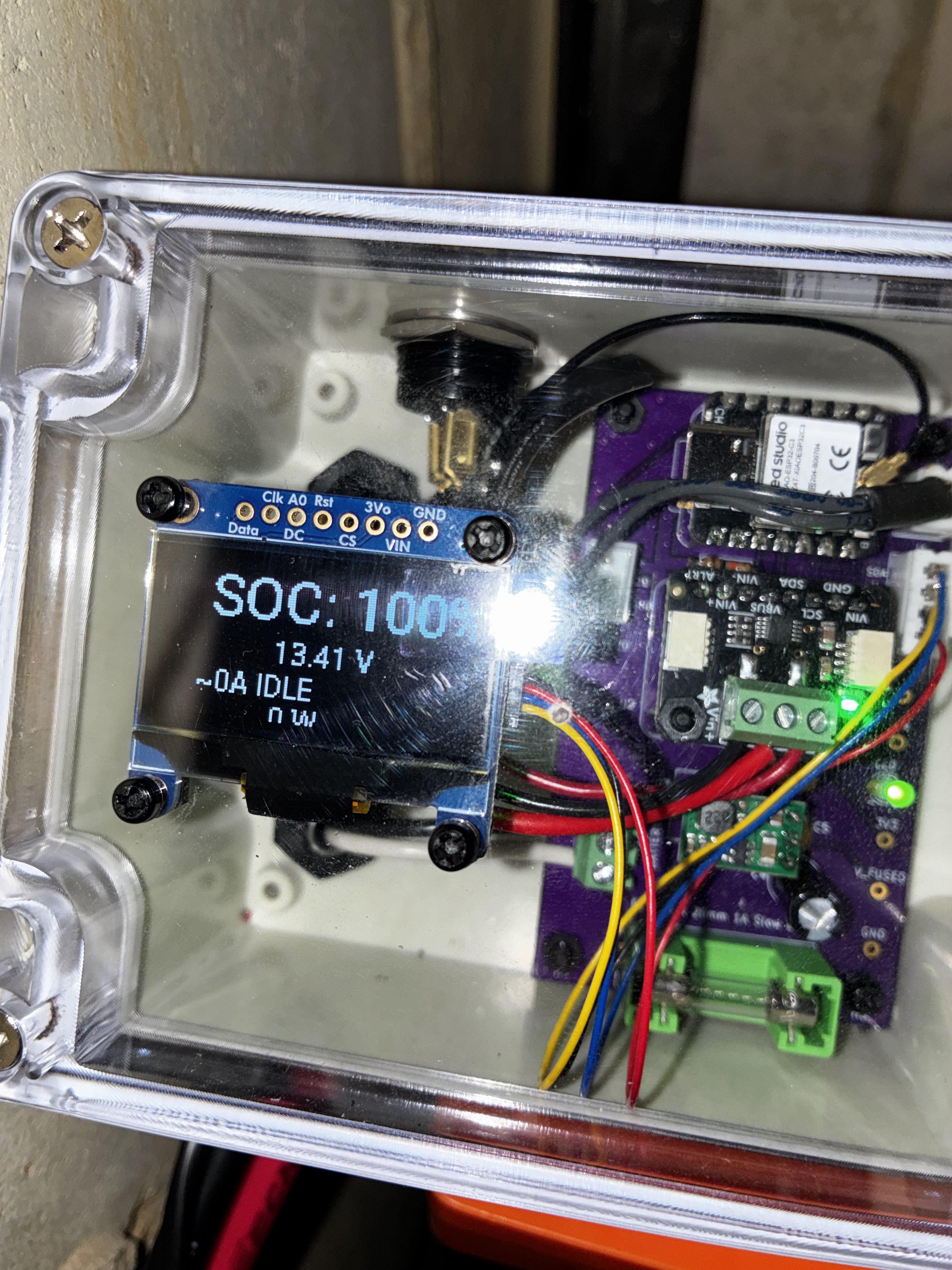

  • UI: SSD1306 OLED STEMMA  + wake button + status LED (slow-flash proof-of-life / solid active / fast FAULT)
  • Power: Pololu D24V7F3 3.3v regulator
Firmware V1.21 at commissioning: 2s integration (stale-bus watchdog 10s, 8-16V and ≥350A plausibility guards), coulomb-counted SOC anchored at confirmed full-charge (≥14.20V sustained 60s + charger-stop edge), true signed mW power.
Independent hardware alerts written to INA228 at boot and latched on GPIO5: BUVL 12.20V, BOVL 14.80V, SOVL +250A, SUVL -250A, POL 1500W — decoded to alert_reason with operator acknowledge, independent of firmware.

Coulomb-counted, anchored at full charge. First anchor: 2026-07-16 19:50 UTC, SOC 100.0%, 1 cycle

Custom PCB, fabrication by OSH Park
