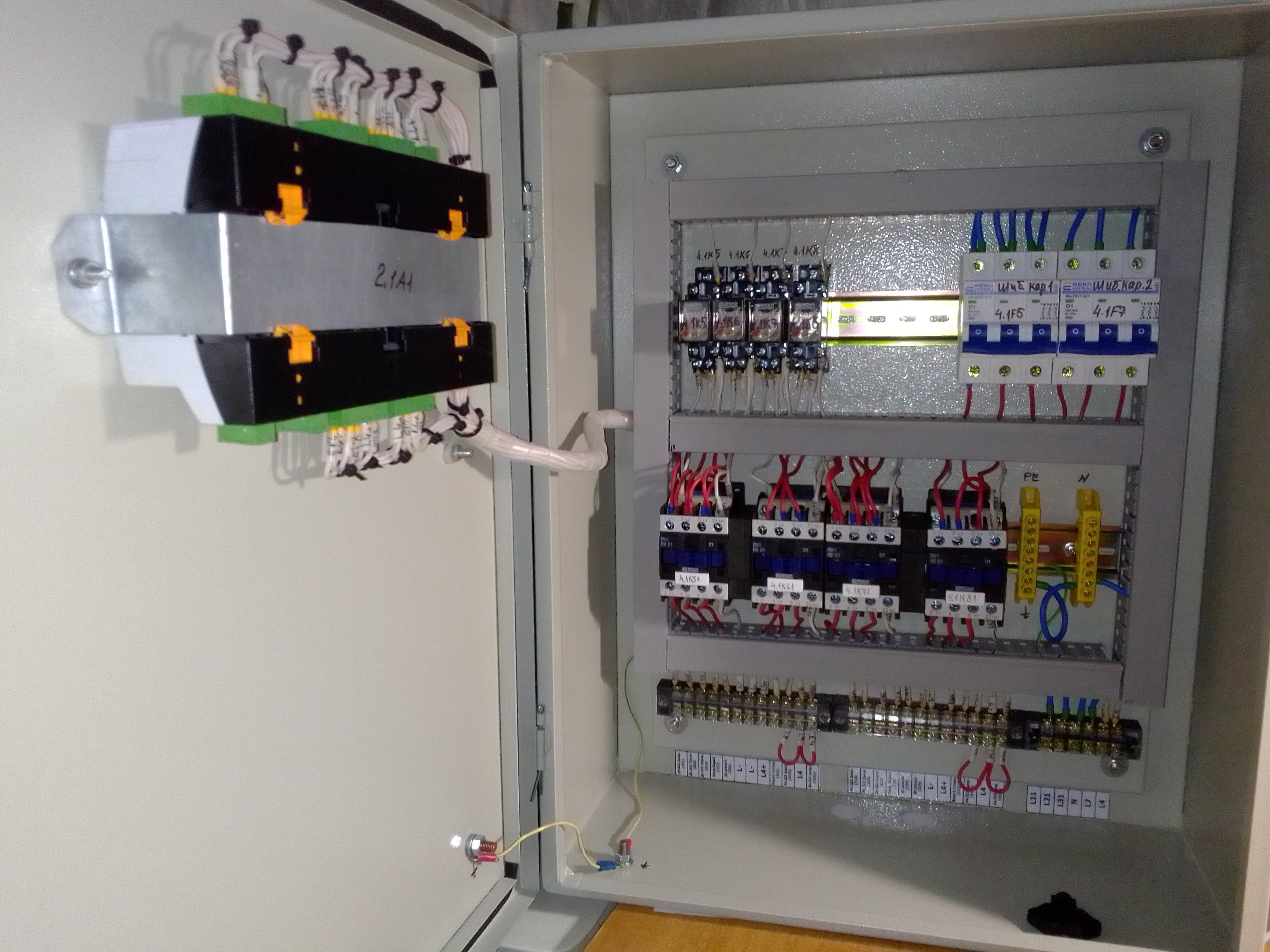

   Control cabinet of the automatic dosing system installed on the production machine

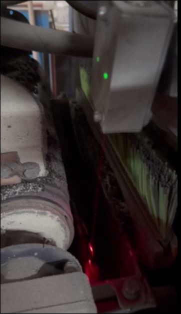

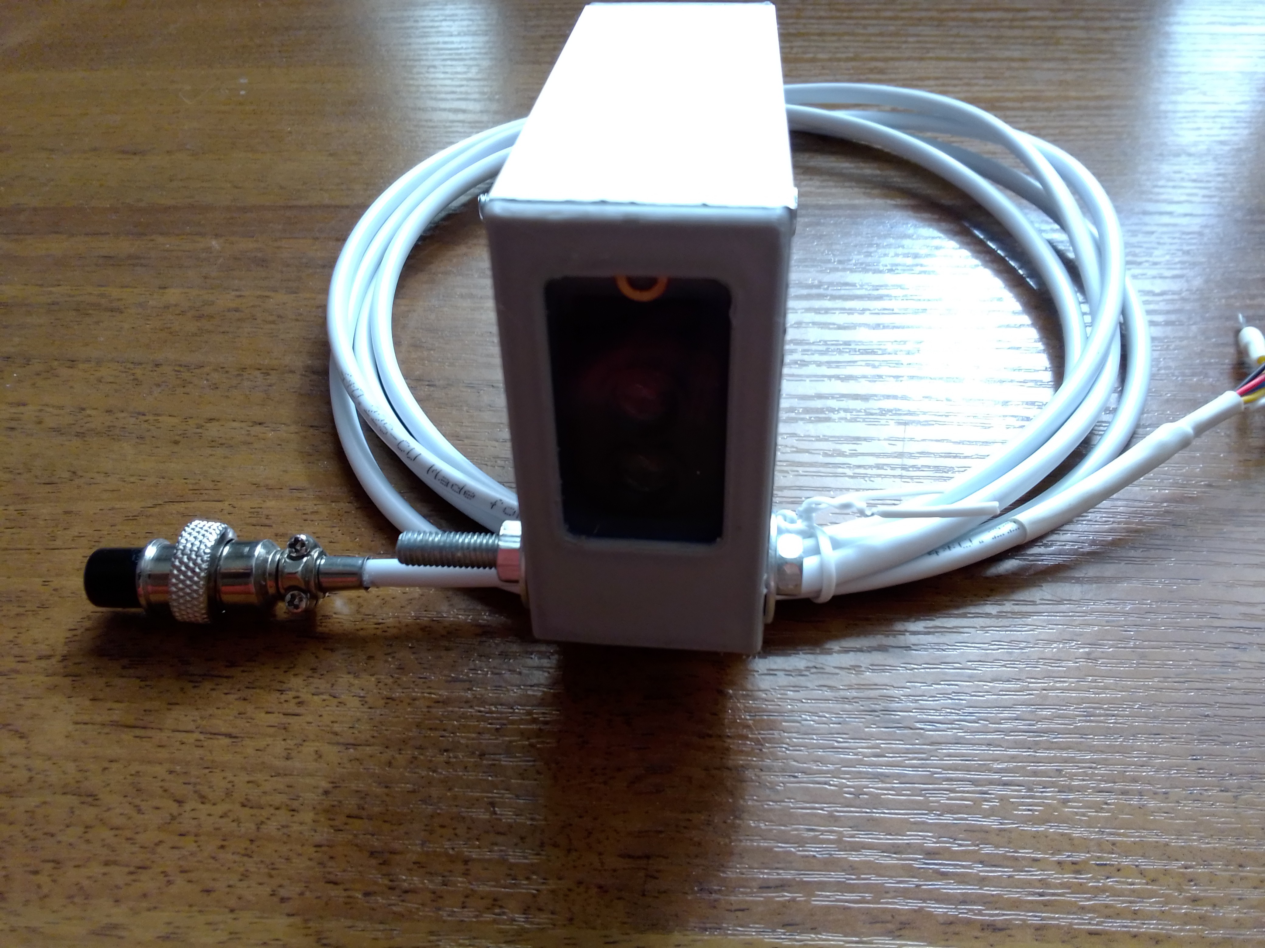

   A specially designed laser distance sensor for measuring concrete levels during the vibro-pressing process
   TF-Luna ToF laser module used as the optical sensing element

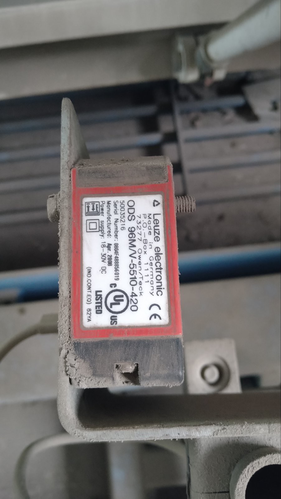

    Original laser sensor previously used in the production machine
   After laboratory testing, the sensor was installed on the second hopper carriage of a concrete block production machine, where it is used to control the dosing of the concrete mixture.
    It has now been operating continuously as part of the production line and has been successfully used in daily industrial operation for several months.
