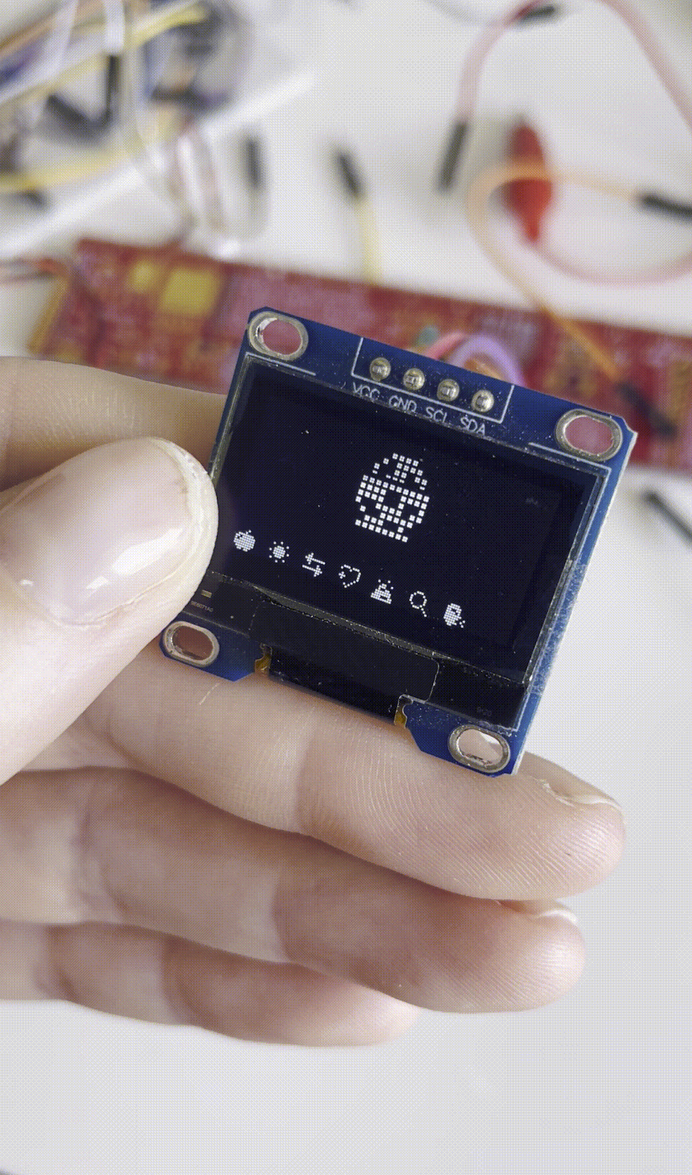

Arduino Nano Tamagotchi
DIY Tamagotchi emulator with a 3D printed shell!
Head back to the 90s by making your own Arduino-based Tamagotchi!
This is a Nano-adapted version of ArduinoGotchi, based on GPL-licensed firmware by Gary Kwok, modified for a compact handheld build.
This page is a short version of the full instructions, which can be found on Instructables.  The files for the project, components needed, and the accompanying instructions are all there!

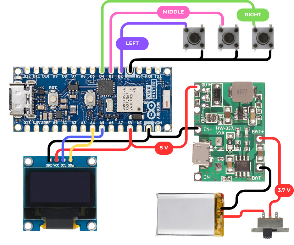

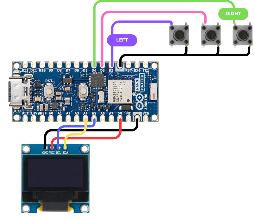

    Step 2: Breadboarding
    Upload the code to your Nano. If it compiles successfully, test your circuit using this wiring diagram. Press the middle button to bring your screen to life.
  • 3

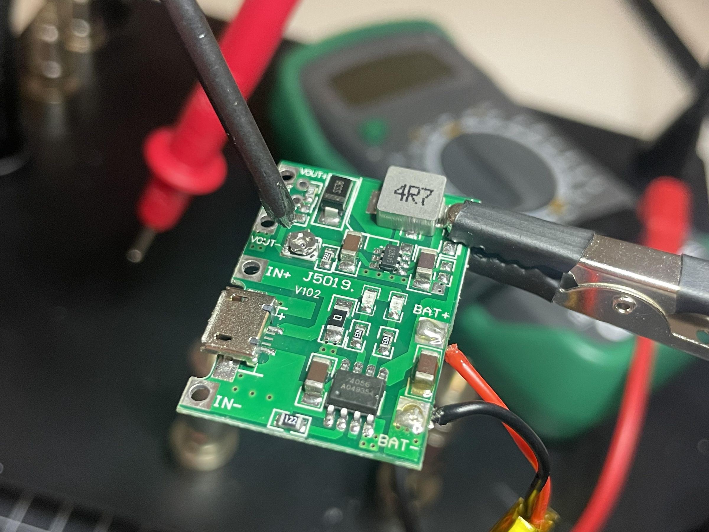

    Step 3: Power
    Disconnect your Nano from your computer.
    Once you've got your screen working, temporarily hook your circuit up to the battery, switch, and boost module.
    Adjust the output of your boost converter to 5V.
