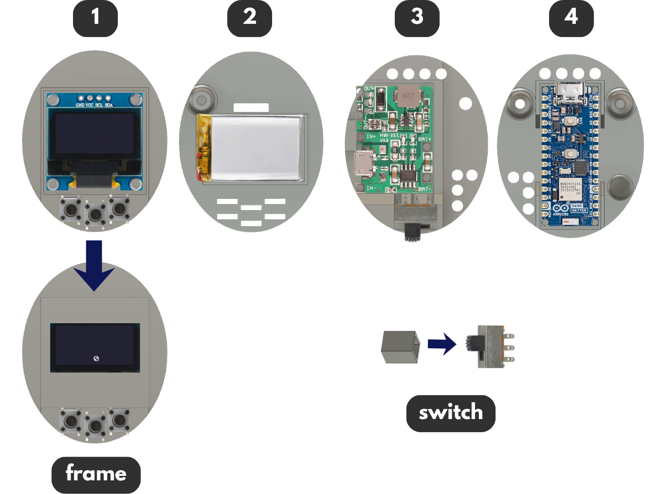

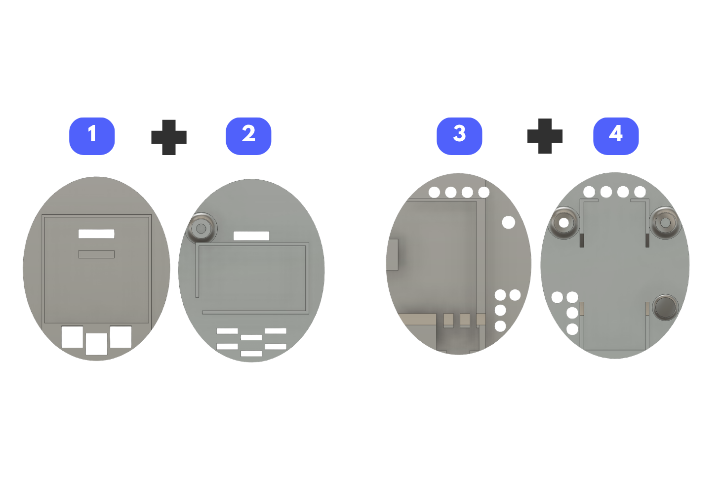

5Step 5: Print and Fit-test Panels, Frame, and Switch Cover

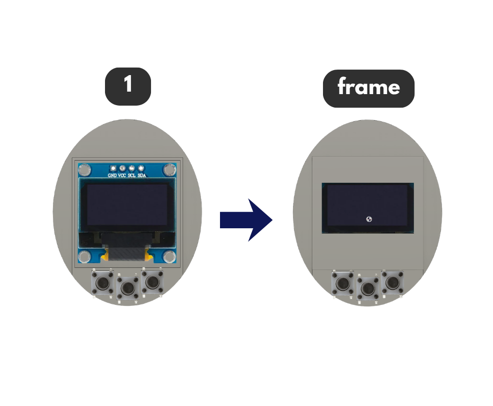

Print the frame, switch cover, and panels 1, 2, 3, and 4.
Make sure your electronics fit in as per the diagram. The frame snaps on top of the OLED once it's on panel 1.
They should more or less friction fit, although it doesn't have to be perfect. If the components you have don't fit, you may need to adjust the 3D file or go crazy with the hot glue.
6Step 6: Glue Panels Together
Superglue the flat backs of panels 1+2 together, and then do panels 3+4. Make sure the holes are aligned!

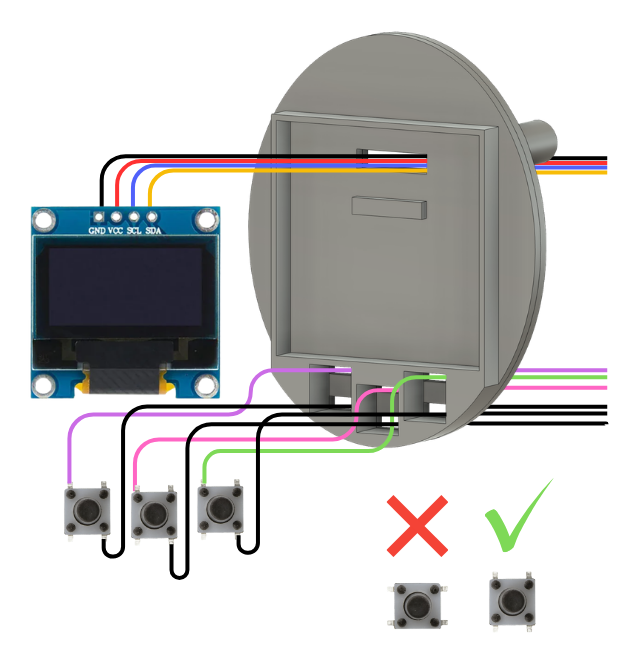

7Step 7: Solder and Thread Panel 1
- Solder wires onto the 4 prongs of the OLED display.
- Solder wires onto the buttons. Make sure they're in the correct orientation!
Thread them through the holes in panels 1/2.

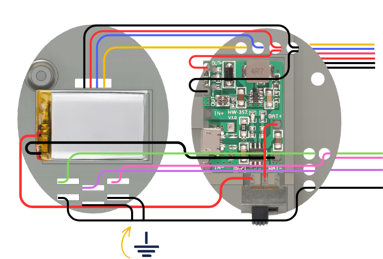

8Step 8: Solder and Thread Panels 2+3

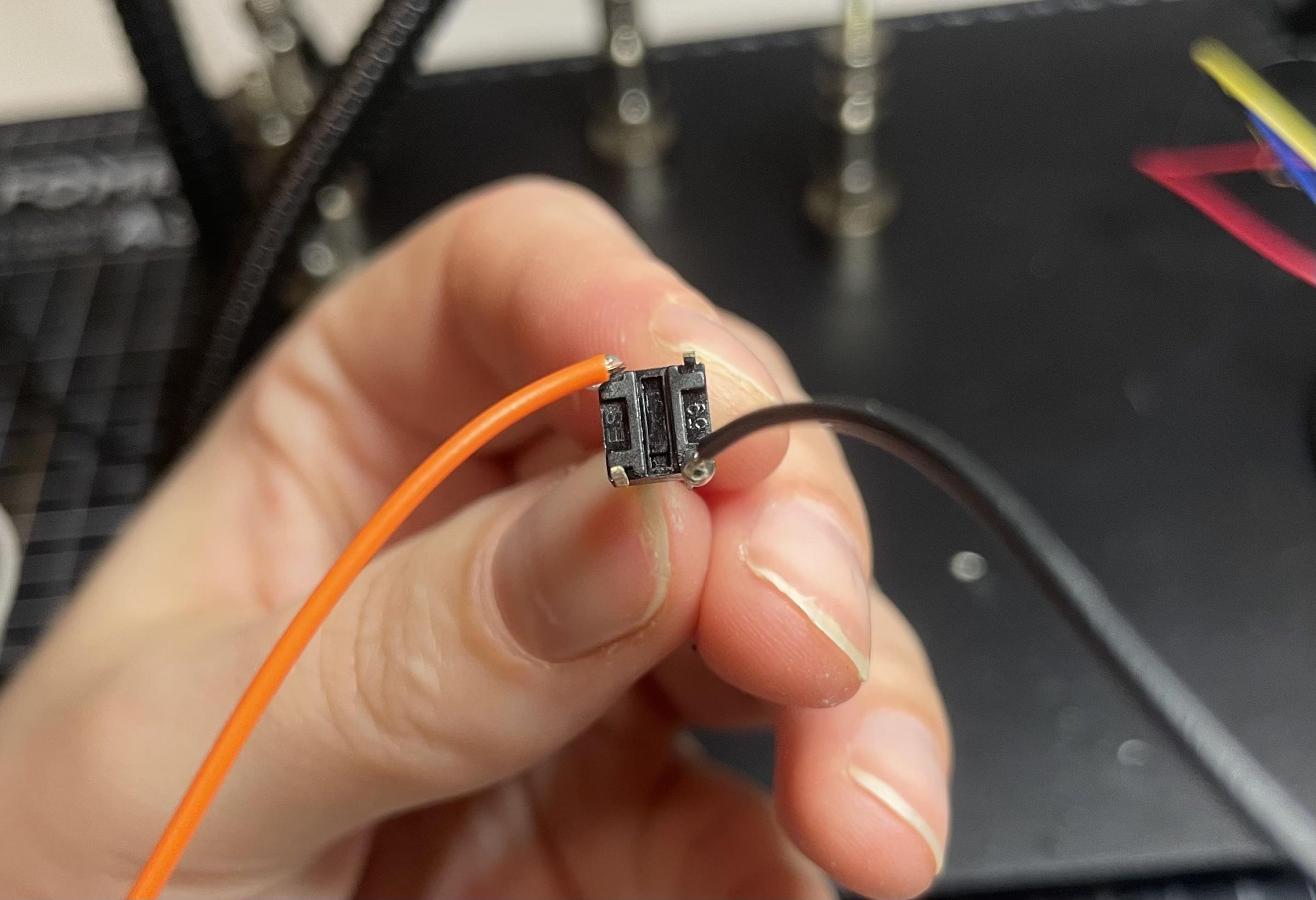

Solder the LiPo battery positive lead (red) to the first prong on the slide switch. Insulate immediately.
- Solder the middle prong of the slide switch to BAT+ on the boost converter. Insulate immediately.
- Solder the LiPo battery negative lead (black) to BAT- on the boost converter. Insulate immediately.
- Solder the ground wires of the buttons together, forming a common ground.
- Solder a positive (red) lead to OUT+ on the boost converter.
- Solder a negative (black) lead to OUT- on the boost converter.
Thread the wires through panel 3, as depicted.
You may want to use hot glue to keep your wires in place and organized.
Safety tip: cut and insulate your LiPo battery leads one at a time!
When soldering the battery leads onto the boost converter, insulate the exposed solder/wire (BAT+, on switch, BAT-) with some hot glue. This will help the system to be safer in the case a wire rips at any point.

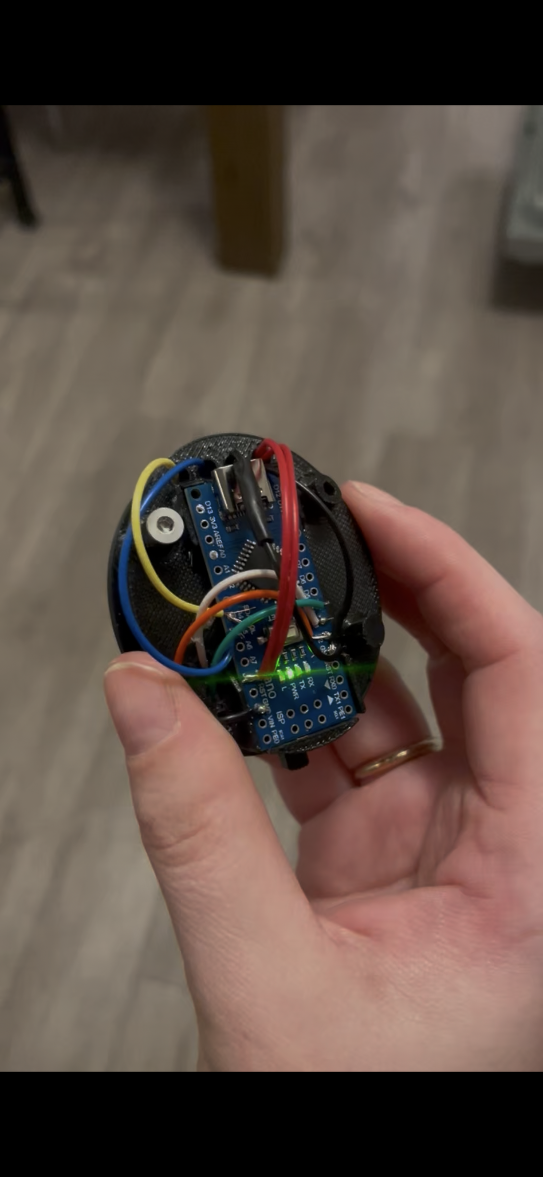

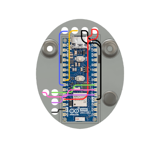

9Step 9: Solder Panel 4
- Solder the positive leads (red) to Nano 5V.
- Solder the negative black (black) to Nano GND.
- Solder the left button lead (purple) to Nano D2.
- Solder the middle button lead (pink) to Nano D3.
- Solder the right button lead (green) to Nano D4.
- Solder the OLED SDA (yellow) to Nano A4.
- Solder the OLED SCL (blue) to Nano A5.

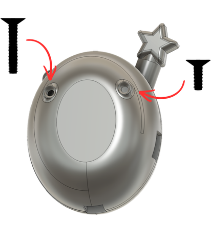

10Step 10: Shell
Print the front and back shell files.
Snap the frame over the OLED. No glue needed!
Snap the switch cover onto the switch. No glue needed!
Then, snap together the front and back shells over your inner chassis.
Screw the shell on. The long screw goes on the left (through the panels), and the short screw goes on the right.
