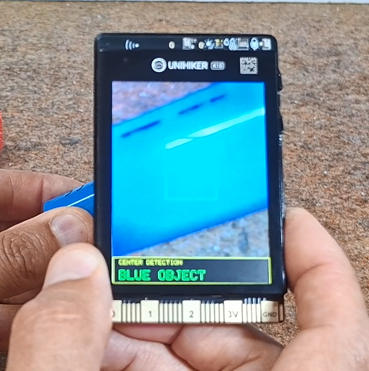

Before developing the final object recognition system, I performed several preliminary experiments. The first experiment was a simple color recognition project. Using the camera image, the software analyzed the dominant color within a selected region of interest and identified basic colors such as red, green, blue, yellow, and others.

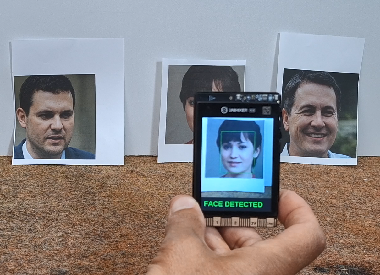

The second experiment used the built-in AI library supplied with the UNIHIKER K10. This demonstrated the ability of the K10 to perform real-time vision tasks using the integrated camera and display. Although these factory AI examples are useful demonstrations, the objective of this project was to create a completely different object recognition method that could be trained directly by the user.
