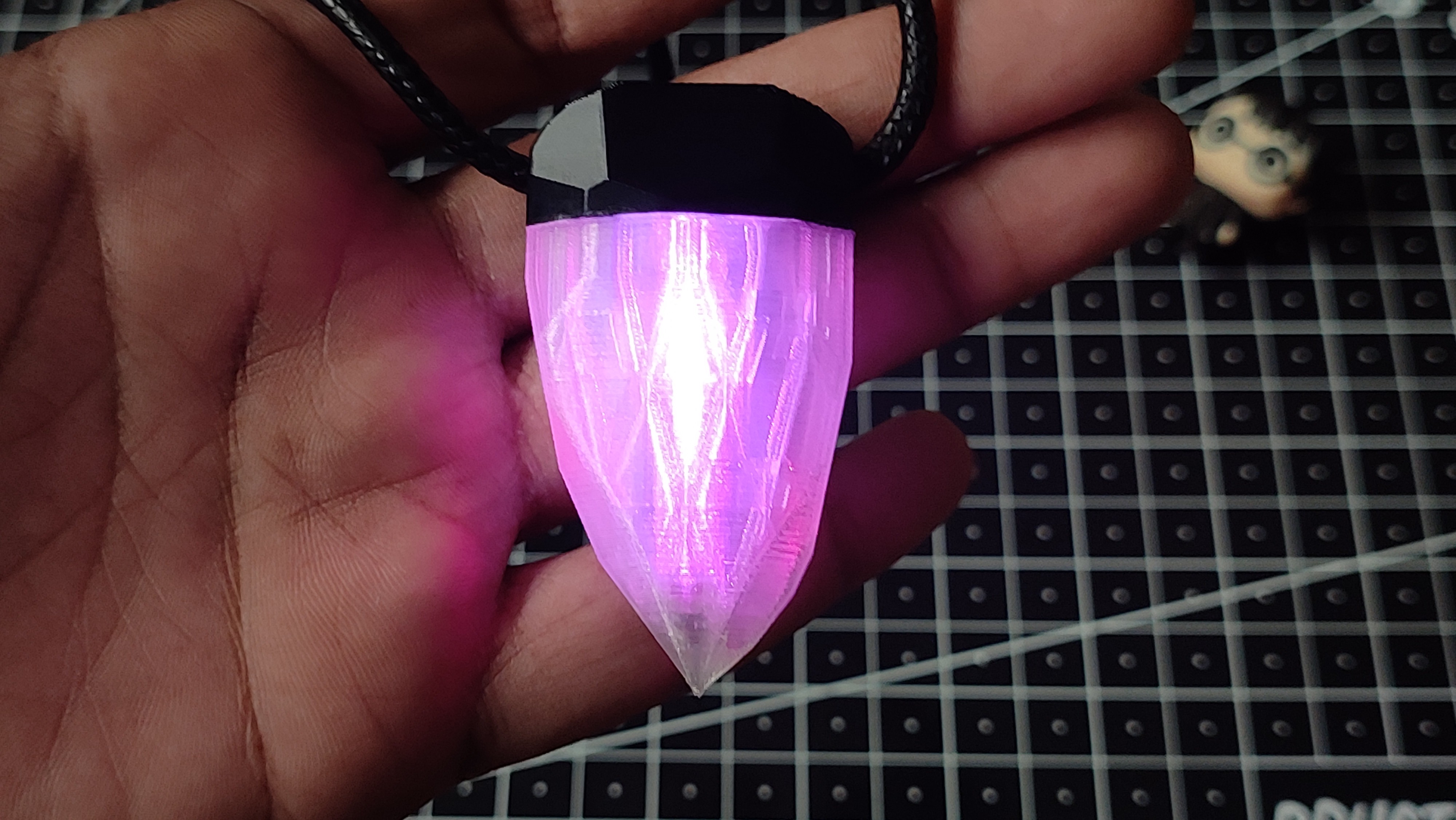

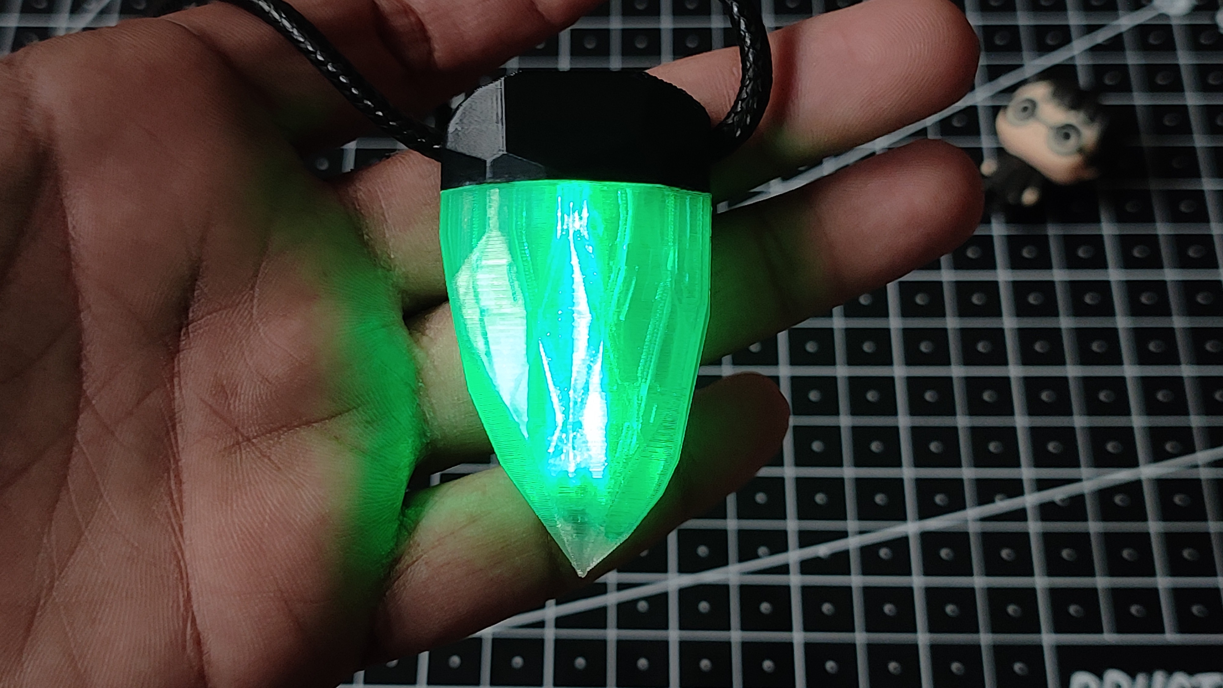

RGB Through Hole LED
RGB through-hole LEDs are available in two different types: Common Anode and Common Cathode. To make this project as beginner-friendly and flexible as possible, I designed the PCB with selectable solder jumpers that support both types of RGB LEDs. This means you don't have to worry about buying a specific version. Simply purchase whichever RGB LED is available in your local market or online store, set the appropriate jumper on the PCB, and you're ready to go. This small feature makes the Aurora Pendant more versatile and ensures that the project can be built easily using commonly available components.
3P Dip Switch
A 3P DIP switch (3-position Dual In-line Package switch) is a simple manual switch that is mounted directly on the PCB. It contains three independent ON/OFF switches, each controlling one channel of the RGB LED. In the Aurora Pendant, each switch controls one color—Red, Green, or Blue. By turning the switches on and off in different combinations, you can create 7 different color combinations (excluding the all-off state). This allows you to easily change the pendant's color without any programming, microcontroller, or mobile app.
