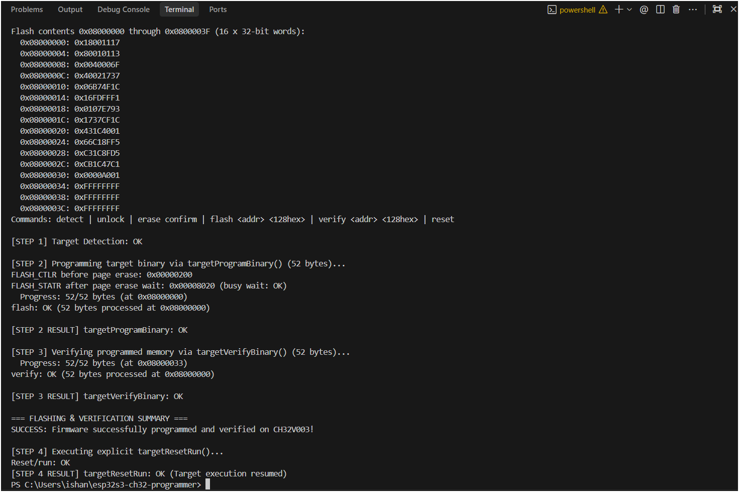

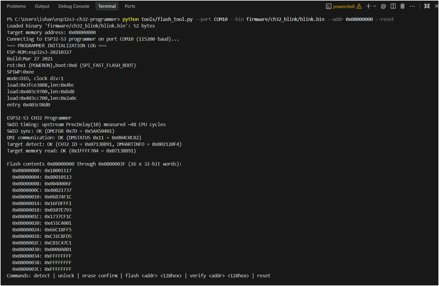

Verification
The programmer has been tested on physical hardware for CH32V003 detection, flash erase/programming, readback verification, and target reset/run.

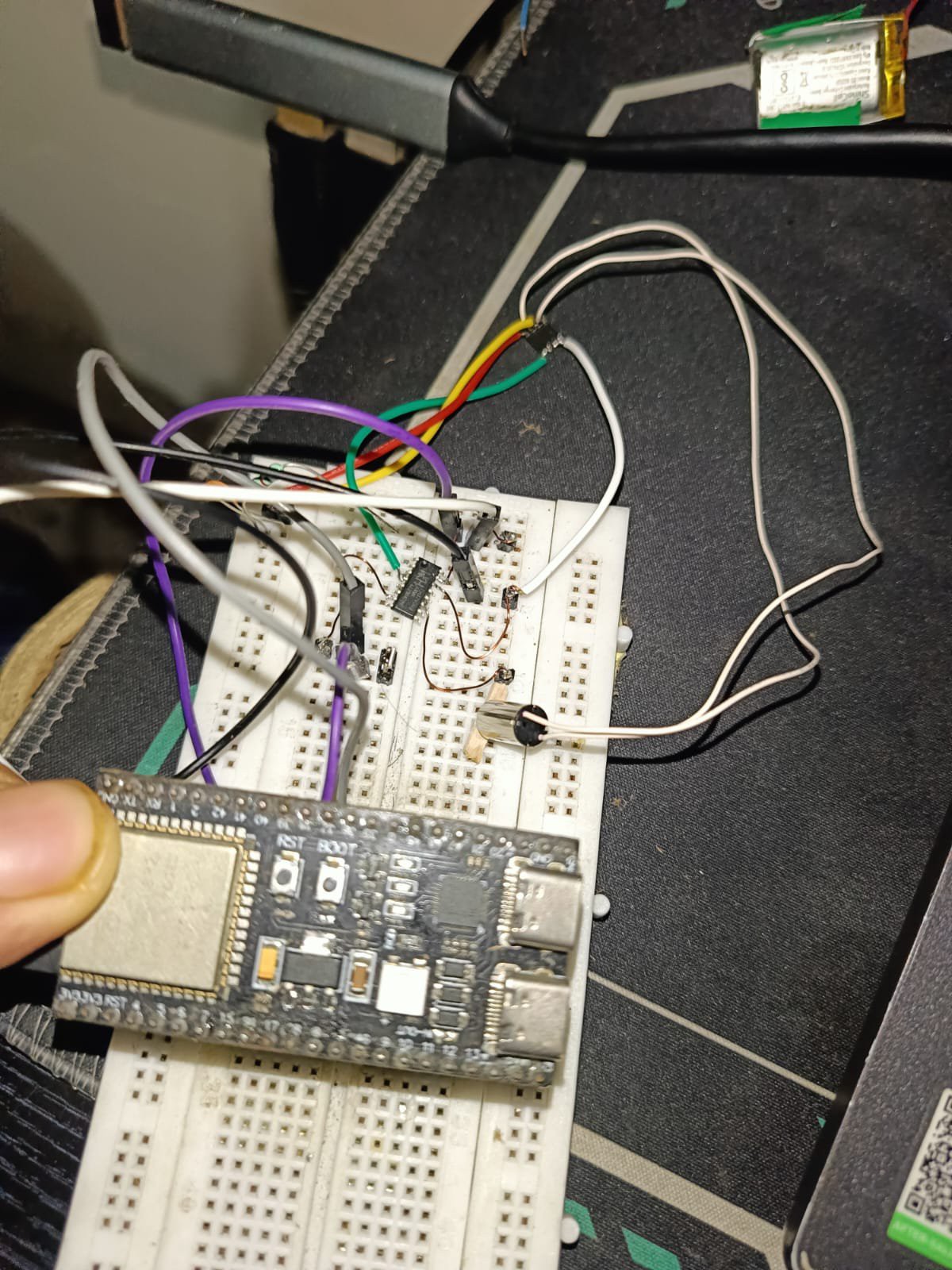

    The initial goal was to program the CH32V003 from a general-purpose ESP32-S3 board.
    The main challenge was getting the single-wire SWIO interface working reliably. After testing the implementation, I was able to communicate with the CH32V003 and complete the programming flow on physical hardware.
    The current implementation can detect the target, erase/program flash, verify the programmed data by readback, and reset the target.
    The project is still ongoing. Future work includes improving signal-integrity validation, testing different wiring lengths and GPIO timing configurations, and expanding compatibility.

    Hardware
    You need:
    - ESP32-S3 development board
    - CH32V003A4M6 target MCU
    - 4.7kΩ–10kΩ pull-up resistor
    - USB cable
    - 3.3V logic supply
    - Common GND
  • 2
    SWIO wiring
    ESP32-S3 GPIO10 → CH32V003 PD1/SWIO (Pin 7)
    ESP32-S3 3.3V → CH32V003 VDD (Pin 15)
    ESP32-S3 GND → CH32V003 VSS (Pin 14)
    Place a 4.7kΩ–10kΩ pull-up resistor between SWIO and 3.3V.

    Build the programmer
    Open the programmer firmware directory:
    cd firmware/programmer
    Build with PlatformIO:
    pio run
    Upload to the ESP32-S3:
    pio run -t upload
View all 6 instructions
