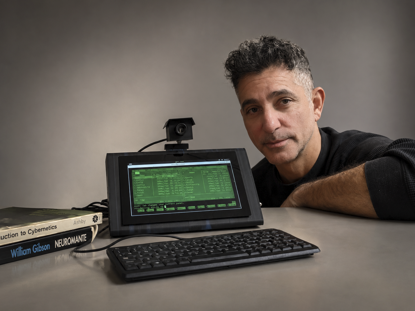

While drawing inspiration for Microcifra 26 from the distinctive aesthetics of vintage workstations, I wanted to move beyond a simple 3D-modeling exercise. My goal was to build a fully functional, tangible device packed with features missing from off-the-shelf computers—unconventional additions designed to spark conversation at tech conferences and maker spaces. To achieve this, I integrated a motorized miniature CCTV camera for dynamic visual capture, alongside a rear-facing LED matrix paired with a piezoceramic buzzer to scroll real-time status messages and sound classic 8-bit alerts to passersby.
Hardware
Microcifra 26 is built around a LattePanda IOTA, featuring an Intel N150 processor, 16 GB of RAM, and an RP2040 coprocessor. The 7-inch display connects through an EDP ribbon cable. Audio is routed through a 3-watt micro amplifier to a side-mounted speaker. The system also includes a buzzer for generating beeps, a USB camera with a microphone mounted on a servo, a UPS module with three 18650 batteries, an 8×8 LED matrix on the back, a potentiometer, and a toggle switch.

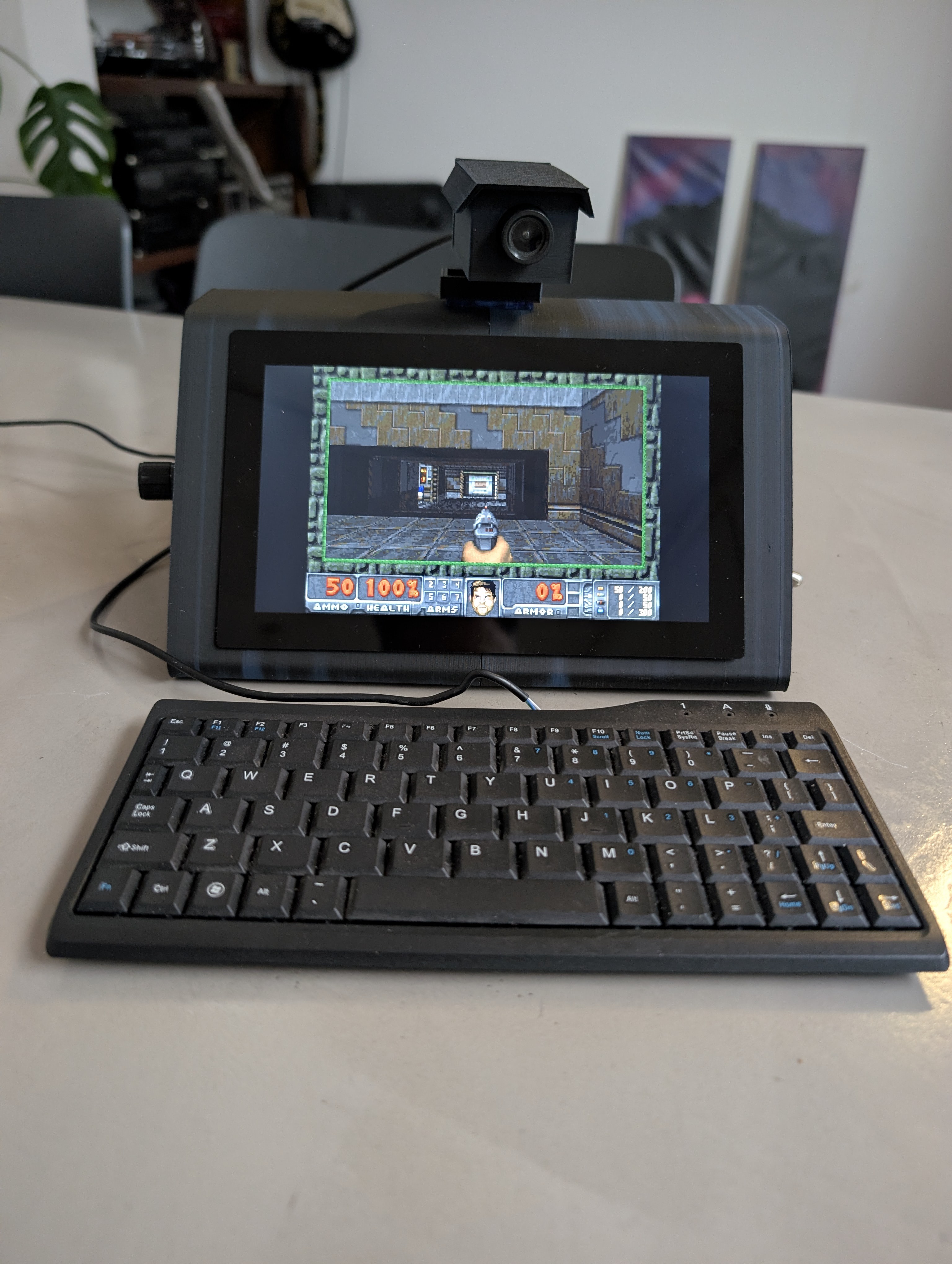

For downtime, Microcifra 26 also runs MAME with Commando. I'm currently finishing a joystick that connects directly to the RP2040 through GPIO.

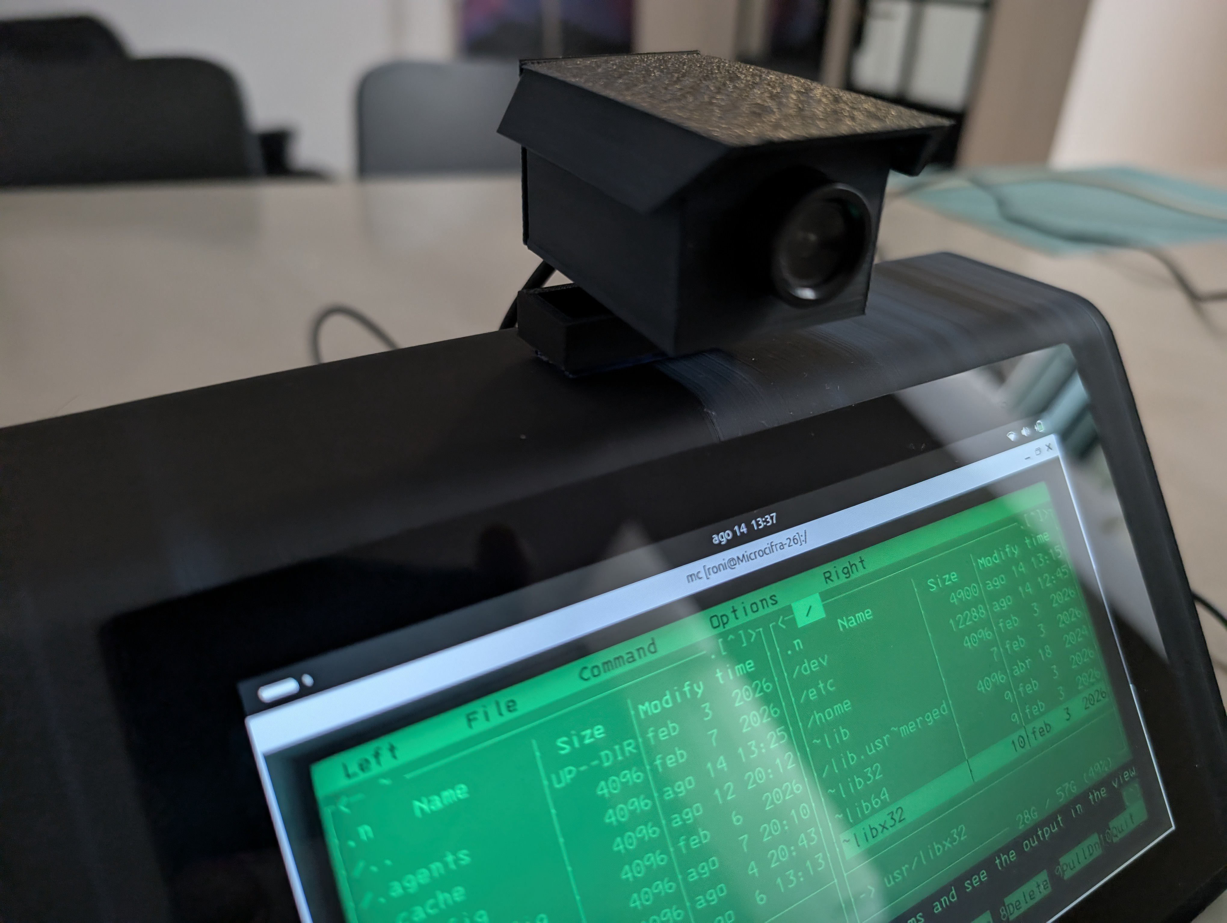

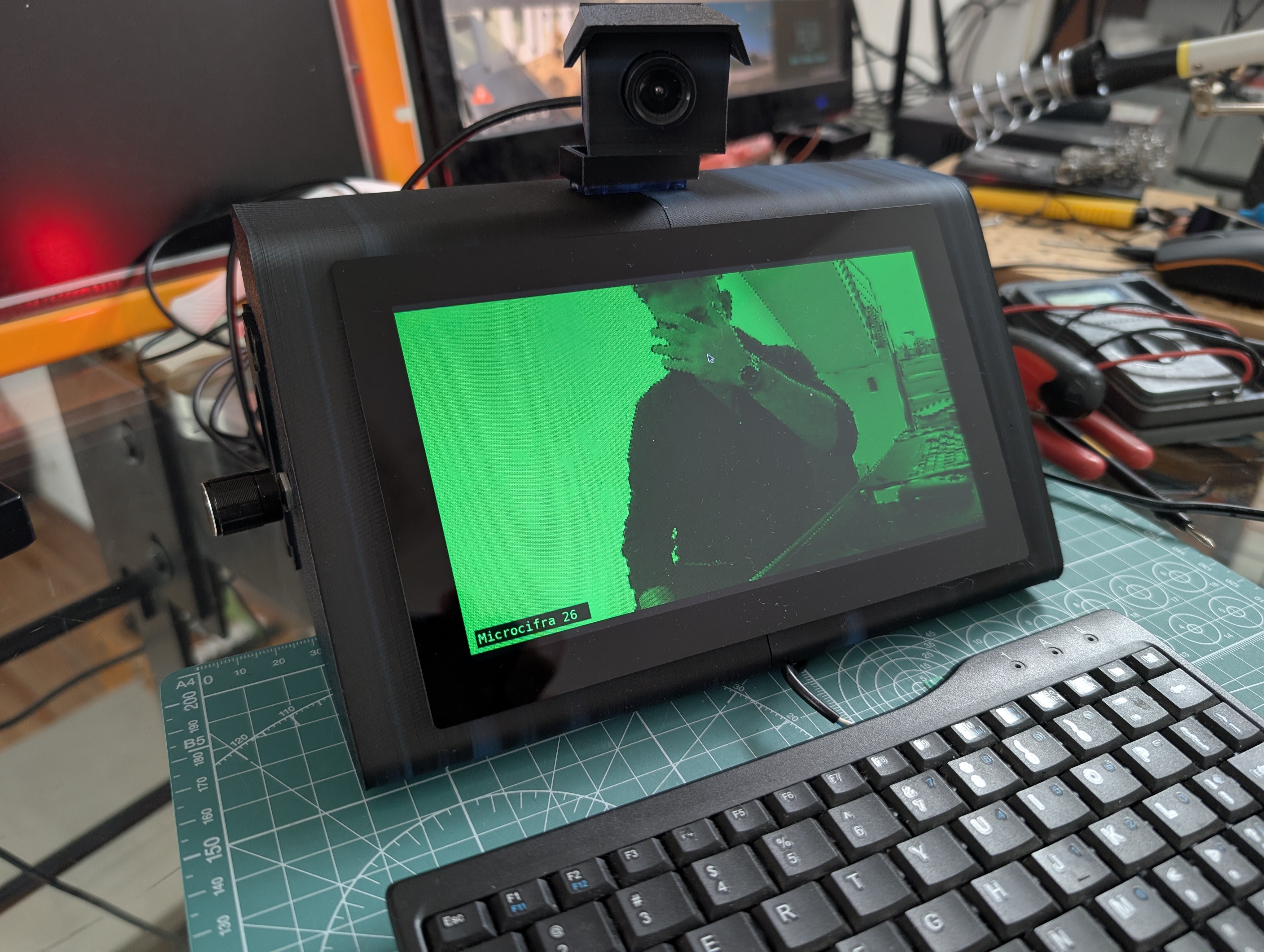

Microcifra 26 has a side-mounted toggle switch that activates surveillance mode. In this mode, the servo-mounted camera automatically pans across the environment, taking pictures at 0, 90, and 180 degrees. The captured images are then converted to shades of green to resemble a 1970s CCTV monitor.
The screen aesthetics was inspired by IBM 3270 and it is made by using cool-retro-term + a PIL image conversion for the snapshots.
The camera turret can also be controlled manually using the potentiometer. This makes it possible to point the camera at a specific location and send a manual command to take a picture—or let an AI agent control the panning and image capture. The camera has a mic so audio can be captured as well.

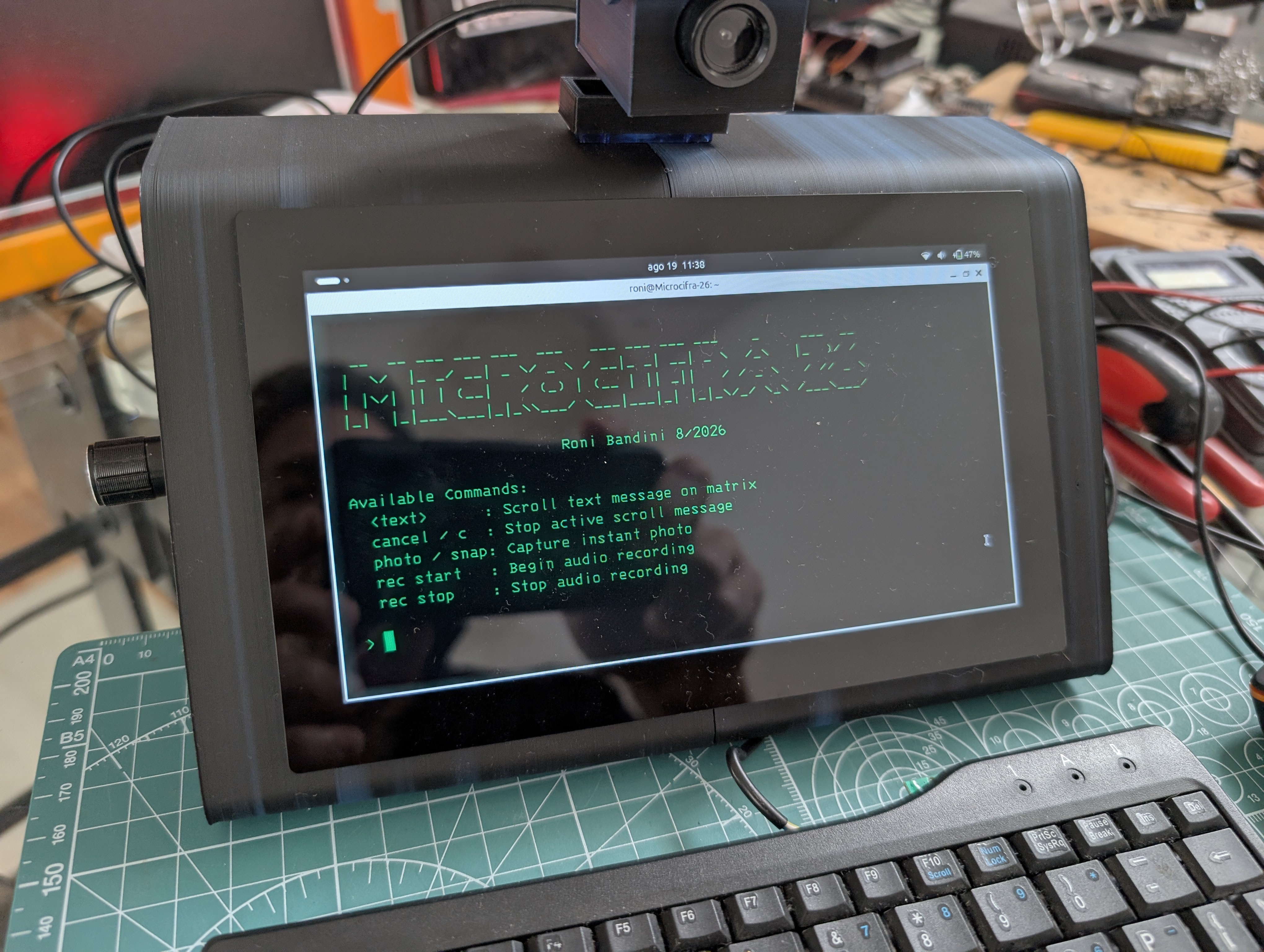

On boot, the rear LED matrix runs an animated bar chart initialization sequence. Custom text payloads can be dispatched directly to the display via a CLI application; as messages scroll across the panel, the piezoceramic buzzer fires short, mechanical-sounding clicks to draw immediate attention from passersby.
OpenClaw can also use the LED Matrix through a script
print("Use: python3 send_msg.py \"Text\"")

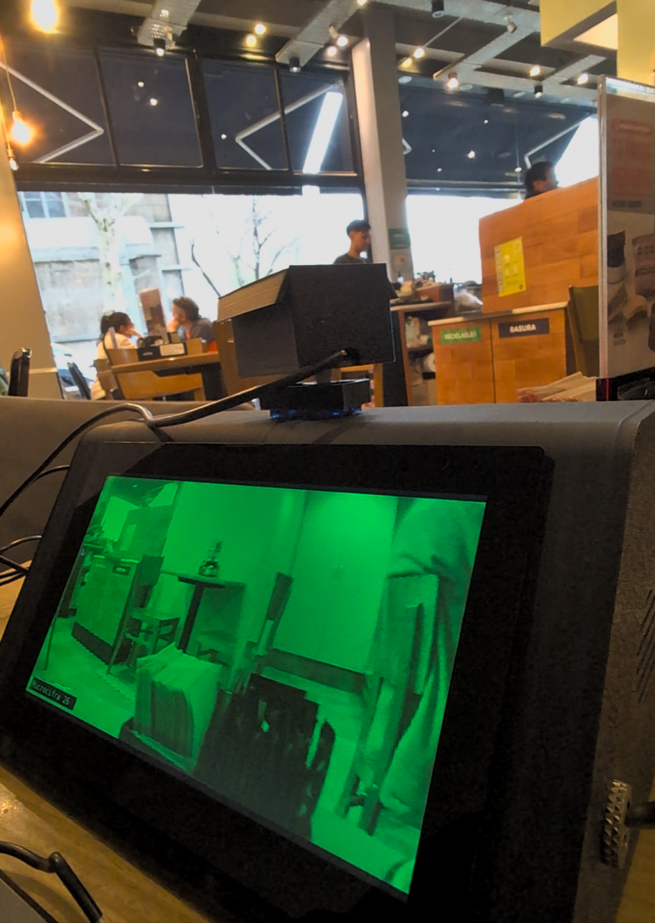

As soon as the build was complete, I took it straight to a crowded café for the ultimate field test. Transporting the unit proved somewhat cumbersome due to its angular, triangular form factor, and the battery setup—powered by a 3x 18650 cell pack—drained faster than anticipated under the combined load of the display, LED matrix, audio amplifier, servo motor, and active peripherals. The compact keyboard also demanded some adjustment for comfortable typing.
However, the hardware delivered exactly as intended: it immediately turned heads, sparked curiosity, and had people leaning in to read the scrolling LED matrix messages and ask questions.
