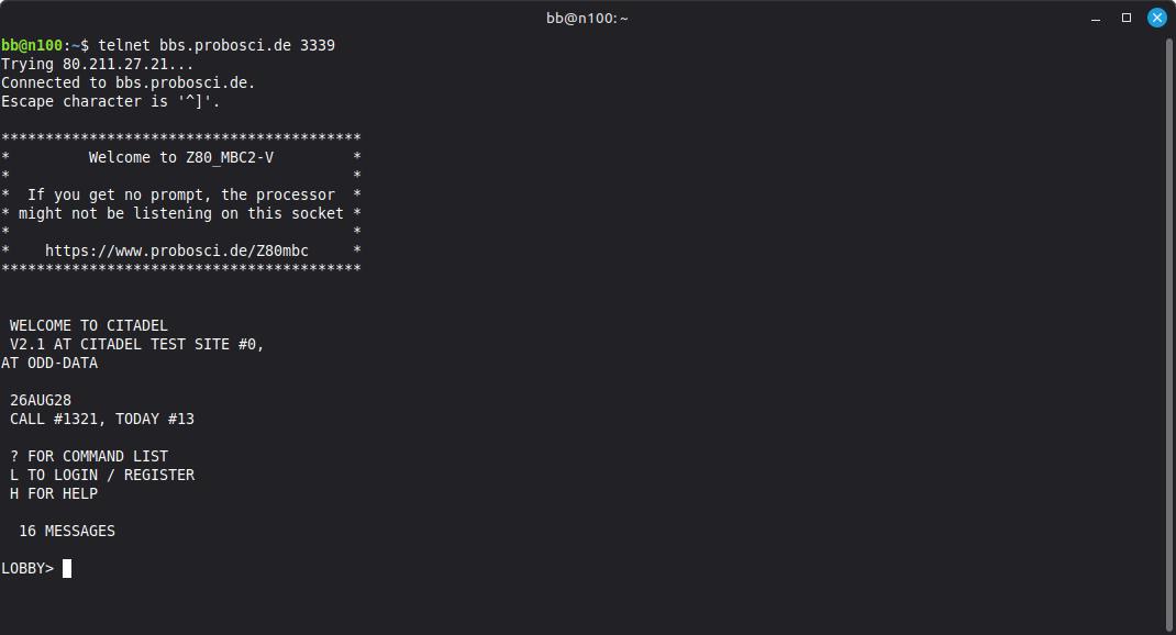

The first Z80-MBC2-V board assembled is currently running "Citadel" v2.1 under CP/M 3.0.
You can connect to the board via Telnet at address bbs.probosci.de on port 3339,
or by using this web wrapper: http://probosci.de/bbs.html
You may then Login/Register with command 'L' or read the Help with command 'H'.

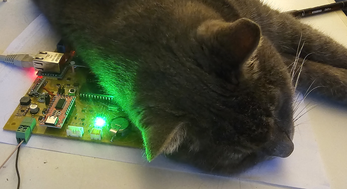

The board (first version with a patch on the PSU, fixed in final version) running Citadel v2.1

Assembly note:
The glue logic and level shifters for the Ethernet and SD card interfaces are difficult to source in traditional through-hole packages. For this reason, compared to the original project, assembling this board requires a certain (small) degree of surface mount skill.
The same applies to the power supply, but this is optional - you can power the board using just the USB cable.
