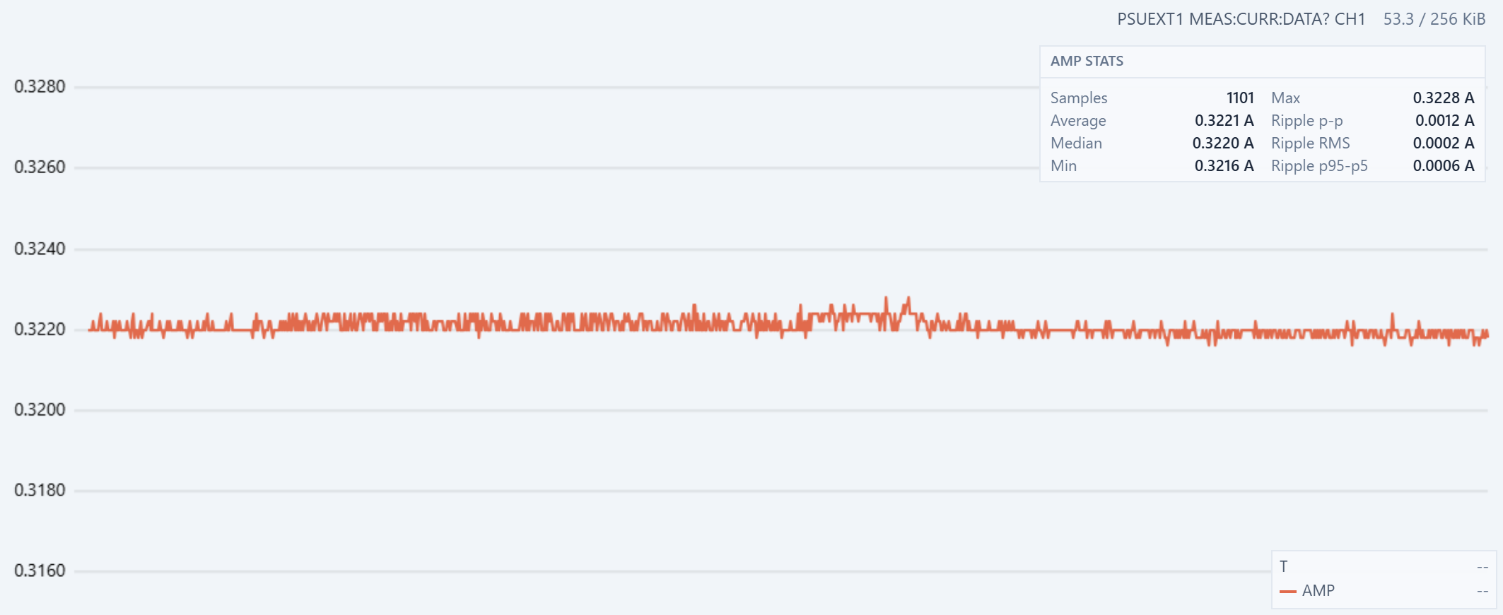

HOLD TWO 1
The
HOLD TWO 1
command activates IN1 and IN2, energizing two adjacent motor windings while the shaft remains stationary.
Figure 3. PSU-EXT current measurement during HOLD TWO 1. The average is 0.3221 A, the minimum is 0.3216 A, and the maximum is 0.3228 A.
The two-coil average is 0.1515 A higher than the 0.1706 A measured during HOLD ONE 1, an increase of about 88.8%. It is close to, but not exactly, twice the one-coil current. Shared wiring and return-path resistance, driver voltage drops, and small differences between windings and ULN2003 channels can all reduce the current from the ideal doubled value.
The trace is stable around 0.322 A. Its total recorded span is only 1.2 mA, or about 0.37% of the average. This level also agrees with the upper current plateau observed when the running half-step sequence energizes two coils.

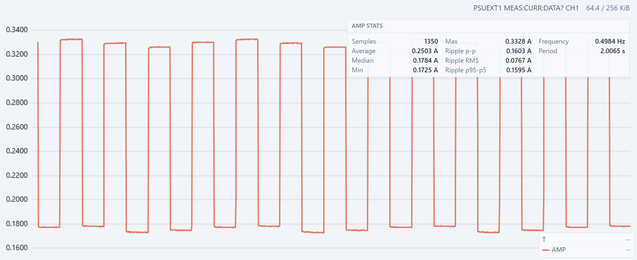

RUN LEFT 1
Figure 4. Current during RUN LEFT 1. PSU-EXT reports a minimum of 0.1725 A, a maximum of 0.3328 A, an average of 0.2503 A, and a waveform frequency of 0.4984 Hz.
At one half-step per second, each state lasts for one second. The half-step sequence alternates between one energized coil and two energized coils. The current therefore alternates between approximately 0.175 A and 0.330 A. The same coil-count state returns every two steps, giving an expected current-magnitude period of two seconds, or 0.5 Hz. The measured 0.4984 Hz agrees with this sequence timing.
The high and low plateaus vary slightly as the sketch moves through the four windings and ULN2003 channels. This is consistent with the small channel differences observed in the hold tests. The average is also close to the midpoint between the one-coil and two-coil levels because both states have the same duration.

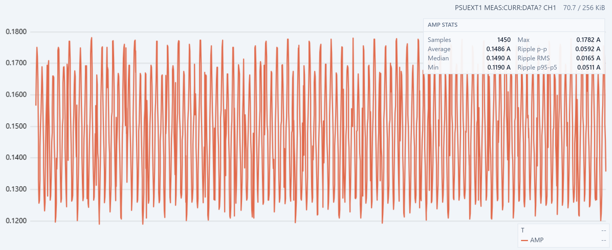

RUN LEFT 1200
Figure 5. Sampled current during RUN LEFT 1200.
At 1200 half-steps per second, each state lasts about 833 µs. The sequence still alternates between one-coil and two-coil states, so its current-magnitude component is expected at 600 Hz. The complete eight-state electrical sequence repeats at 150 Hz. These changes are much faster than the plotted samples (100 Hz) can resolve.
The sample points are distributed evenly across the captured current range, and the sampled pattern repeats with consistent spacing. This shows that the acquisition is observing a stable periodic process and is not dominated by a few isolated spikes. However, the connected points represent samples taken at different phases of the switching cycle. The apparent cycles are a sampled pattern, not a complete reconstruction of the underlying 600 Hz current waveform or its true cycle time.
The reported average is about 0.15 A, compared with 0.2503 A at one half-step per second, a reduction of about 40%. The motor windings are inductive, so their current cannot reach the steady one-coil or two-coil level during an 833 µs state. Back electromotive force from a rotating motor can reduce it further. However, this current trace alone does not prove that the rotor remained synchronized with the commanded 1200 half-steps per second

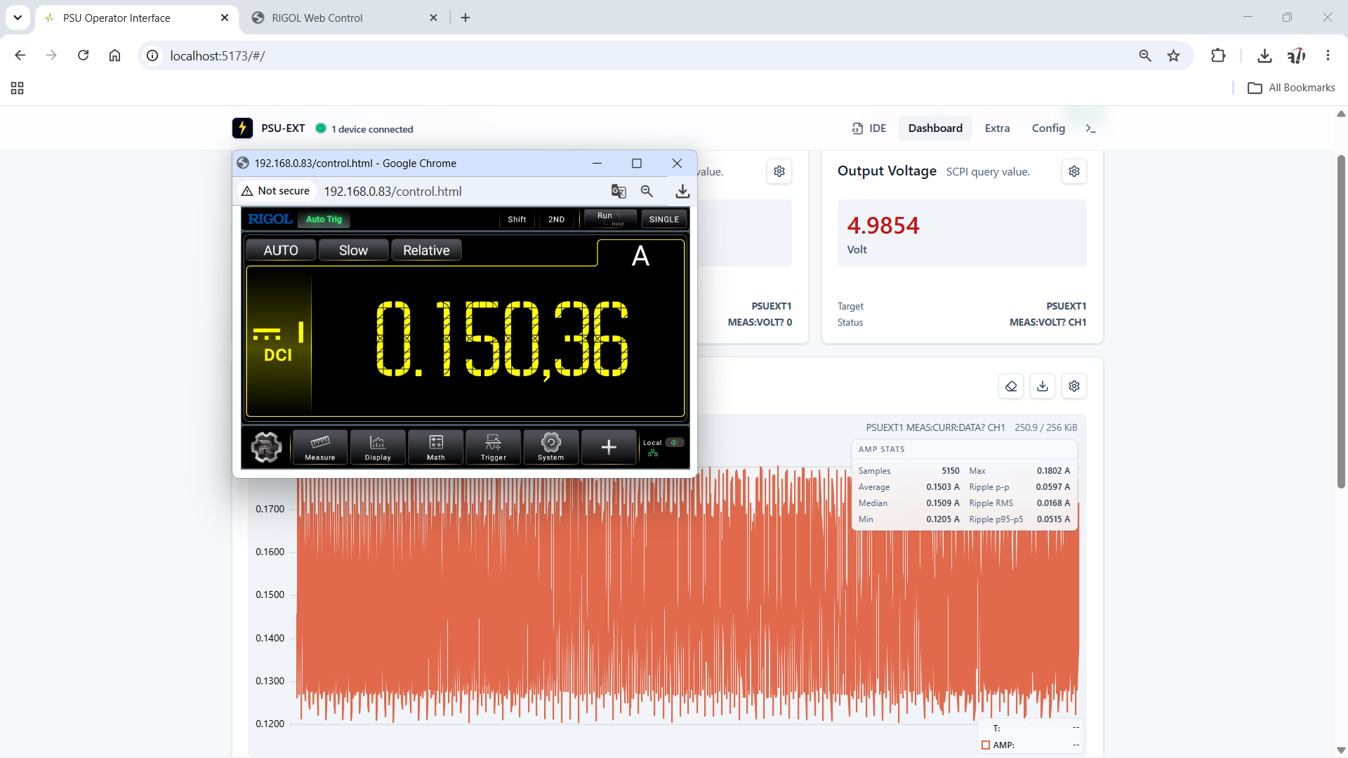

Figure 6. Independent current comparison during RUN LEFT 1200. PSU-EXT reports a 0.1503 A average over 5150 samples, while the Rigol DM858E reads 0.15036 A.
The displayed values differ by 0.00006 A, or 0.06 mA, which is about 0.04%. This close agreement shows why the limited waveform resolution does not make the measurement useless. The samples cover many switching cycles and are distributed across different phases rather than concentrated around one part of the cycle. They therefore produce a representative average even though they do not reconstruct each current pulse.
The independent DM858E result supports using the PSU-EXT capture to compare operating modes, estimate average power, observe thermal drift, and detect larger changes in operating state.

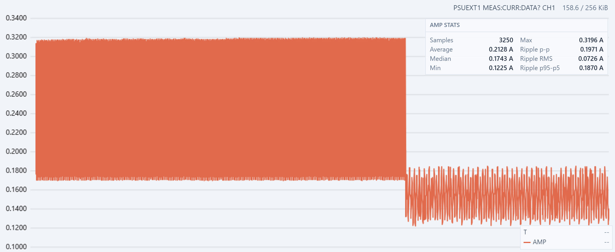

Transition From RUN LEFT 50 to RUN LEFT 1200
Figure 7. Current-envelope change when the command switches from RUN LEFT 50 to RUN LEFT 1200.
At 50 half-steps per second, each drive state lasts 20 ms. This gives the energized winding current time to approach the one-coil and two-coil levels seen in the slower tests. The left side of Figure 7 spans approximately 0.169 A to 0.320 A, an envelope width of about 0.151 A.
The command then changes directly to 1200 half-steps per second. Each state is now about 833 µs, which is 24 times shorter. The current envelope drops immediately to approximately 0.123 A to 0.184 A. Its midpoint falls by about 37%, and its width contracts from about 0.151 A to 0.061 A.
Winding inductance limits how quickly current can rise. At 1200 half-steps per second, the drive moves to the next state before the active winding currents can approach their steady values. If the rotor accelerates with the command, the higher back electromotive force also opposes the applied voltage and reduces current. These effects lower both edges of the envelope and reduce the difference between the one-coil and two-coil states.
The sharp boundary shows that the electrical load responds immediately to the speed command. After the transition, the lower current envelope remains stable, with no visible long settling period.

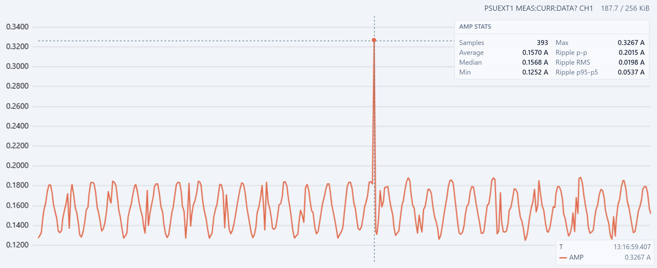

Full-Speed Direction Reversal
Figure 8. Current during an immediate change from RUN LEFT 1200 to RUN RIGHT 1200. The reversal produces a measured peak of 0.3267 A.
The current envelopes before and after the command are similar. Direction alone therefore has little effect on the steady high-speed current in this test. The capture average is 0.1570 A, while the reversal reaches 0.3267 A. The transient is about 2.1 times the average current and approaches the two-coil current seen at low speed.
The electrical sequence reverses immediately, but the rotor and gearbox cannot reverse their motion instantly. Rotor inertia keeps the motor moving in the original direction while the reversed magnetic field applies braking torque. During this brief braking and re-acceleration interval, the relationship between winding current, rotor position, and back electromotive force changes sharply. The resulting transient allows the supply current to rise well above the normal 1200-half-step-per-second envelope.
This is a reason to avoid an immediate direction change in normal motion control. A controlled profile should decelerate the motor, reverse at or near zero speed, and then accelerate in the opposite direction. That reduces current transients, mechanical shock, and the risk of losing steps.
