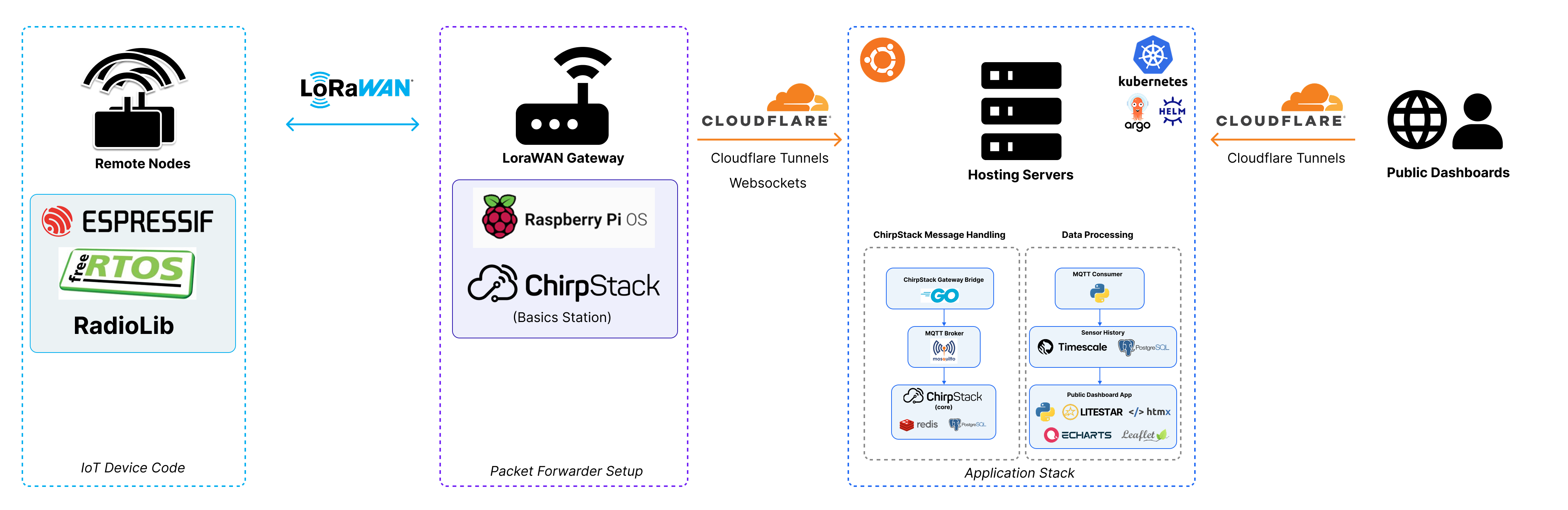

To equip our ESP32-S3 with lora we can use the SX1262 lora hat and the Radiolib library (https://github.com/jgromes/RadioLib). After processing the audio data we produce an custom 11 byte message with the decibel (dBFS) measurements at four different frequency ranges. The message is in the format: version | type | length | band 0 | band 1 | band 2 | band 3 |.
Gateway + Chirpstack

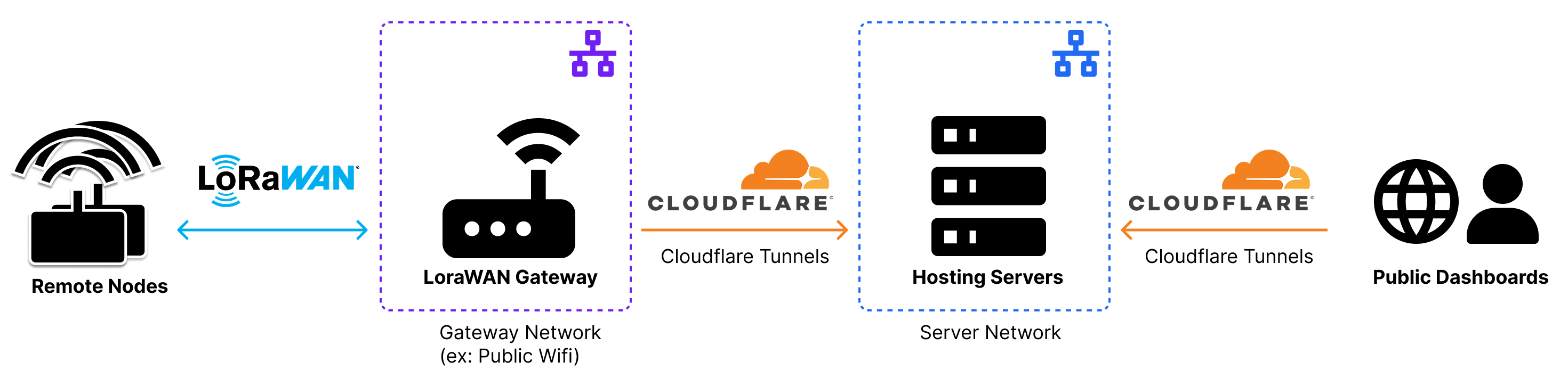

Chirpstack is another awesome open source project that makes all of this cross-device communication possible. It helps facilitate receiving the messages, forwarding them to the server, and decoding the message. It runs on both the LoraWAN gateway and my server. I even made a custom helm chart for Chirpstack so I can manage it more easily through ArgoCD.
For the gateway hardware I ended using my raspberry pi 4B with a LR1302 LoRaWAN Gateway hat, which has some pretty good docs on Elecrow's site - https://www.elecrow.com/wiki/lr1302-lorawan-gateway-module.html
To run the gateway completely remotely I used a Soracom Onyx Cellular USB modem with a 1nce SIM card. This also assumes that you have a public endpoint that you can with your Chirpstack gateway, which I setup on my homelab. Since Chirpstack basicstation communicates over Websockets, Cloudflare tunnels will work. Note that the UDP packet forwarder in the Elecrow docs will not work because they communicate over layer 4, while cloudflare tunnels work best with...
