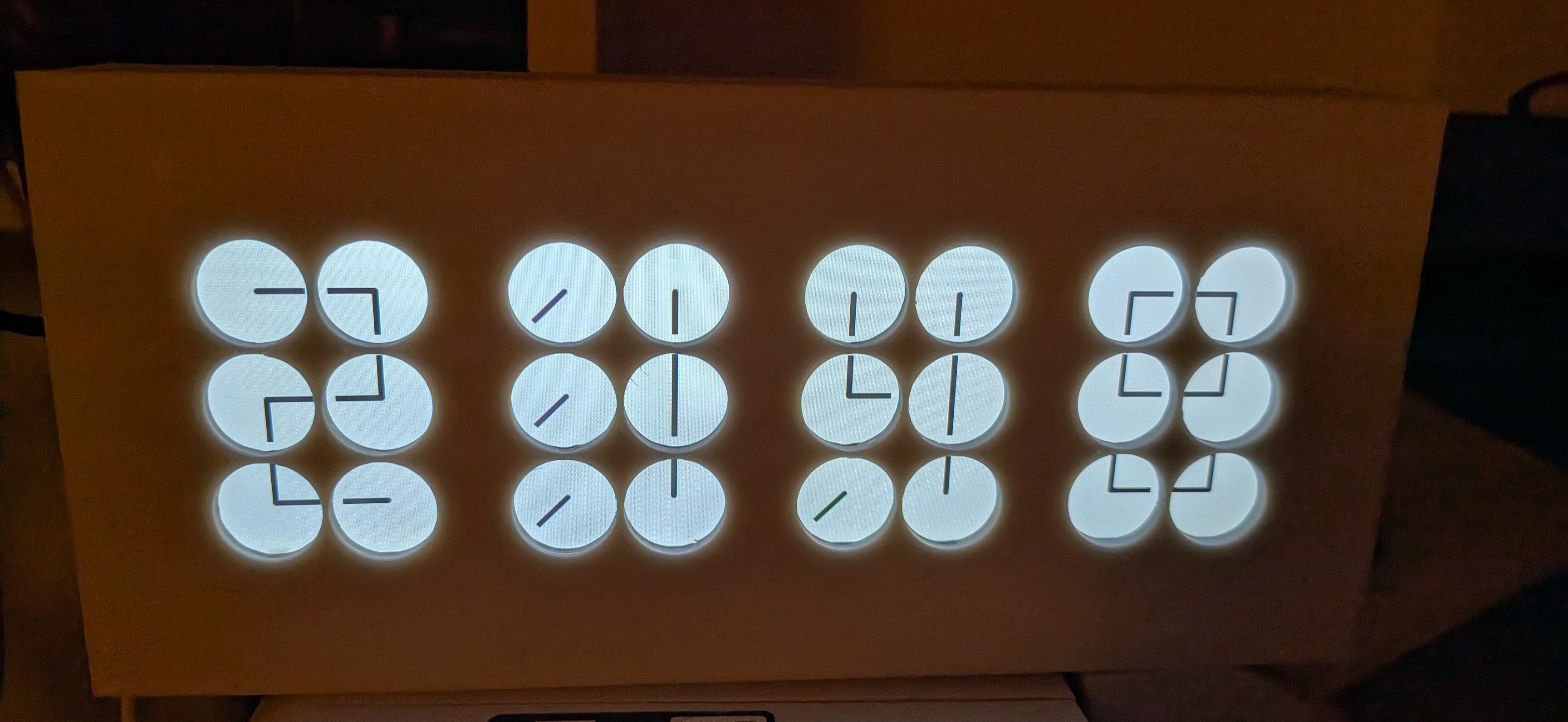

Twenty-four little analogue clocks, telling the time as one digital one. The hands sweep into position to form the digits, hold them for a minute, then break formation and do something else entirely before sweeping back.
The finished 24-screen wall running

ClockClock 24 by Humans since 1982 is a beautiful piece of kinetic art and well out of my budget. This is the same idea for about €210: twenty-four 1.28″ round LCD panels, eight XIAO ESP32-S3 boards, one custom carrier PCB and ESPHome. It finishes at 27 × 13 cm, 730 g and hangs on two screws.

That is the illusion the original depends on, and it falls apart. So: one round panel per clock, evenly spaced across all twenty-four, the same distance right and down between every pair of faces.
Twenty-four round panels in a printed case, mid-test
All twenty-four panels mounted in the printed case, mid-bring-up with four of the eight columns driven. The case is one printed part with twenty-four round cutouts; the panels sit behind it so only the round glass shows.
