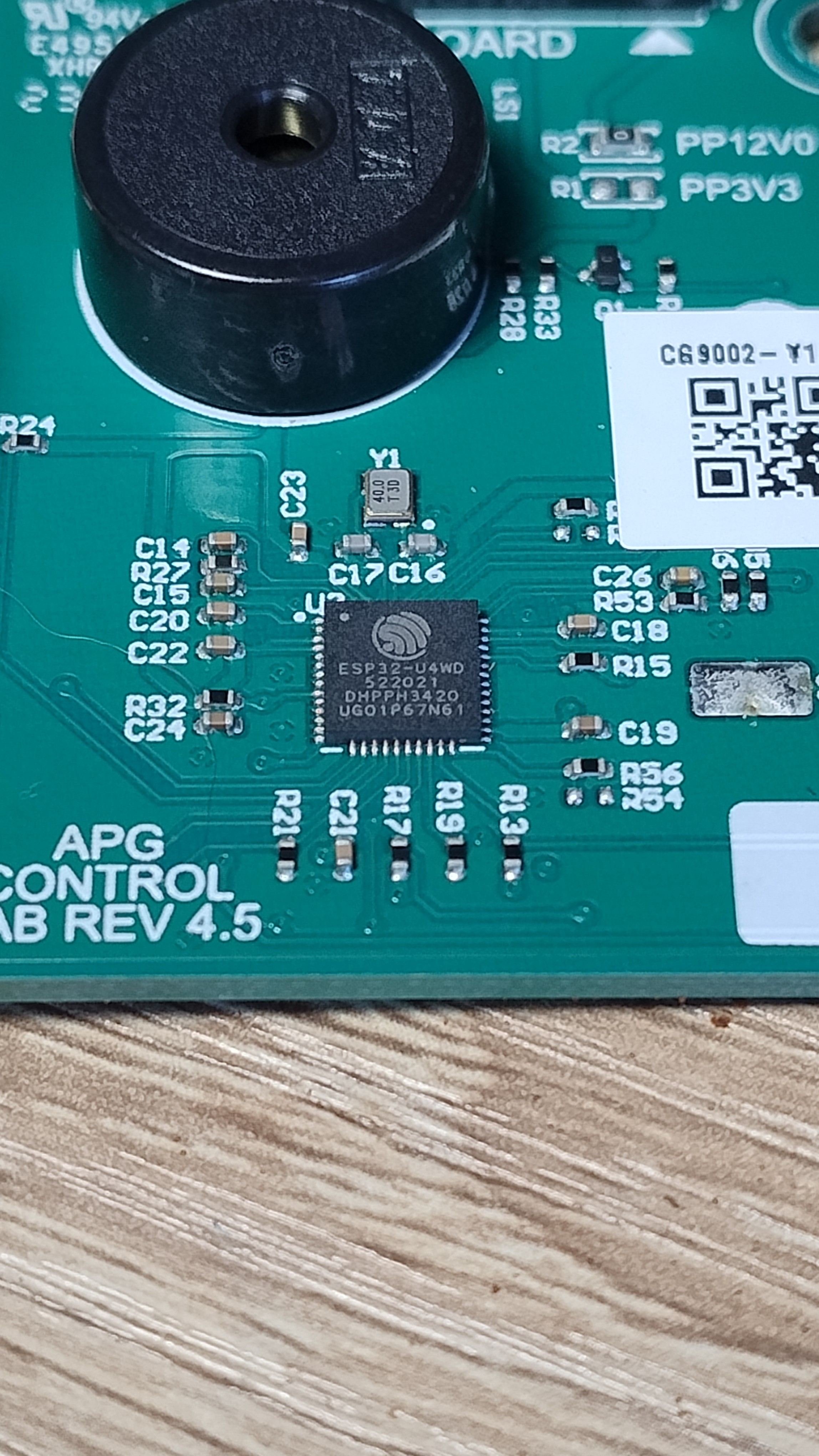

A control board with an ESP32-U4WDH on it! That meant I could write my own firmware and add interesting and useful (or just interesting) features – let’s say talking to Home Assistant, or remote control over a web socket. Maybe I could collect grinding statistics, or something else entirely. To be clear: even though the chip does Wi-Fi and BT, the grinder has no “smart” features and no app. In my eyes that’s one of its advantages. But if I can add those features on my own terms - that changes things. What encouraged me further were neat and big service pads labeled PROG. Once again I wanted to hug someone at Fellow and congratulate them on building something repairable, reusable and open to modification.

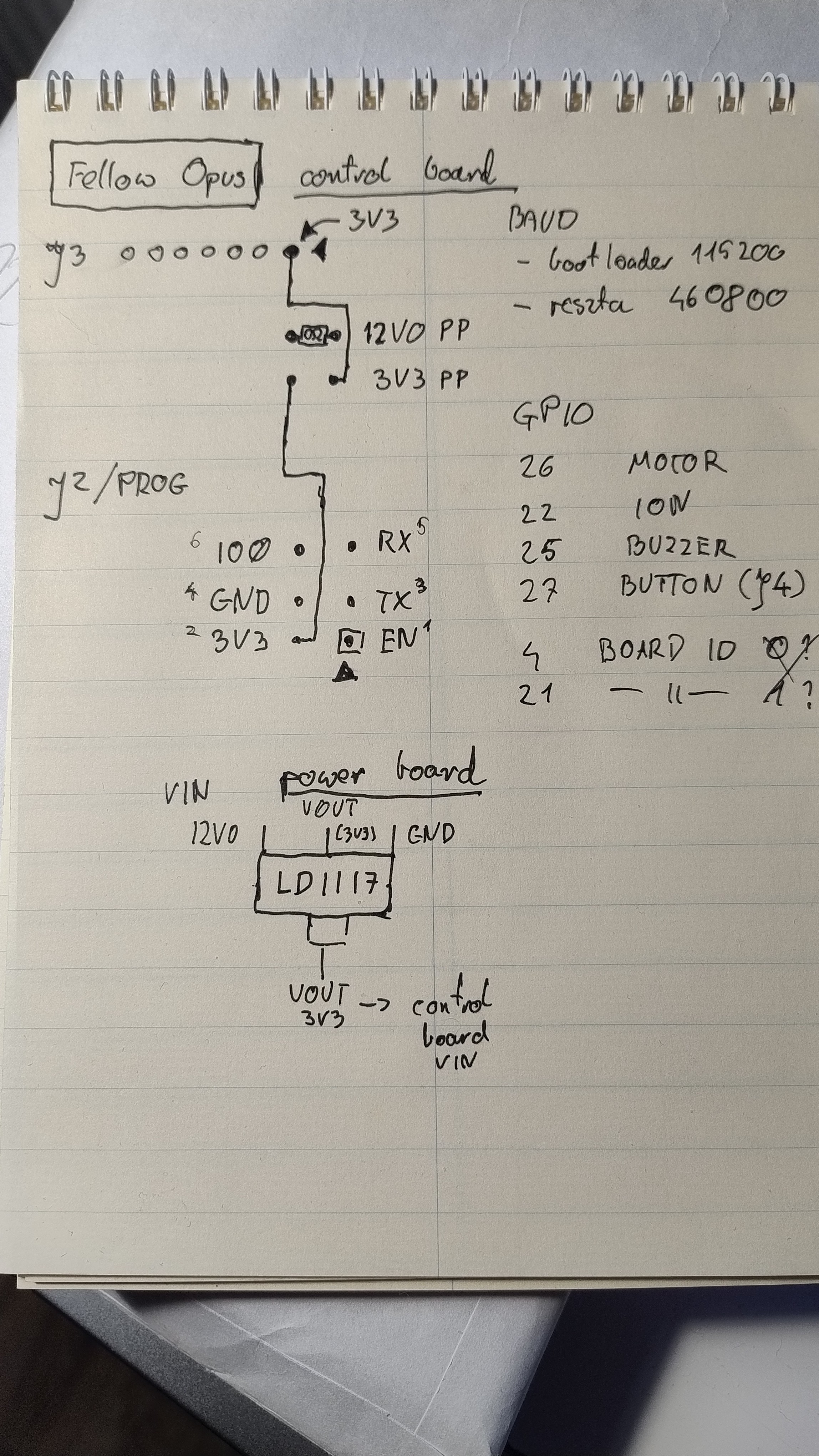

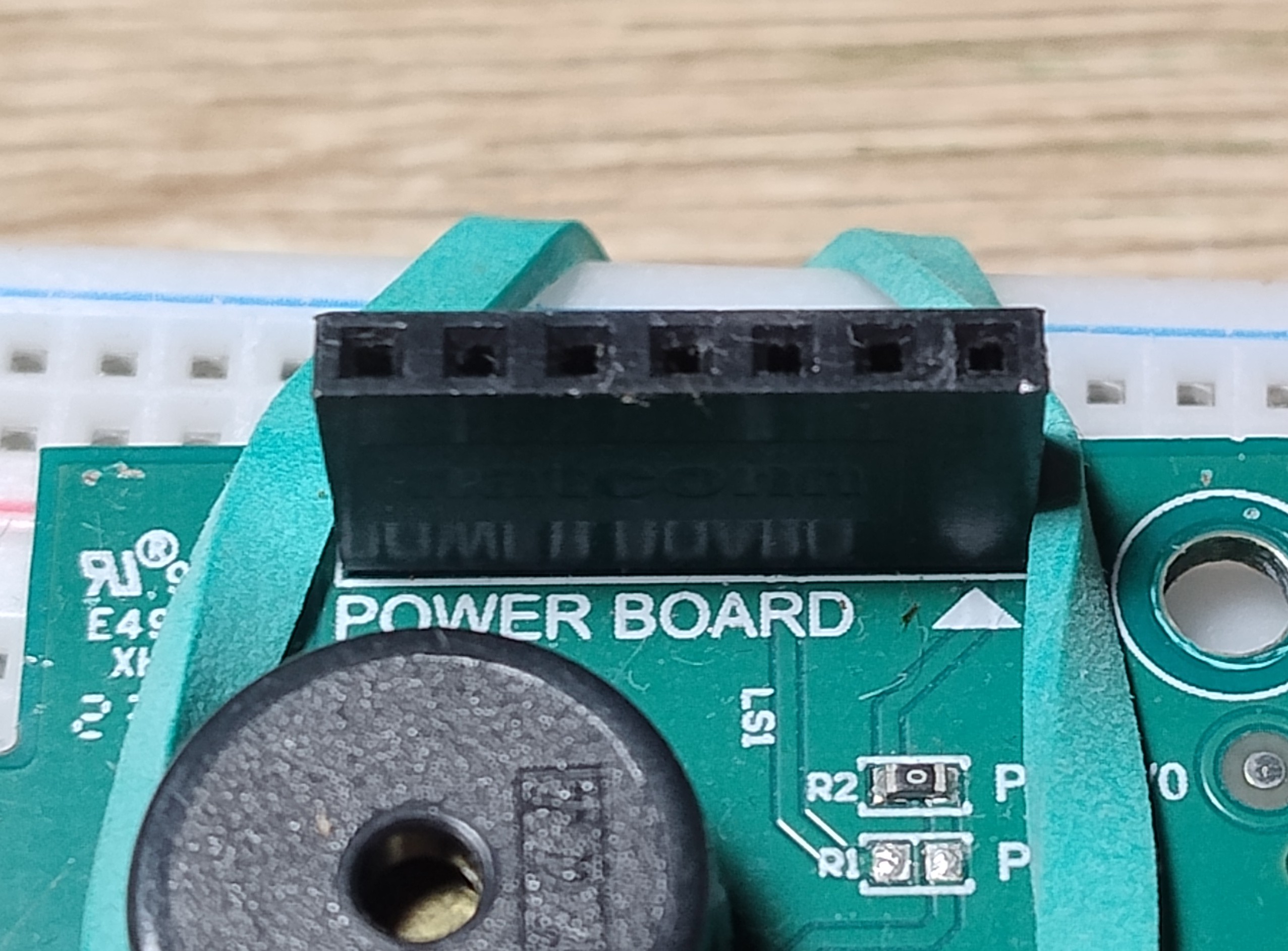

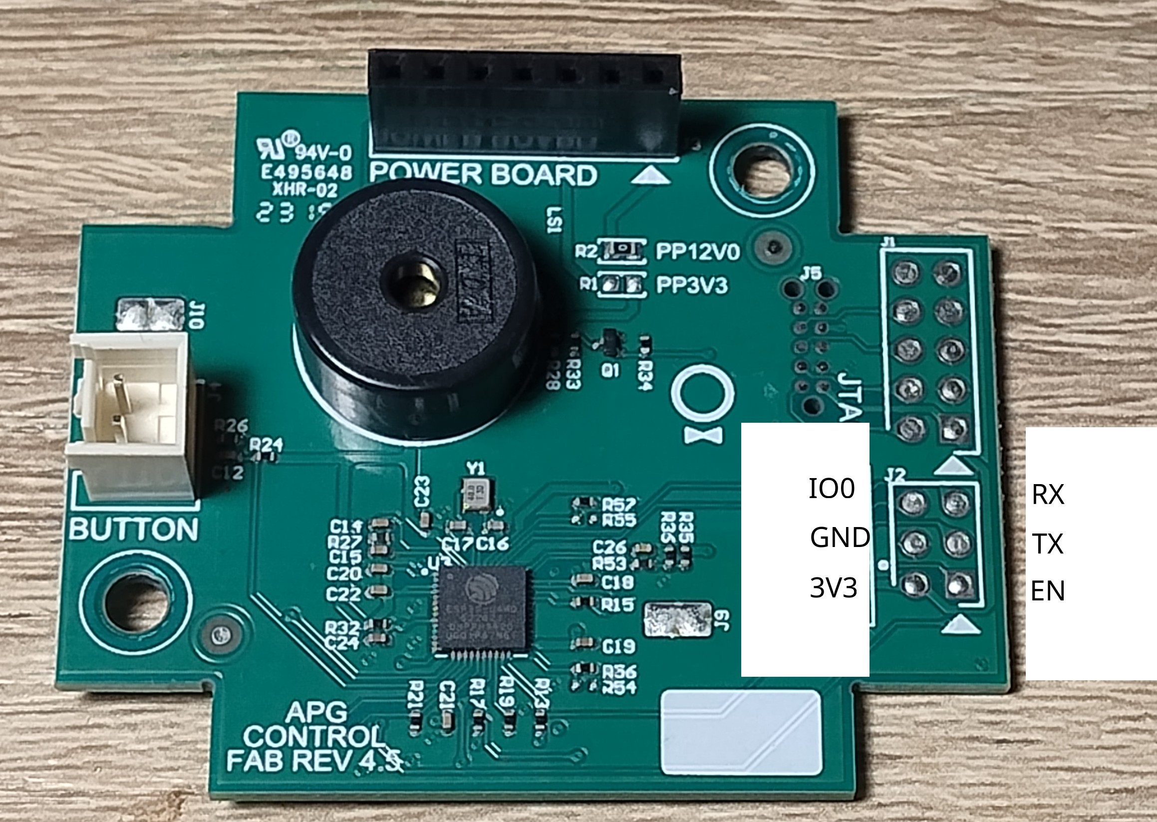

I started by writing the pins out on paper, numbering them per the IDC convention. Pin 1 is the square pad, additionally marked with an arrow; pin 2 sits opposite it, and so on. Then I moved on to identifying GND and 3V3.
Finding ground wasn’t hard. The first clue was a small cross visible on one of the pads of the J2 field.
Why J2 and not PROG? You can see on the board that both fields are connected 1:1, and a multimeter test confirmed it. The PROG field, J6, is most likely there for “bed-of-nails” testing.
Second clure – crosses - one visible on pad 4, several on the J1 field (JTAG). J4 is the connector for the button that starts the grinder - one pin is a controller GPIO, and maybe the other one is ground? Sure enough: the bottom pin (in the orientation from the photo) and all the cross-marked pads are connected together. A net that extensive has to be the circuit’s common ground. First pin identified.
Now VCC. On the board you can spot PP3V3 and PP12V0 - the latter bridged with a 0 Ω resistor. Maybe one of the 3V3 pads is connected to one of the J2 pads? Yes! There’s continuity between the left PP3V3 pad (in the orientation from the photo) and pad 2 on J2. The right PP3V3 pad, in turn, has continuity with the tab of the LD1117, which in the SOT-223 package is connected to VOUT (3V3). The LD1117 sits on the power board, on the underside.

Moving on - the EN pin. Per Espressif’s documentation there should be a 10 kΩ pull-up between 3V3 and EN, with a capacitor to GND along the way. The only pin giving those readings on the multimeter is pad 1, the one marked with a square. 50% of the pins I need, identified. While I was at it I noticed that between 3V3 and pad 6 there’s most likely a 1.8 kΩ resistor, so this may well be GPIO0. Shorting that pin to ground will be needed to enter programming mode. Two pads left, 3 and 5. With those I noticed they have diodes on them - pushing current one way shows no connection on the meter, the other way shows continuity. That suggests these are pads connected directly to the chip. So one is RX and the other TX. Let’s check.

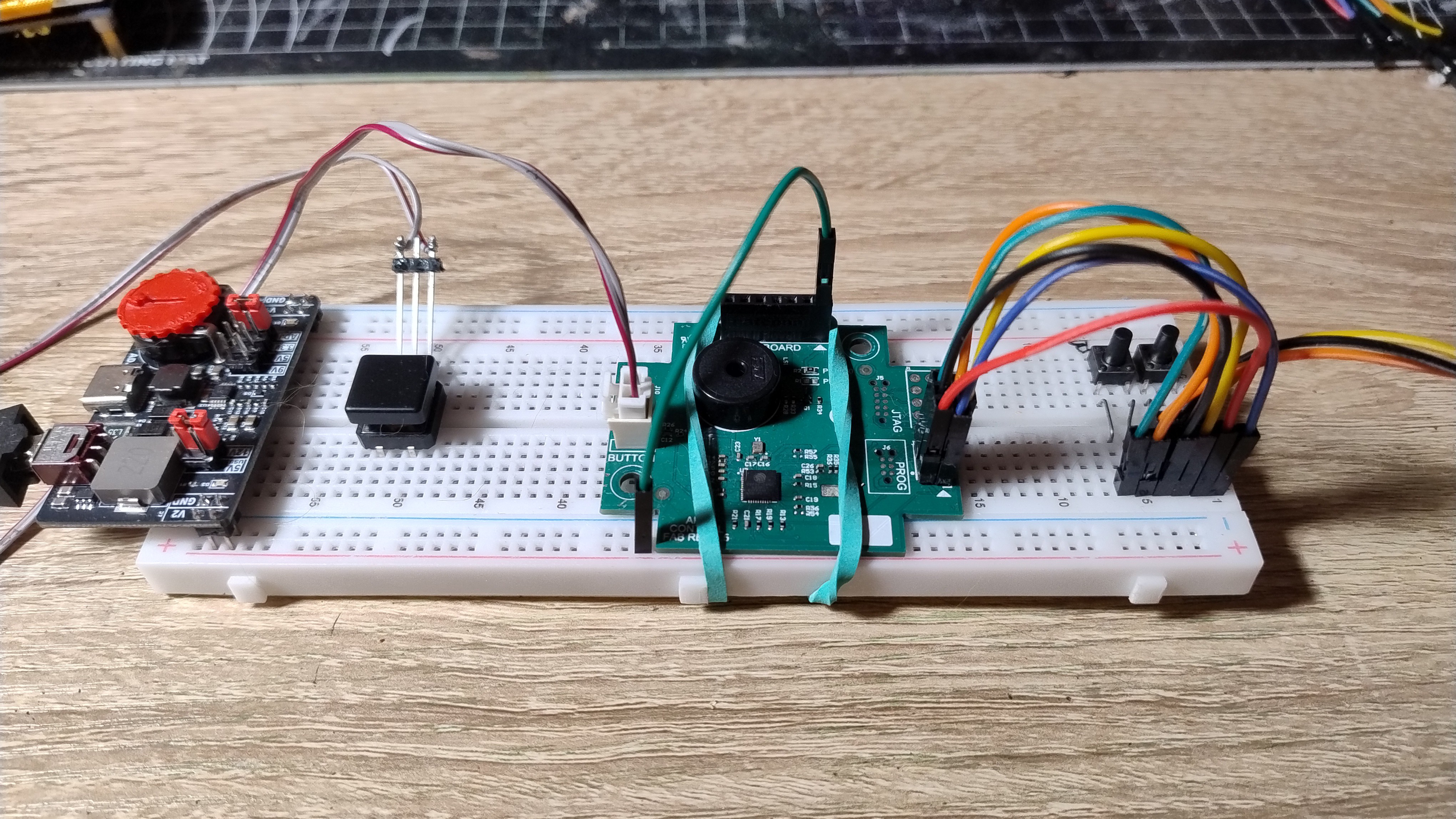

To make life easier I built this contraption. You can see the Boot and Reset tact switches shorting the relevant pins to ground (reset - EN-GND; boot - IO0-GND) and a third, larger one wired to J4, the connector for the grind button. I soldered pin headers into the pads and connected the UART-USB converter to them (a CP2102 from Waveshare). To begin with I connected only the converter’s RX pin - I still didn’t know which pad on the board was RX and which was TX, and I wanted to avoid conflicts. I hooked RX up to pin 3. I plugged the whole thing into a USB port, fired up a serial monitor at 115200 baud, hit reset on the board and…
I got a bootlog! After that it was garbage, but the first lines were readable. So I’d hit the board’s TX on the first try. I could connect the remaining pins and move on to dumping the firmware. The brain pulled out of the grinder was now floating in a jar on my desk, and I could do whatever I liked with it.

And two pins responsible for the Board ID - 4 and 21. In my case the Board ID is [0,0]. I couldn’t be bothered to work out which pin is the first bit and which is the second.
