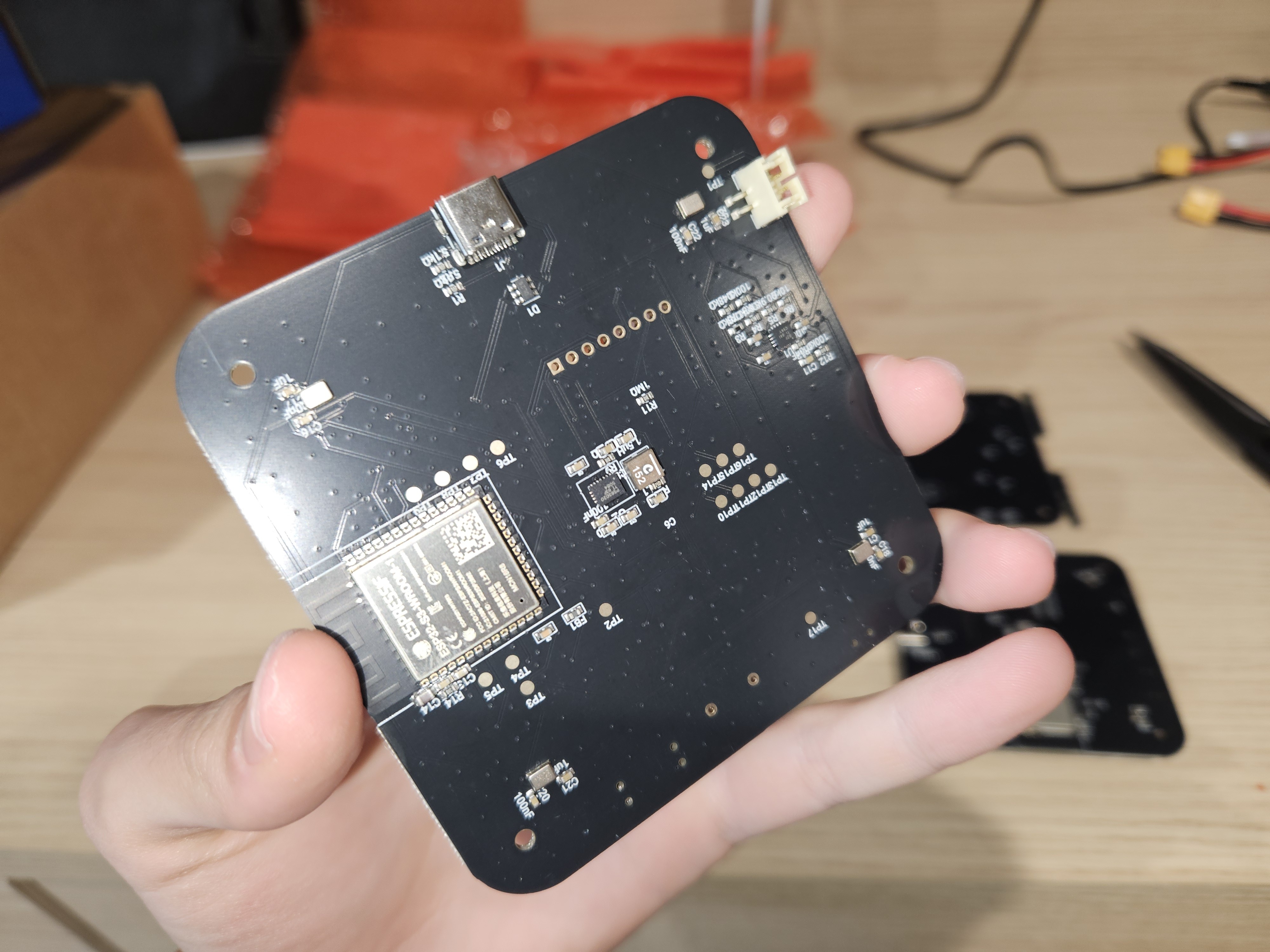

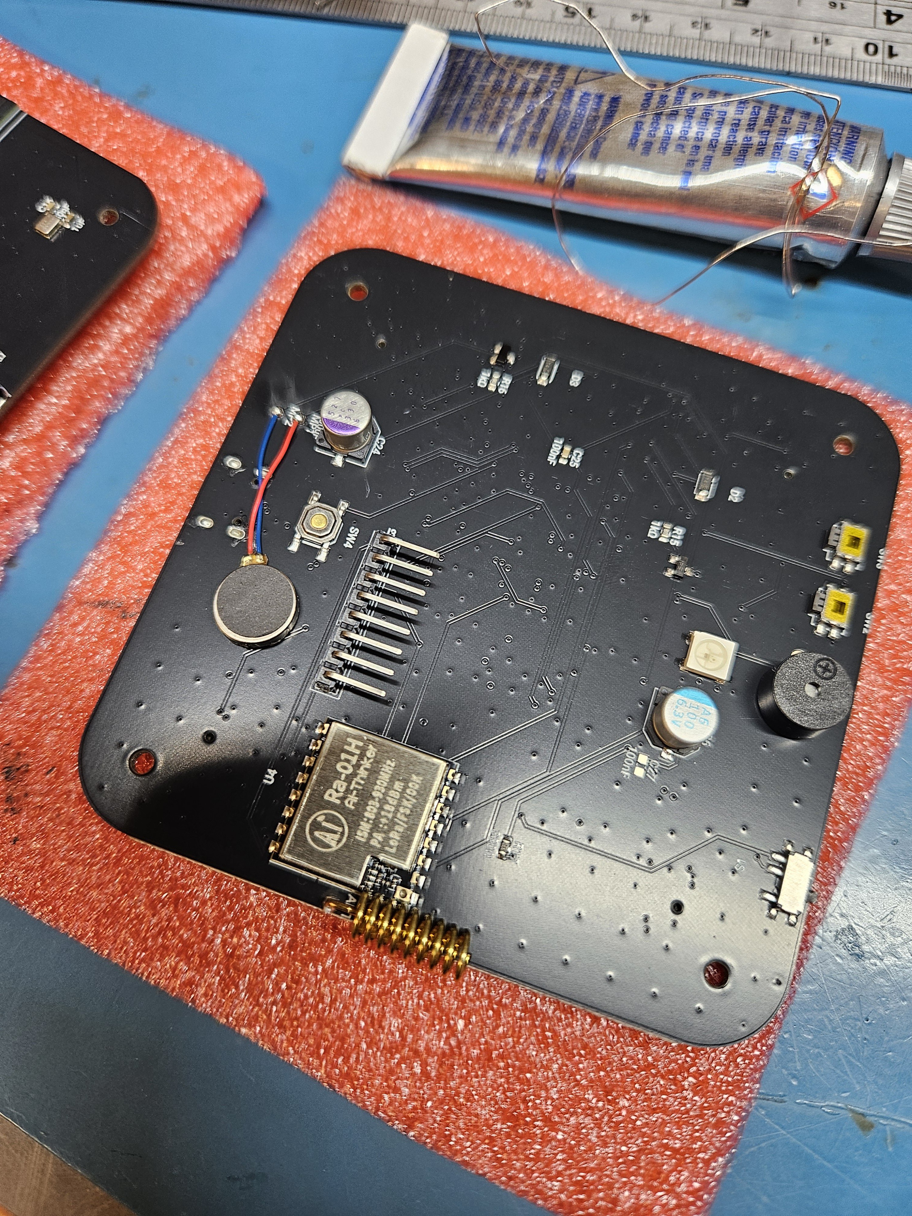

There are four ICS-43434 MEMS microphones, one near each corner of the board, all running off a single I2S clock so their samples line up. Then they're just added together.
I expected to beamform them and steer a lobe around the sky. I ran the numbers first and it was a waste of time. The array is 79 mm corner to corner, and at 450 Hz a wavelength of sound is about 760 mm. The array is a tenth of a wavelength across, which means to a 450 Hz sound it is effectively a single point. There is nothing to steer.
Summing them still buys something: about 6 dB of signal-to-noise for free, because the drone arrives at all four mics correlated and the electrical noise doesn't. And staying omnidirectional turns out to be what you actually want, because the thing can come from any direction and you don't get to choose.
The board is 84 x 84 mm, four layers, ENIG. ESP32-S3-WROOM-1-N16R8, an Ra-01H LoRa module, a BQ24074 power-path charger, a TPS63020 buck-boost for a single 3V3 rail, a WS2812B, a buzzer, motor pads, an e-paper header, USB-C and a JST-PH battery connector. JLCPCB assembles everything except four through-hole parts.

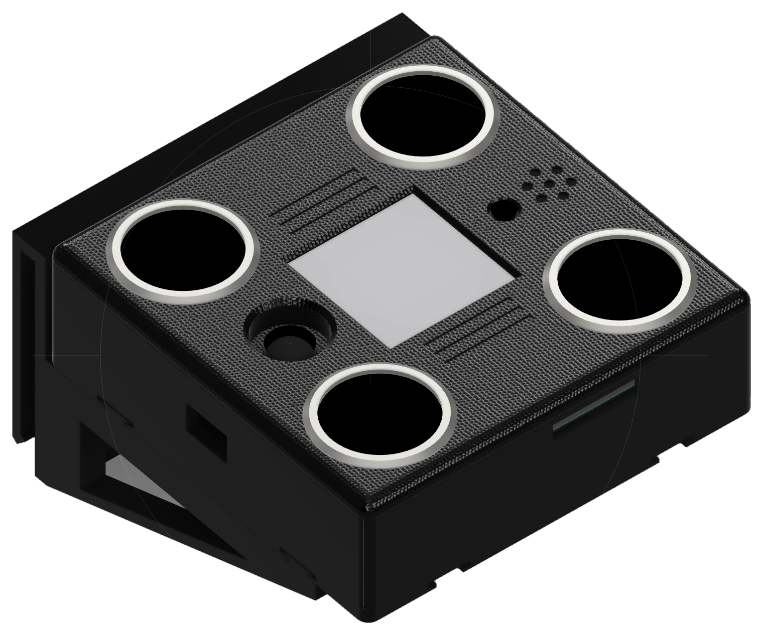

Four printed parts in black PETG, no supports needed. The lid has 45 degree cones behind each microphone aperture so sound reaches the bottom-ported mics through the board. There's a light pipe over the RGB LED, a grille cloth behind...
