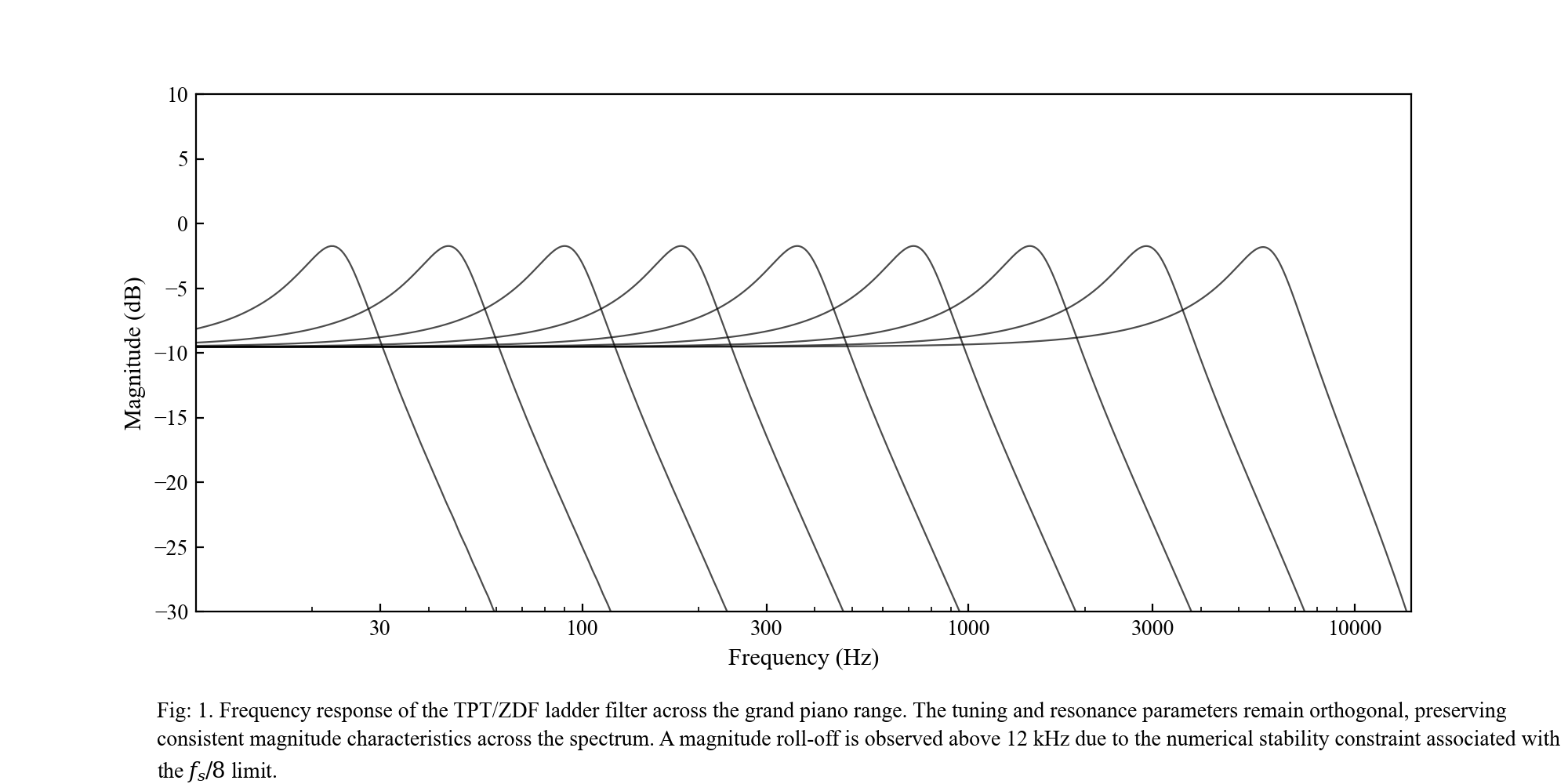

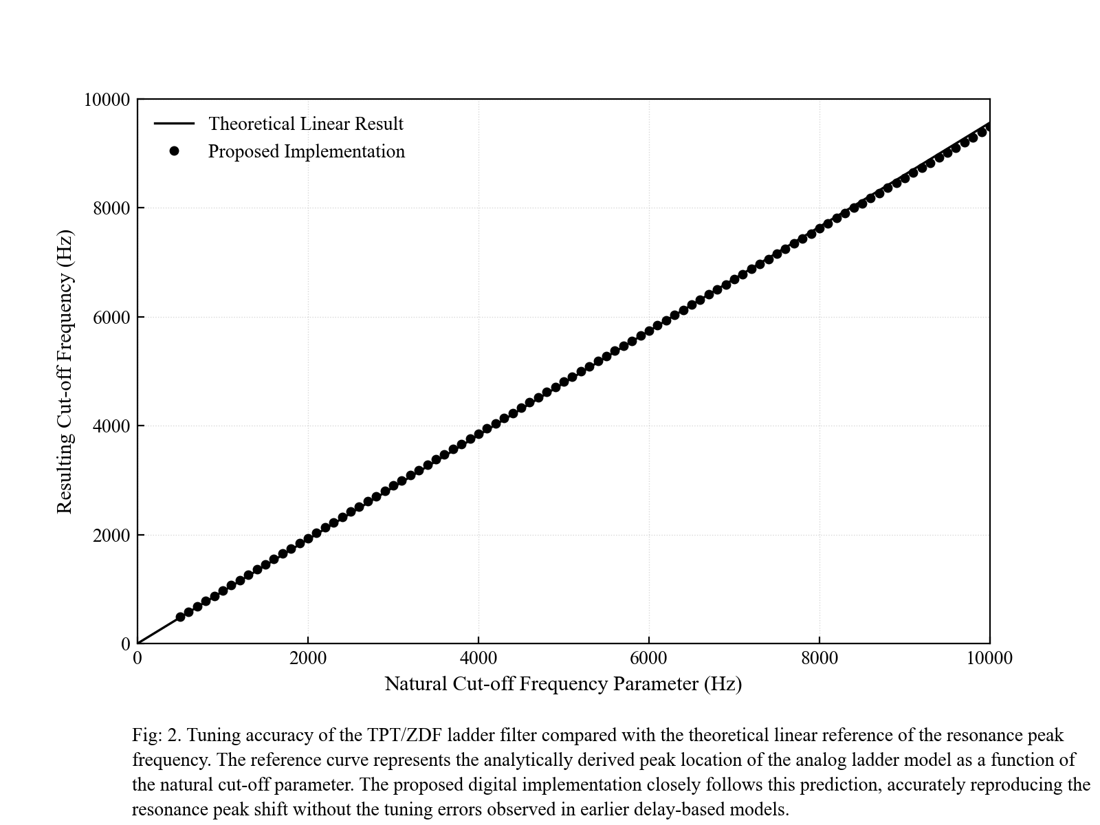

    I ran a detailed frequency response measurement of the ladder filter implemented in my synth, focusing on two specific properties.
    First, the resonance magnitude remains consistent across the entire frequency range.
    Increasing resonance does not introduce frequency-dependent gain variation, the peak height stays uniform as the cutoff moves. This confirms that cutoff and resonance are effectively orthogonal.
    Second, the resonance peak frequency closely matches the theoretical prediction derived from the linear analog ladder model. The measured peak shift aligns almost perfectly with the analytical reference curve.
    In other words, the digital TPT/ZDF implementation reproduces both:
    • constant resonance magnitude behavior
    • correct analog peak frequency shift
    Above roughly 12 kHz, minor roll-off and deviation appear due to numerical stability limits (fs/8 constraint), but within the practical audio range the behavior remains consistent and predictable.
    With these results, I can confidently rely on this filter design, not only musically, but also from a physical and analytical standpoint.

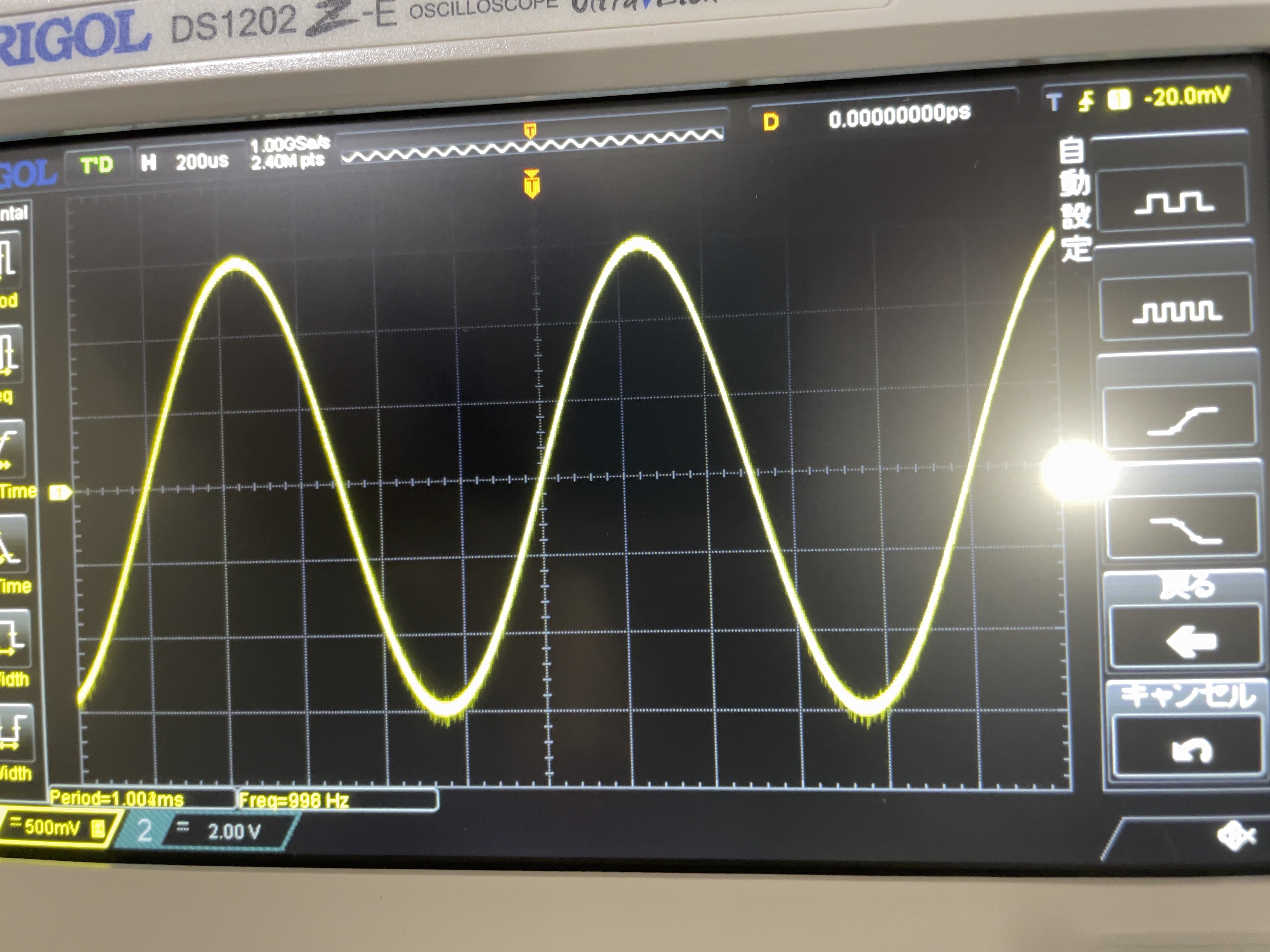

    There was one minor issue: the audio output noise floor is a bit higher than I expected. It’s not severe, but I’d like to improve it in the next hardware iteration.
    For the DAC path, I ended up writing a custom I²S Standard 24-bit PCM DMA streamer for the PCM5122.
    Originally I planned to integrate this into the pico_audio library, but that approach required too much overhead, so I opted for a lightweight, dedicated implementation.
    For a quick sound check, I generated a simple saw wave on six instances, tuned them slightly apart, and stacked them into a unison tone. Nothing fancy yet, but it’s a solid first sound coming from this board.
    More updates to come as I move into the next iteration.

I just received the PCB/PCBA order and finished the initial round of testing.
Happily, all the major elements on the board — the ADC/knob system, LEDs, OLED, DAC, AMP and so on — are working correctly.
The only issue so far is that the audio output noise floor is a bit higher than I expected, so I’d like to improve that in the next iteration.
