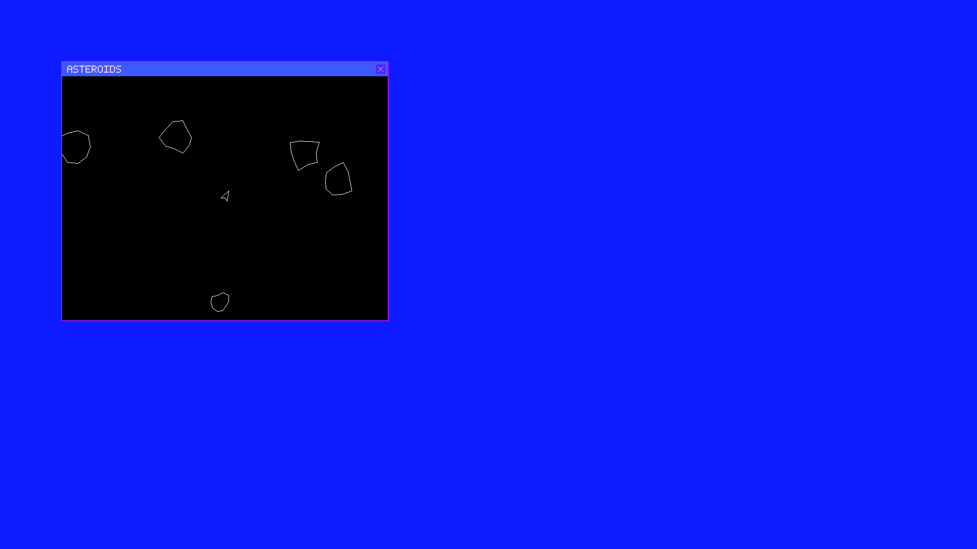

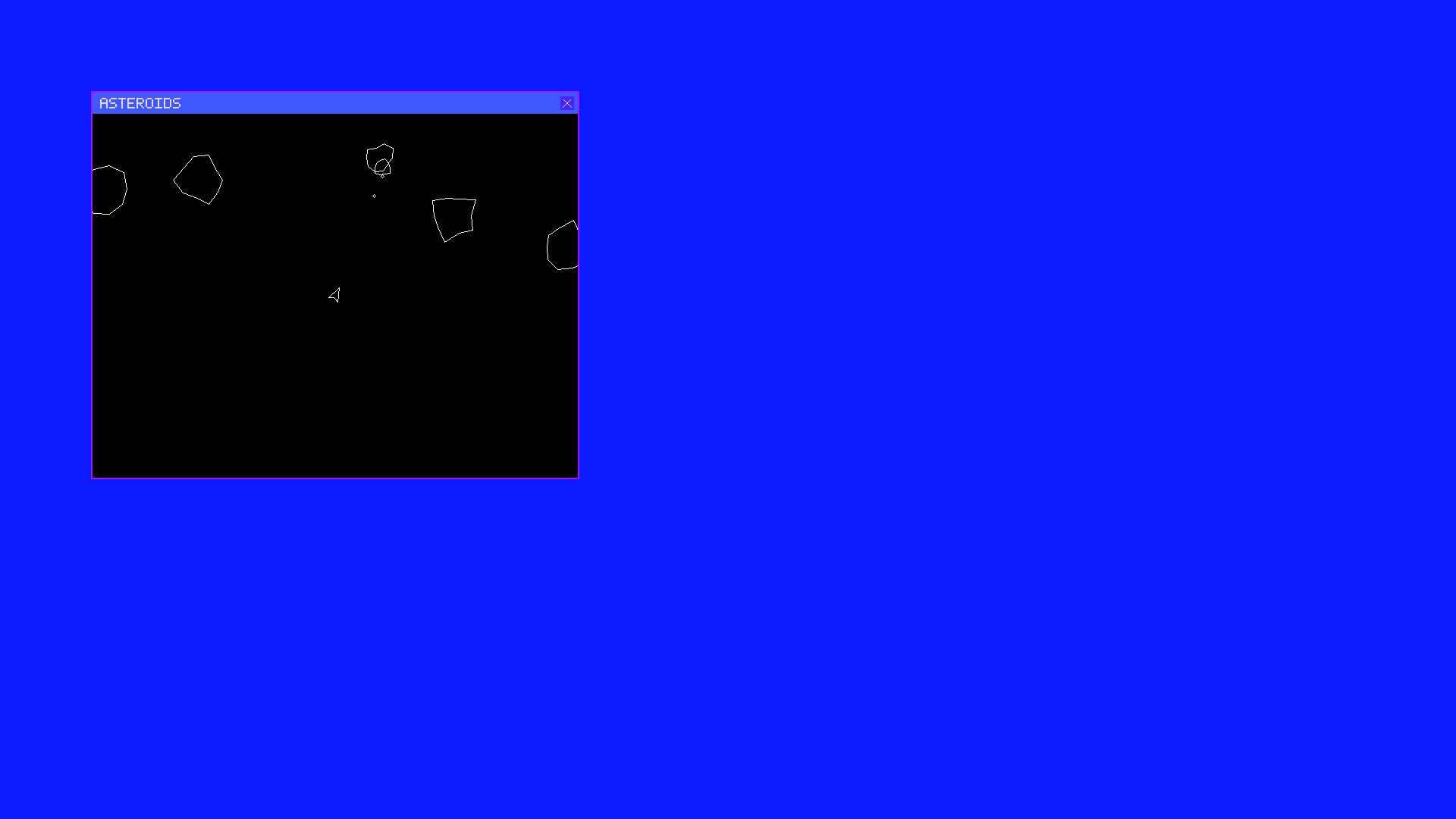

Actual Project Ceylon runtime capture from QEMU. Early “first light” framebuffer output during bring-up. This is not a UI mock-up or rendered concept image; it is output produced by the Ceylon system during development. The incomplete text rendering visible here reflects the state of the display path at that milestone.
