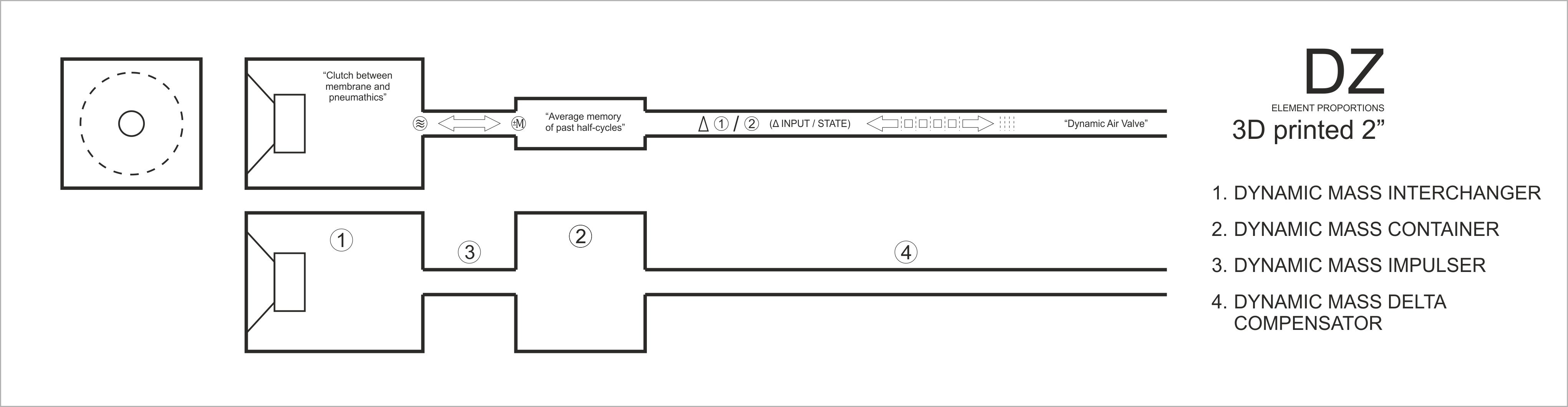

Dynamic Zero (DZ) is an experimental open-source loudspeaker architecture based on controlled reciprocal pneumatic interaction behind the driver diaphragm.
The internal pneumatic structure retains part of the state and energy from the preceding half-cycle and uses it in interaction with the incoming half-cycle.

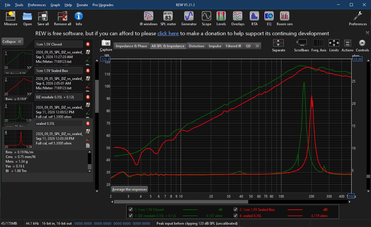

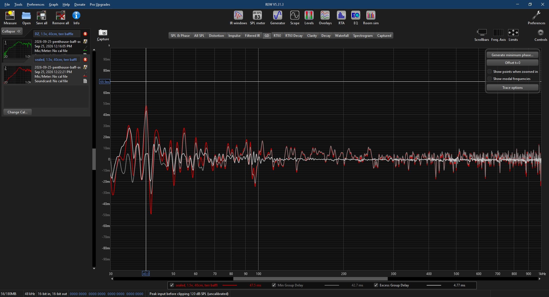

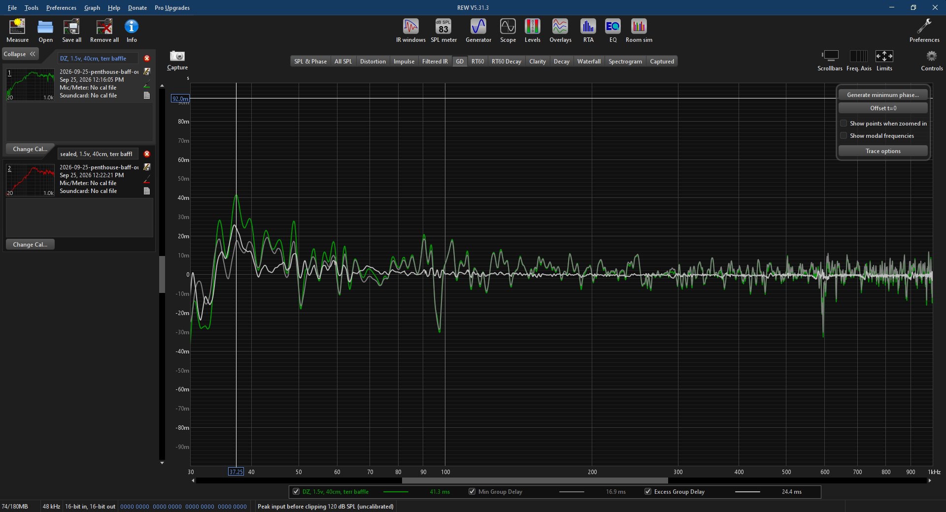

The project is currently experimental. Prototype measurements, raw REW data, CAD files and build information are published openly for independent testing.

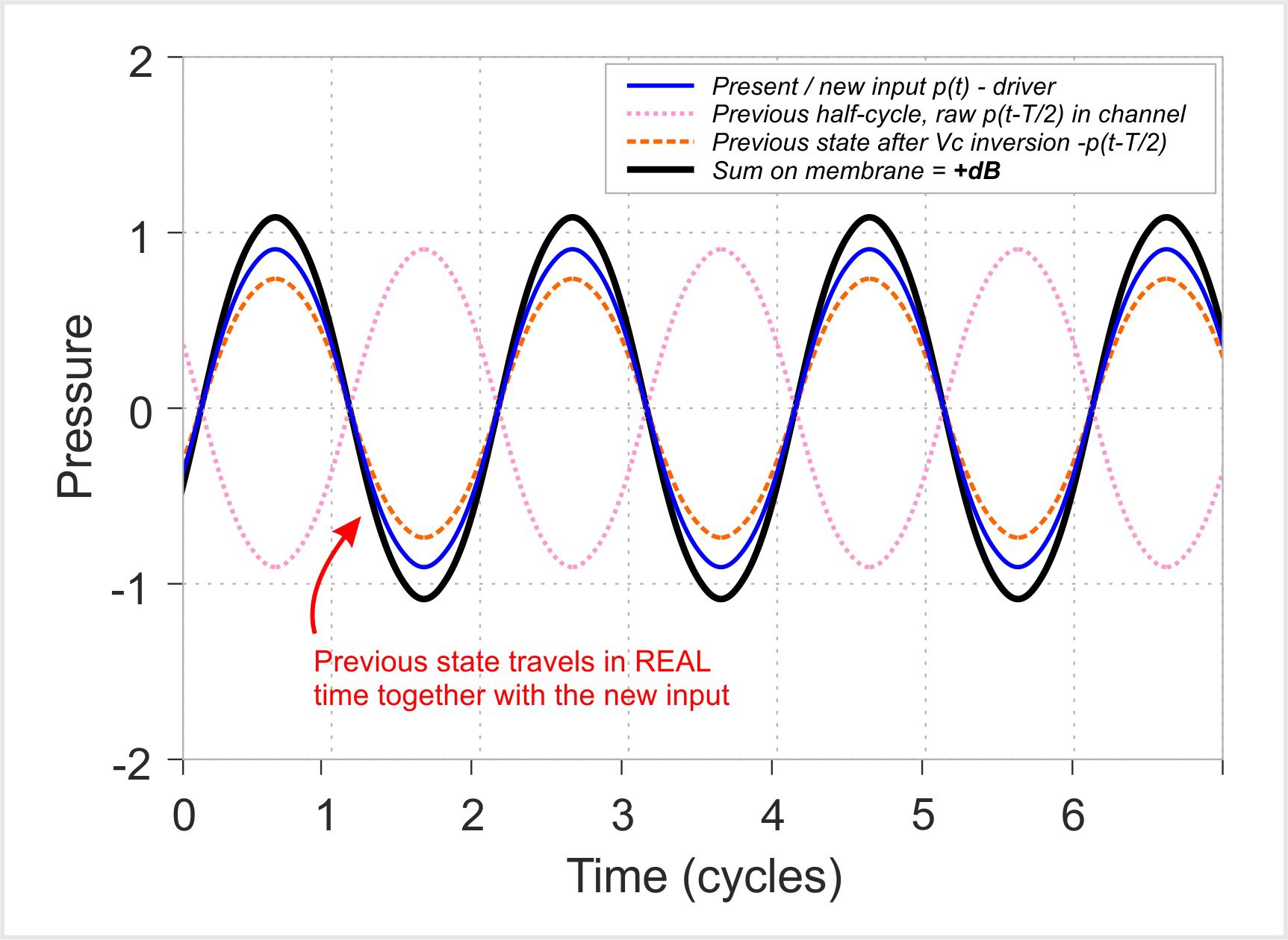

In the ideal periodic T/2 case:
p(t-T/2) = -p(t)
After pneumatic inversion:
p(t) + [-p(t-T/2)] = 2p(t)
The ideal pressure ratio is therefore 2:1, corresponding to approximately +6 dB. This theoretical value cannot be achieved in a real DZ system due to unavoidable losses.
The important point is simple:
**The new input does not start from zero. It interacts with energy retained from the preceding state.**
