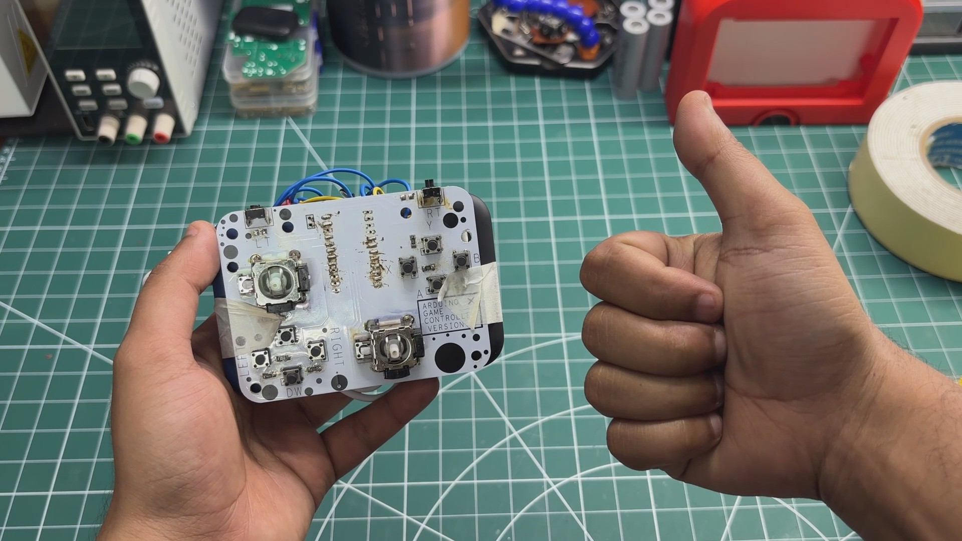

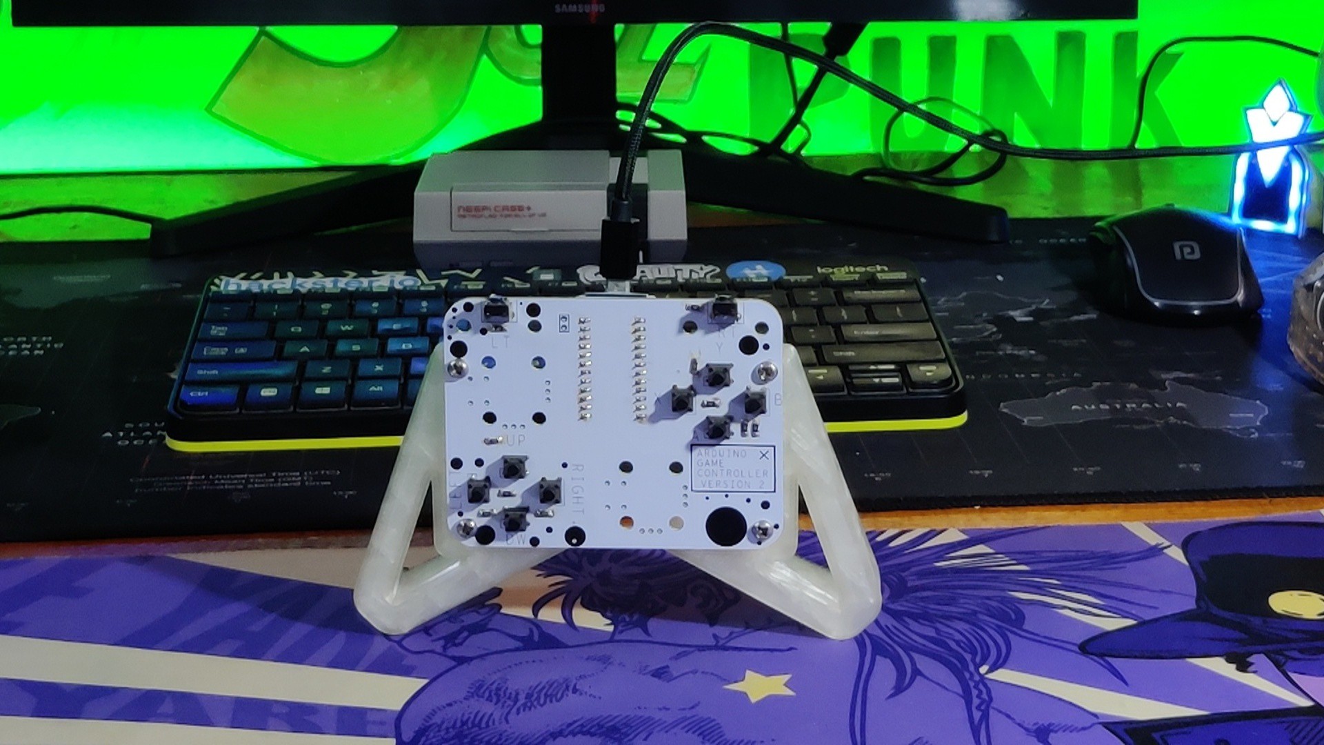

Greetings everyone, and welcome back.
This is my prototype for a wireless Bluetooth game controller built around the Arduino Nano ESP32.
The idea behind this project is to eventually build a completely open-source game controller, from the electronics and PCB to the enclosure and firmware, so that anyone can build their own controller, modify it, or use the design as a starting point for their own projects.
This prototype is the first step towards that goal. I wanted to test the core electronics and make sure I could get a custom controller working wirelessly before designing the final hardware from scratch.

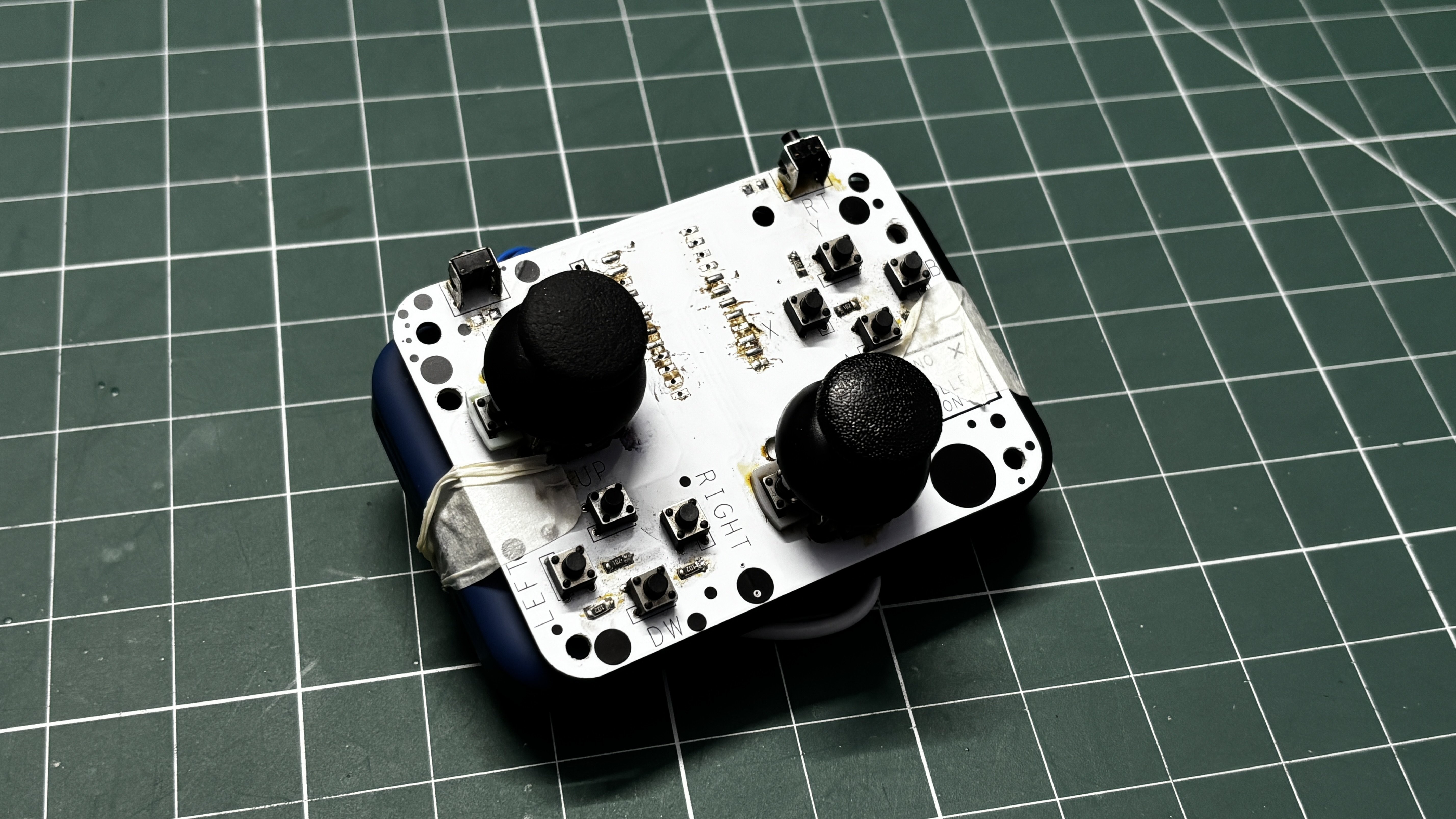

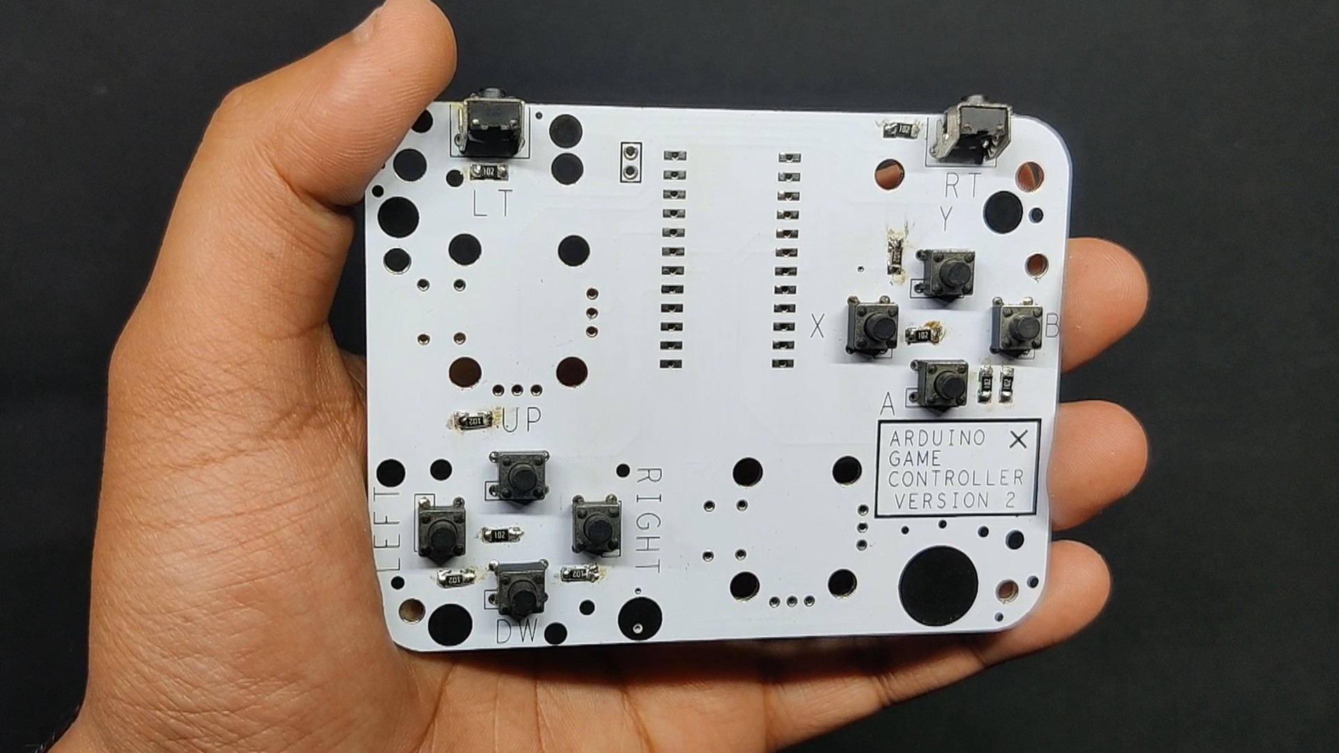

For the prototype, I reused the PCB from a wired game controller I built previously. That board was originally designed around an Arduino Pro Micro and the ATmega32U4. By replacing the Pro Micro with an Arduino Nano ESP32, I can take advantage of the ESP32-S3's built-in Bluetooth Low Energy and turn the same basic controller hardware into a wireless gamepad.
The prototype is already fully functional and can connect to a computer over Bluetooth and work as a regular game controller. I’ve been using it to play games like Cyberpunk 2077 and NieR while testing the hardware and firmware.
This isn't the final controller yet. The eventual version will have a completely custom PCB, a purpose-built enclosure, and a much more refined design. For now, this prototype is about proving that the concept works and laying the groundwork for the open-source controller project.
This article covers the complete build process of this prototype, so let's get started with the build.

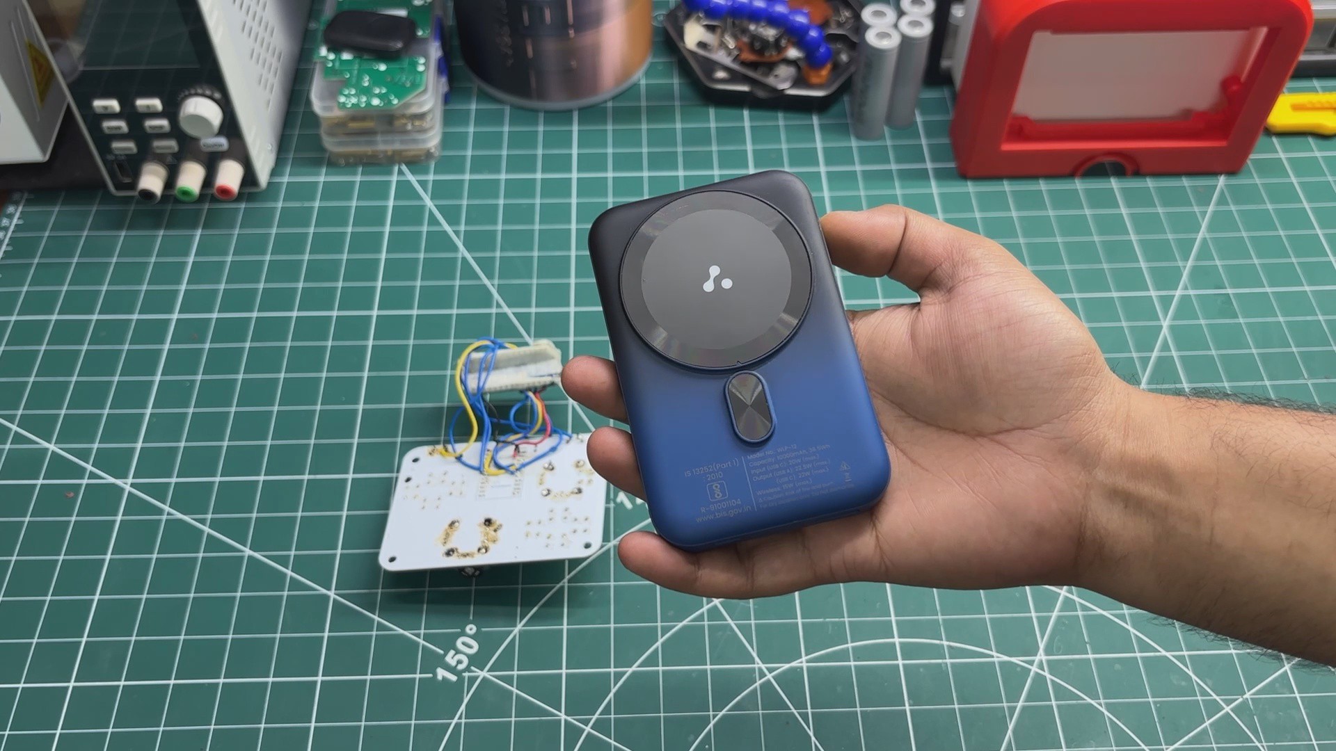

MATERIALS REQUIRED
These were the components used in this build
  • Custom PCB (Salvaged from previous Project)
  • Arduino Nano ESP32 Board
  • Right-Angle Push Buttons
  • Horizontal Push Buttons
  • Analog Joysticks
  • Power bank
  • USB to Type C Cable
  • Double-sided tape

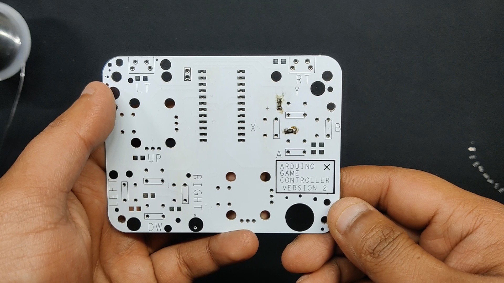

HARDWARE—ARDUINO GAME CONTROLLER
If the Arduino Nano ESP32 is the brain of this project, then the previously made game controller PCB is definitely the brawn.
For this project, I'm reusing the main joystick and button PCB from my previous Arduino game controller project. In the original version, an Arduino Pro Micro was connected to this PCB and acted as the interface between the controller and the PC. Using the ATmega32U4's native USB HID support, I was able to control games and use the board as a regular game controller.
The most interesting part of this controller, however, is that only one I/O pin is used to control all 10 buttons on the board. I achieved this using a clever resistor voltage-divider setup, which allows the microcontroller to identify which button is being pressed by reading different voltage levels from a single analog pin. I'll explain how this works in the next step.

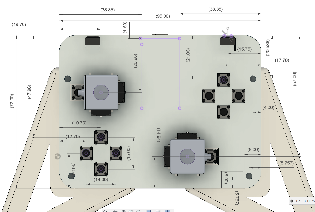

I had also designed this PCB with provisions for two thumbsticks, which is something I was able to take advantage of for this wireless version.
For a more detailed look at the construction and the other design decisions behind the original controller, check out its project page.
https://www.hackster.io/Arnov_Sharma_makes/arduino-retro-game-controller-7cdd0e

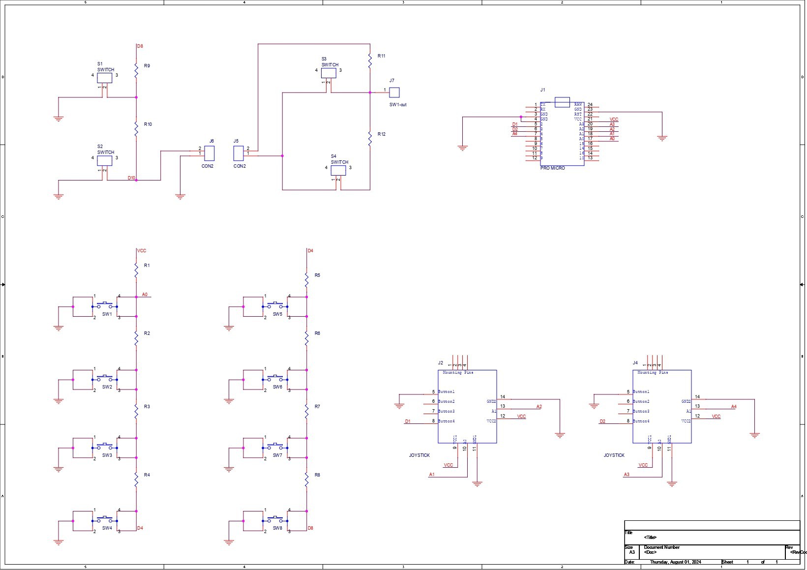

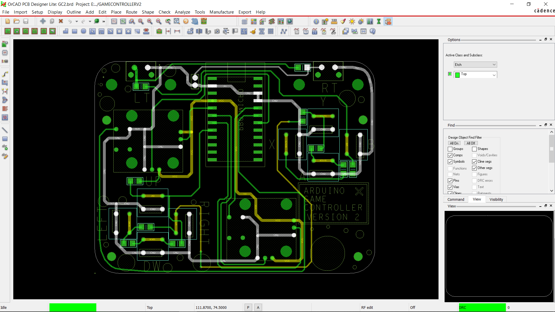

PCB DESIGN
For this project, I made a fairly traditional, straightforward game controller PCB, with the buttons connected to the GPIO pins of a microcontroller that supports HID, since the original version was designed as a wired game controller.

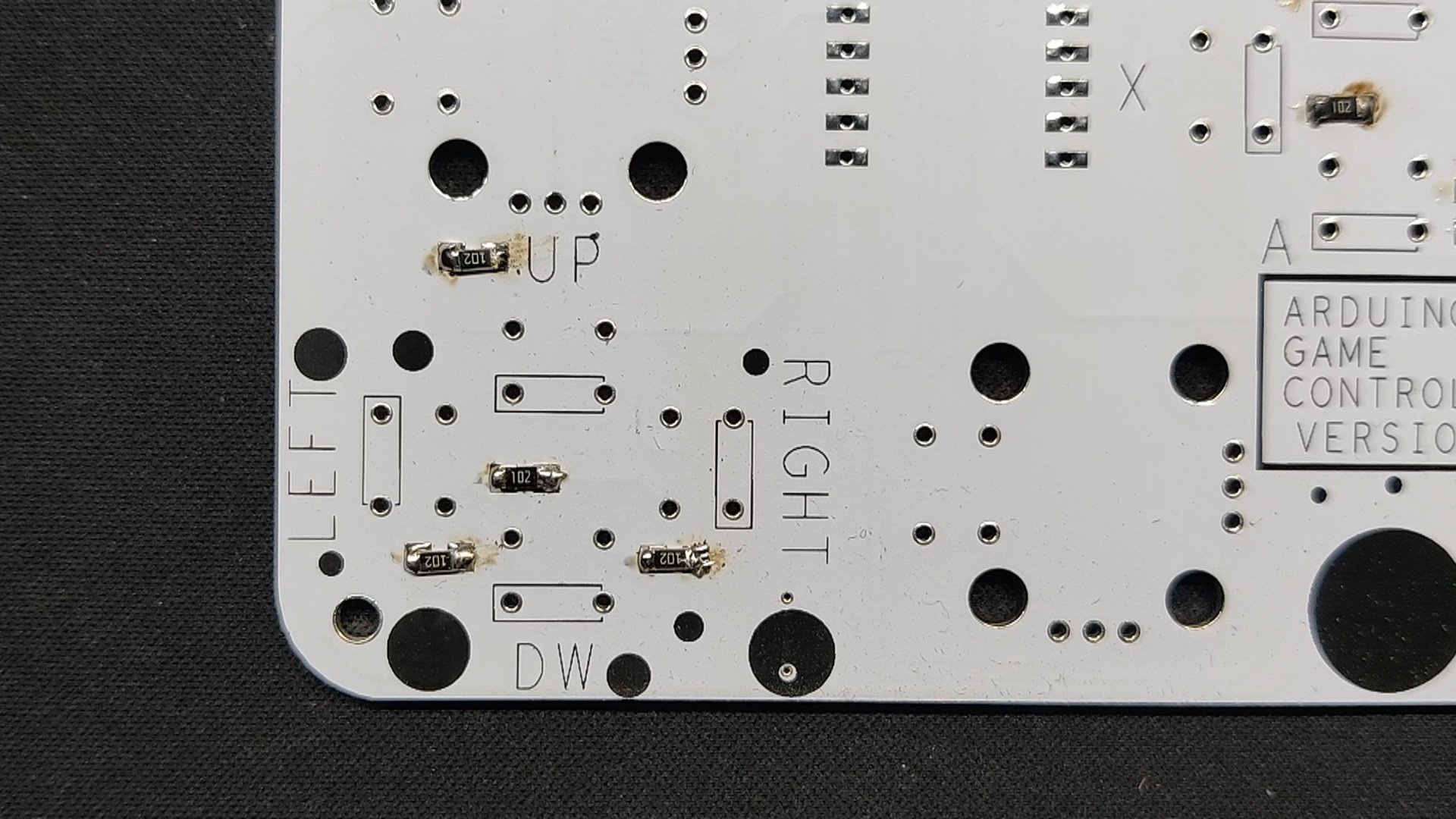

The interesting part is how I managed to connect 10 buttons using a single I/O pin.
For this, I built a resistor-ladder arrangement using twelve 1 kΩ resistors connected in series between VCC and the button inputs. Each button connects to a different point on the resistor ladder, while the other side of each switch is connected to ground.
When a button is pressed, it produces a different voltage at the shared analog input depending on its position in the resistor ladder. The microcontroller reads this voltage through its ADC and can determine which button was pressed based on the measured value.
This approach makes it possible to connect a large number of buttons to a single analog I/O pin, instead of needing a separate GPIO pin for every button. In practice, you can use this technique to fit 10–20 buttons or even more onto a single input, depending on the resistor values, ADC resolution, and how much tolerance you can accommodate.

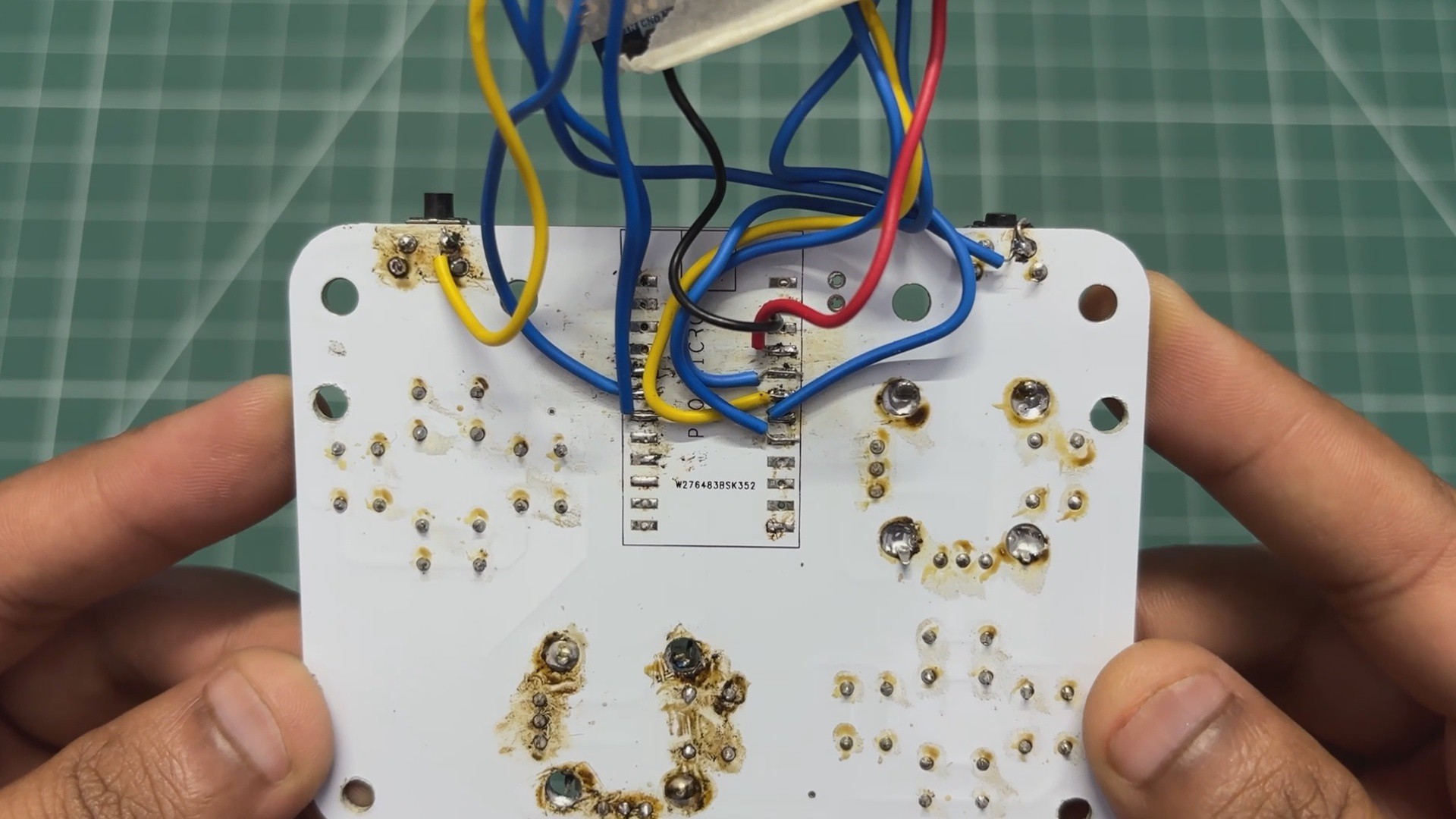

    WIRING

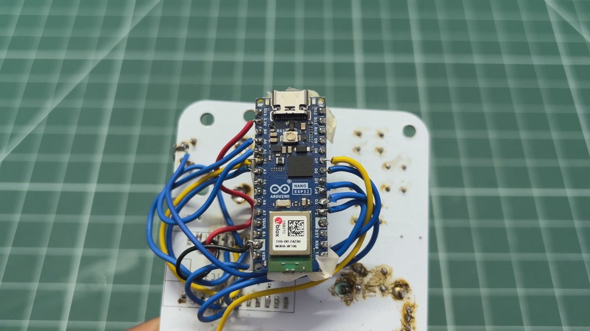

    Wiring this board was quite straightforward. I was able to use a single analog pin for all the A, B, X, Y buttons and D-pad inputs using a resistor ladder, with A0 handling the combined input.
    The rest of the controls were connected as follows:
    • Right joystick Y: A1
    • Right joystick X: A2
    • Left joystick Y: A3
    • Left joystick X: D4
    • Right joystick switch: D2
    • Left joystick switch: D3
    • LT: D6
    • RT: D7
    I initially ran into some issues with the LT and RT inputs, so I ended up connecting them directly to D6 and D7 respectively. For making connections, I use single-core silver copper wire.
  • 2

    Pin Mapping
    const int PIN_LADDER = A0;const int PIN_RJ_Y   = A1;const int PIN_RJ_X   = A2;const int PIN_LJ_Y   = A3;const int PIN_LJ_X   = D4;const int PIN_RJ_SW  = D2;const int PIN_LJ_SW  = D3;const int PIN_BTN_LT = D6;const int PIN_BTN_RT = D7;
    This section defines where each physical control is connected to the Nano ESP32.
    The A, B, X, Y buttons and D-pad share A0 through the resistor ladder. The two joysticks use four analog inputs for their X and Y axes.
    The joystick-click switches, LT and RT are connected to digital GPIO pins.

    The Resistor Ladder
    struct LadderEntry {    int value;    int id;    const char *name;};LadderEntry ladder[] = {    {   0, XB_UP,    "UP"    },    { 510, XB_DOWN,  "DOWN"  },    { 681, XB_LEFT,  "LEFT"  },    { 767, XB_RIGHT, "RIGHT" },    { 819, XB_Y,     "Y"     },    { 852, XB_A,     "A"     },    { 877, XB_X,     "X"     },    { 900, XB_B,     "B"     }};
    This is where the resistor ladder becomes useful.
    Instead of dedicating a separate GPIO pin to every button, each button produces a different voltage that can be measured through the single analog pin A0.
    For example, an ADC reading around 852 represents the A button, while around 900 represents B.
    The controller compares the measured ADC value against this table and selects the closest matching button.
    This allows eight different inputs to share a single analog pin, saving a significant number of GPIOs.

    POWER SOURCE
    With the firmware flashed, the game controller is ready to go. There is just one problem: it is still wired.
    The controller needs to be powered, and for now, that means connecting a USB Type-C cable to the Nano ESP32.
    To get around this temporary limitation, I decided to use a MagSafe power bank. Not because it has MagSafe or anything fancy like that, I just happened to have one lying around.
    The power bank is capable of delivering USB Power Delivery (PD) outputs, but the controller doesn't need anything nearly that complicated. For this prototype, all we need is a regular 5 V supply capable of delivering up to 2 A.
    In reality, the controller should draw considerably less than 2 A. Based on the hardware used in this prototype, the actual consumption should be somewhere around a few hundred milliamps, and potentially even below 200 mA, depending on the operating conditions and connected peripherals.
    For a prototype, though, having a power bank capable of supplying 5 V at 2 A gives us plenty of headroom.
    With the power bank attached to the back, we now have a completely wireless controller, at least until the power bank inevitably becomes the most structurally important part of the entire assembly.
