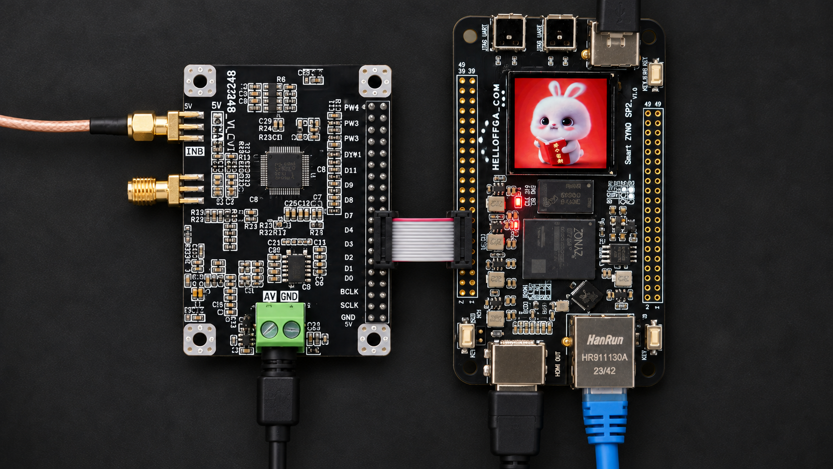

two-board setup
The AD9248 board (on the left) is the acquisition end:
  • antenna input conditioning
  • and high-speed conversion.
https://www.analog.com/media/en/technical-documentation/data-sheets/ad9248.pdf
The SmartZynq SP2 (on the right) is the processing end:
  • it receives the sample stream,
  • runs the digital signal processing pipeline in programmable logic,
  • provides the operating system and network interface.
http://www.hellofpga.com/index.php/2024/01/21/smart-zynq-sp2/

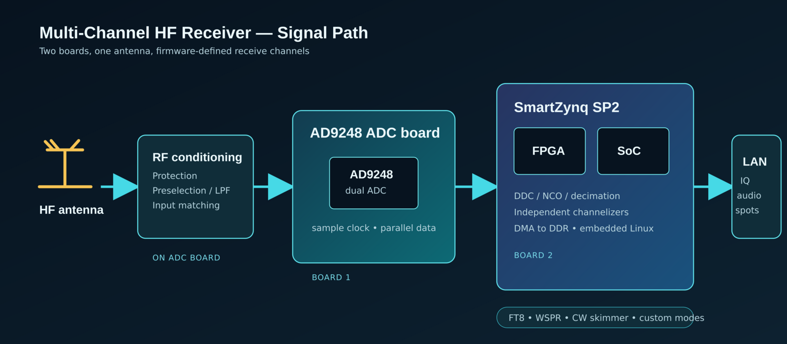

Why these two boards?
The AD9248 provides fast dual-channel conversion, while the SmartZynq SP2 pairs FPGA fabric—ideal for many parallel DDCs—with an embedded processor that can boot, configure the receiver, and serve results over Ethernet. Together they move the difficult hardware work into a repeatable two-board assembly and leave experimentation to firmware.
Block diagram
The antenna enters the ADC board, where it is protected, filtered, and matched before conversion.
Sample data crosses to the SmartZynq SP2, whose FPGA creates independent digital channels.
The SoC then exposes those channels as IQ, audio, or decoded/spot data over the network.
