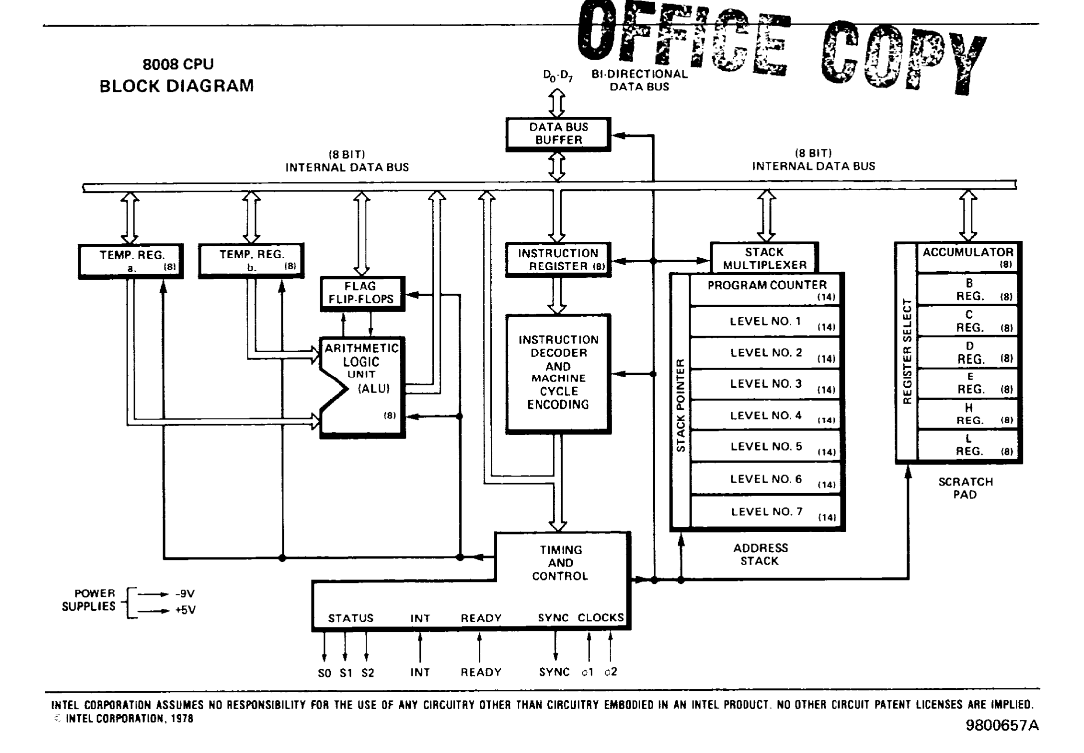

I had three major revisions, s8008, v8008 and finally b8008. ( My thinking was soft8008, verbose8008 and block8008. s8008 reached hardware before I understood its timing model was wrong. v8008 had too much shared logic and conditional soup to debug. b8008 started from a clean slate in November 2025 with one module per block-diagram box, and every module got its own testbench before the top level existed.

About 27 modules, each one a box from the Intel diagram: state timing generator, machine cycle control, instruction register, instruction decoder, register and ALU control, register file, temp registers, ALU, carry look-ahead, condition flags, address stack, stack pointer, interrupt and ready flip-flops, I/O buffer, memory mux. Each is 50 to 100 lines and does one thing. The stack pointer is 69 lines and knows two words, push and pop. It has no idea what CALL or RST or an interrupt is.
There is no separate program counter, because the real chip doesn't have one. The PC is whichever of the eight 14-bit address-stack registers the stack pointer selects. CALL is the SP moving on and the old slot keeps the return address. RET is the SP moving back. Seven nested returns, and the eighth CALL wraps onto the oldest. I built it with a separate PC first and a family of workaround flags grew around it. Rebuilding it as the diagram shows deleted all of them.
Every documented instruction takes the datasheet's 5, 8 or 11 T-states. Fetch cycles of multi-cycle instructions end at T3, not-taken conditionals end early, and a regression counts simulated states per timing class against docs/isa.json. Interrupts are recognized only at instruction boundaries, per Figure 2 of the User's Manual. READY parks the CPU in a real WAIT state between T2 and T3.
