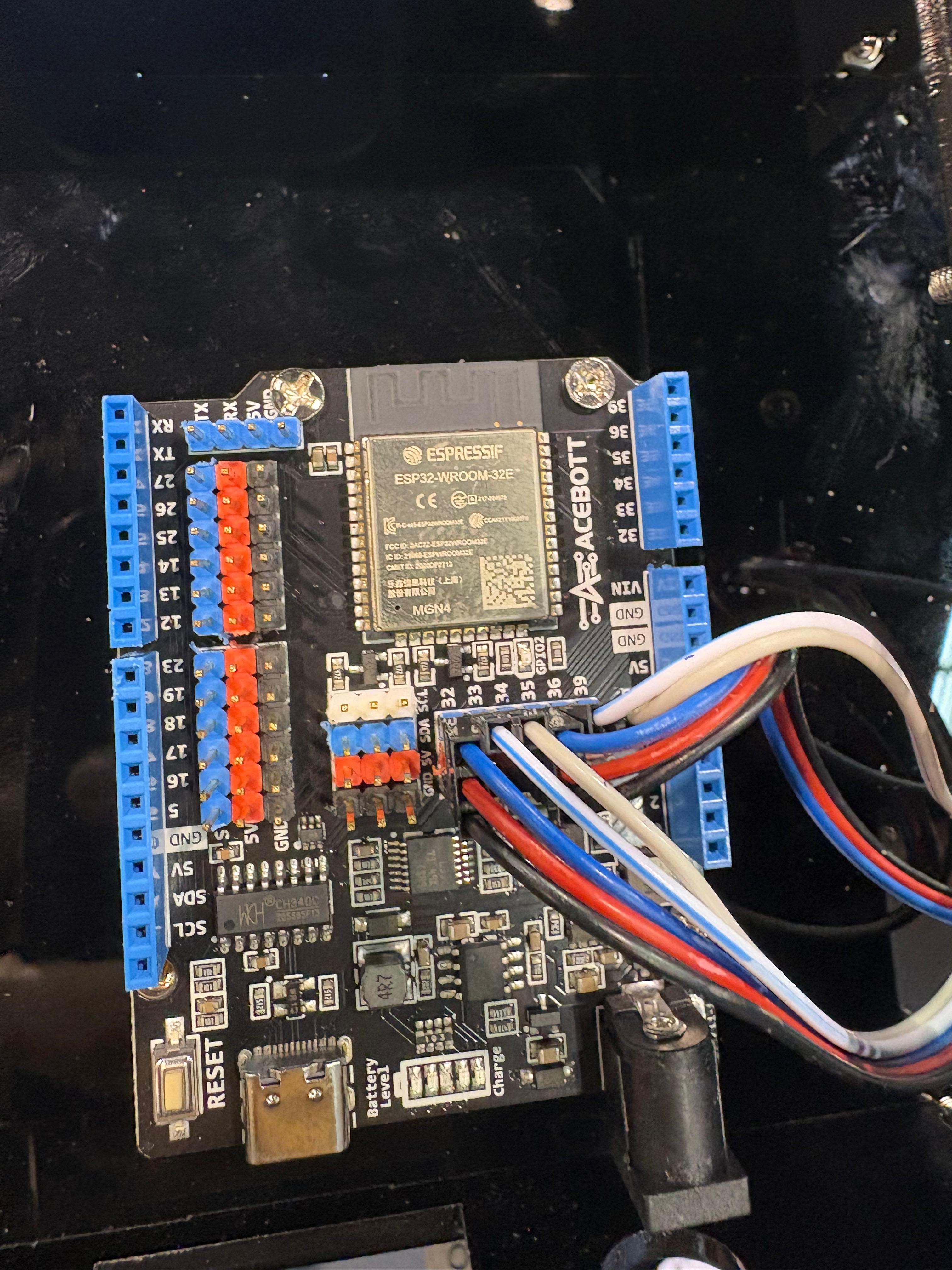

    Problems we hit:
    Buttons with no pull-up. ESP32 pins GPIO34/35/36/39 are input-only and have no internal pull-up resistor. Our joystick buttons read correctly only because the modules supply their own.
    Reset on connect. The ESP32 resets whenever the serial port opens, so the Python side waits 2 seconds before sending any command.

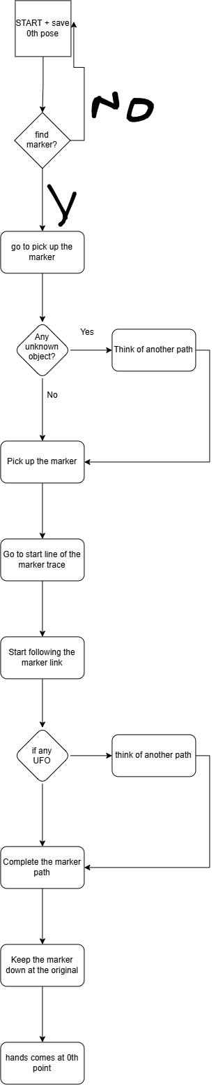

    Before touching hardware, we sketched the task as a flowchart (second attachment): find marker, pick it up, go to the path start, follow the path, put the marker back, return home. Our first key design decision came from that sketch. Our first draft had separate "find another path" boxes for the approach and for tracing. We merged them into one shared routine called Guarded Move. It moves in small steps, checks the camera before each step, and detours if something is in the way. Every movement the arm makes uses this one loop.
    Our first key decision came while drawing it. The first sketch had two separate "think of another path" boxes, one for the approach and one for tracing. We merged them into a single shared routine called Guarded Move. It moves in small steps, checks the camera before every step, and detours if something is in the way. Every movement of the arm uses this one loop, so obstacle handling works the same way in every phase of the task.
