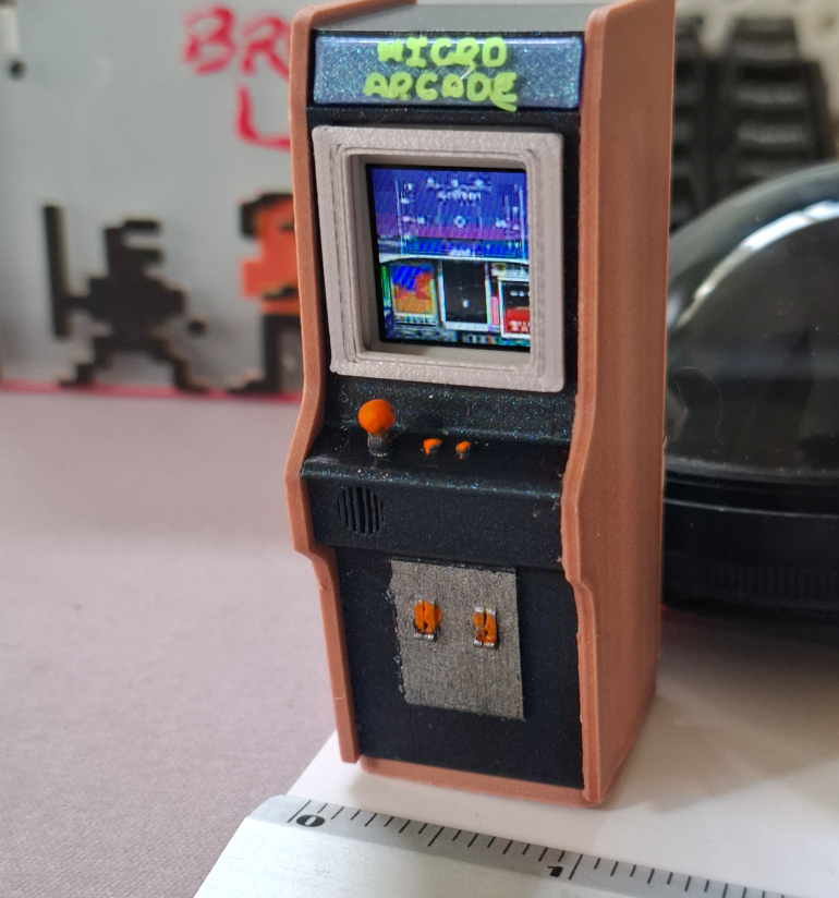

The cabinet is the demo. The point is the pipe. The board costs 15 dollars, and it's going in my daughter's dollhouse. https://youtu.be/D8STFnGjpT4
There was one dev board left on the desk I hadn't done anything with: an M5Stack AtomS3R. A capable little thing, but in earlier tests I kept hitting its limits fast. So I picked the laziest possible starting question. Can I get DOOM running on it.
Other people had already done this. I wanted to do it myself anyway.
But just running the executable would be boring, so I started reading what the board actually has. Natively, without touching a single GPIO pin, the AtomS3R has a 128x128 screen, a motion sensor, WiFi, and one button, which is the screen itself. Screen, input, communication. That's a terminal.
So I stopped trying to run DOOM on the device and started trying to run DOOM somewhere else and hand the device a picture.
That one decision is the whole project, and it took me until halfway through to admit what it meant. If the device only draws whatever arrives and sends back a tilt and a button, then it doesn't know what DOOM is. It doesn't know what any game is. DOOM was never the point. It's a dumb terminal at arcade scale, and the thing on the other end can be anything. It ended up being 28 games to play and a demo reel of 41, because the eXoDOS collection has more than 7,000 DOS titles sitting on my disk and a terminal doesn't care which one you pick.
The rest of this is how a 0.85 inch screen that computes nothing ended up being the best DOS arcade cabinet I own.

  • The case
    Juha Liljaan hour ago 0 comments
    Once the pipeline worked, the last problem was making it look like an arcade cabinet instead of a dev board on a table. I found Retromaker's arcade cabinet on Printables and modified it to fit. Printed the shell on my Prusa M4S, sides in wood-toned PLA, everything else black. It's small enough to hold between two fingers.
    Since it's a dumb terminal, there's no ceiling on what it could show. So Skyrim is in the demo reel too. Not emulated, obviously. It's a video, decoded on the server and streamed through exactly the same pipe, centre-cropped to the square screen. The device can't tell a recording from a game, which was the point from the start. GTA, anything, same story, so long as it's hooked up on the sending end. Old DOS games ended up being the best fit for what this cabinet is actually good at, though, so that's most of what's in it.
