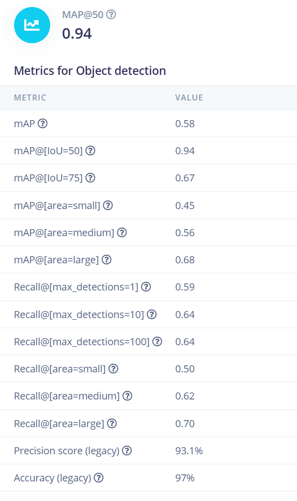

    • The model was trained on 450+ pictures of gestures in the three possible gestures (confirm, skip, stop/pause), and each gesture was captured in different parts of the frame, as well as various lighting conditions to make the model EXTREMELY robust, hitting a mAP@50 value of 0.94 across our validation and testing dataset, as well as remarkably good performance in the real world. (i spent way too long collecting data) [feature]
    • Despite being an image-only model, it recognizes fluid gestures (the swipe) with extremely high accuracy (in our tests, only ~1 in 10 even had a misclassified gesture at all) [feature]
    • It also has a secondary feature, where if necessary, the model will function (although not as well) with a secondary skip gesture with a thumbs to the side in place of the swipe gesture (in situations where doing a swipe might be hard due to weight) [bug wait no its a feature]
    • This took 11+ retrains, starting at a mAP score of ~0.5 at the very start and eventually reaching this monster [feature, comment]
    • Our model, when run on the hardware, runs at an average of 175 ms latency, which is well within reasonable bounds, given the requirement was "few hundred milliseconds". [feature]

    Now that the full pipeline is working, we’ve shifted our focus from simply “does it work?” to “how do we make it reliable?”
    Our current strategy is a fast, edge-case-driven iteration loop, and we’re trying to keep each cycle to roughly 30 minutes:
    Train → Deploy → Evaluate → Find failure cases → Collect targeted data → Retrain → Repeat 🔁
    Instead of blindly adding more data, we’re testing each newly trained model, figuring out exactly where it fails, and then collecting new examples specifically targeting those failures.
    Swipe Is Trickier Than It Looks
    One of the first things we noticed is that the swipe gesture contains a surprisingly large range of poses. During a swipe, the pointing hand can appear at many different angles and positions.
    Because we’re currently doing image-based detection rather than video/temporal detection, the model doesn’t actually understand the motion of a swipe. It only sees individual frames.
    That means our dataset needs to contain the different intermediate poses and angles that can occur throughout the swipe:
    Swipe motion → many individual poses → all need to be represented in the dataset
    This has become an important consideration in how we’re collecting training data.
    Swipe vs. Thumbs-Up Confusion
    We also discovered an interesting failure case: the model would sometimes confuse a swipe/pointing gesture with a thumbs-up gesture.
    Rather than just adding random examples, we deliberately collected hard examples containing both gestures in the same image—one hand performing the swipe/pointing gesture and the other performing a thumbs-up.
    After adding these examples and retraining, the confusion was significantly reduced. 🎉
    This was a nice validation of our rapid iteration strategy: find a specific failure mode, collect data that directly exposes that ambiguity, and retrain.

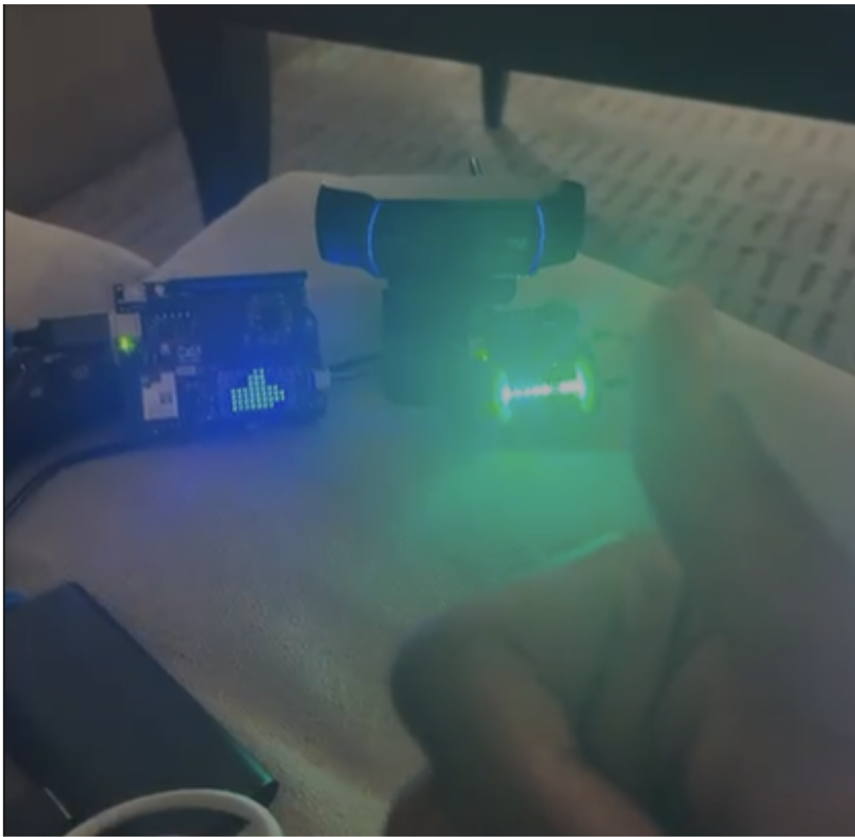

    Terek and I also wrote the response logic for each gesture. When the model recognizes a gesture, the UNO Q’s pixel array gives the worker immediate visual feedback:
    • Pause → triangular pause/stop symbol
    • Slide / Skip → rotating display animation
    • Confirm → thumbs-up display
    We did run into one problem: we didn’t have the USB hub we originally expected to use, so we needed another way to connect the computer and the UNO Q for tuning and debugging. We tried SSH, and it turns out to work pretty well! This gave us a way to remotely connect to the board, upload/debug our code, and iterate on the system.
    Of course, there was one more networking problem waiting for us: the public Wi-Fi blocks communication between devices on the network. 😭
    Our solution? Terek’s hotspot. Both the computer and UNO Q can connect to it, which lets us SSH into the board and continue debugging.
    So right now our pipeline is coming together:
    Camera → YOLOv5 gesture detection → UNO Q → gesture-specific visual response
    Demo!
    And we’ve got the hardware response working! 🎉
    In the demo below, the camera detects a thumbs-up / confirm gesture. Once the gesture is recognized, the Arduino UNO Q immediately triggers two synchronized responses: the LED pixel array displays a thumbs-up icon, while the buzzer plays a short confirmation tune.
    Thumbs-up gesture → YOLOv5 detection → UNO Q → 👍 pixel animation + 🔊 confirmation sound
    This gives the worker both visual and audio feedback that their gesture was successfully recognized—without needing to touch a screen.

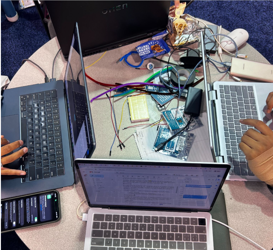

    Howie also found this example demo from Qualcomm about how to deploy AI onto this board.
    This is a picture of us working on it!
    Let's see how this goes! We're really excited to start working on this project :)

    GESTURE MUSIC CONTROL: QUICK START
    1. Power on the board and wait about 30 seconds for the app to start.
    2. Hold one hand up in front of the camera, about 0.5-1 m away, with good lighting.
    3. Make a gesture: - Thumbs up -> matrix shows a thumbs up -> music plays - Open hand -> matrix shows pause bars -> music pauses - Skip -> matrix shows fast-forward -> next track
    4. Hold each gesture briefly. The response comes about 0.2-0.4 seconds later.
    5. Lower your hand. The matrix clears after 1 second, and the music keeps doing whatever it was last told.
