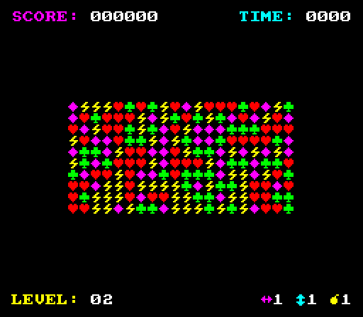

    My idea of the gameplay is to have a grid with a cursor to select the block, removing it and adjacent blocks if are the same type, using the flood fill algorithm. There would be a score, a time bonus which decrements each second, the current level number, and the powerups count.
    So far here's the display of what I currently have, I need to find a way of how to implement the flood fill algorithm in Z80 assembly, a win/lose condition, the powerups functionality and other things:

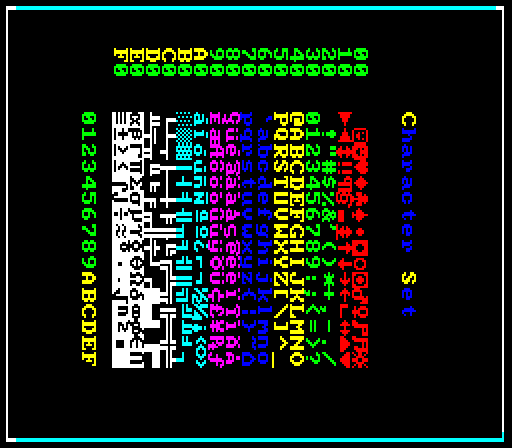

  • Color Display and Input Ports
    Louis Paul • 6 days ago • 0 comments
    So in the last few days I was implementing the text bitmap to show correctly on the landscape orientation, and figuring out how to read the coin port and input ports. For the color display, with a 256x224 resolution, I'm using a 8x8 basic font with no scrolling and no sprites, this means the text resolution is 32x28.
    It was a hassle to read the coin port, I had to disassemble the Head On 2 ROMs to figure it out, when you input a coin the arcade system is reset but the memory isn't cleared, so basically it's a warm boot.
    For the coin port first you need to check if the arcade system was cold or warm booted, then after a warm boot you need to assert the coin status, wait a set period, then read the coin port in 0x08 and mask the bit with AND 0b10000000.
    For the arcade button ports it was easier, you just need to read the input port, mask the bit with the AND opcode and check the bit. For example, to read the 1 player button you read the button port in 0x01 and mask the bit with AND 0b00000001.
    I have a Makefile to assemble the code, split the generated binary into eight files of 1024 bytes, rename the files to the correct names, and replacing the Head On 2 ROMs to run later on MAME.
    Showing the color display and reading input ports

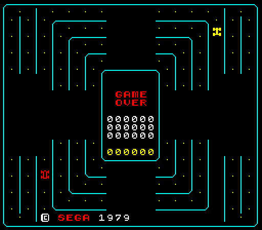

    One highlight I like to make is Head On, which has a "eat-the-dots" gameplay one year before Pac-Man. I'll use the Head On 2, a landscape color game to run my assembled output by replacing the ROM binaries.
    Head On 2 game running on MAME

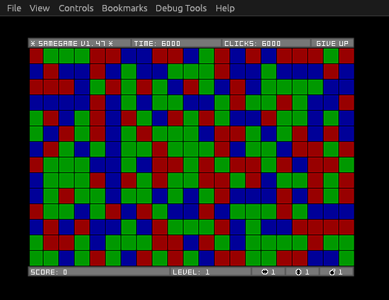

    For the game that I'll develop later on, it's a puzzle game called SameGame, it was created by Kuniaki "Morisuke" Moribe under the name CHAIN SHOT in 1985, it's played on a rectangular field with blocks placed at random, and the goal is to remove as many blocks as possible by selecting a group of two or more. I'll base it on the Flash game version by Jussi Kari, which contains power-ups:
    Samegame Flash version running on Ruffle

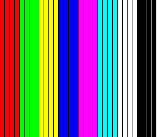

    To start working on the hardware I executed two test ROMs on MAME from the 8bitworkshop website, one example tests the color display and another tests the VRAM tiles (the outputs are rotated because the test ROMs were designed for portrait output):
    Testing the color display (Source)
