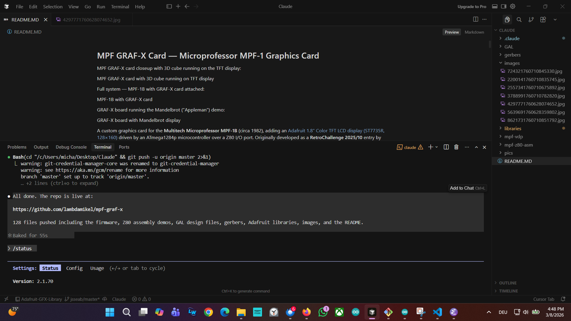

Update: Claude Code Sonnet 4.6 created the README and GitHub repo for me:
https://github.com/lambdamikel/mpf-graf-x?tab=readme-ov-file

  • GitHub Repo Online - Thanks to Claude Code Sonnet 4.6!
    Michael Wessel03/08/2026 at 23:49 0 comments
