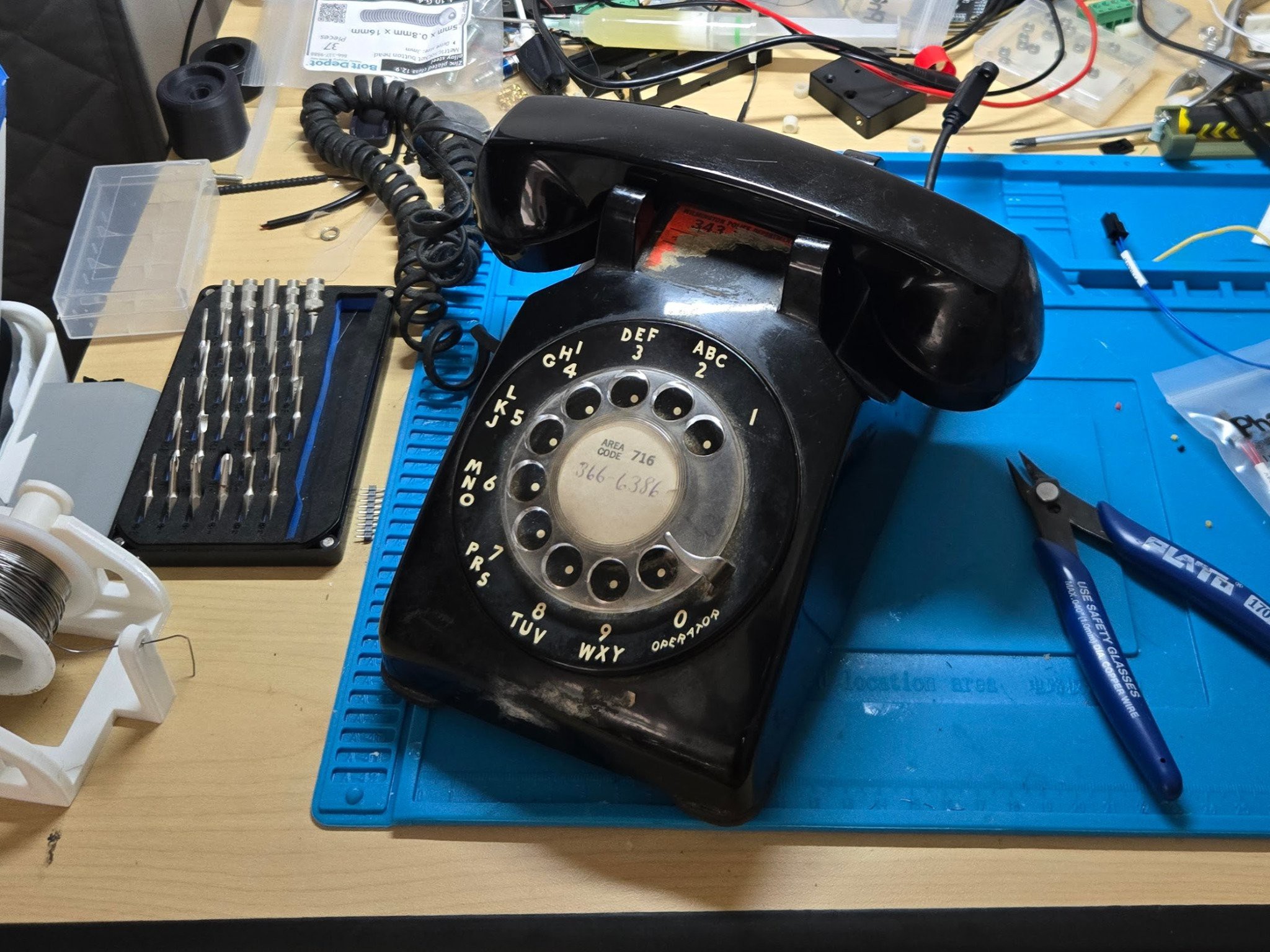

RotaryCell converts a Western Electric 500-series rotary telephone into a self-contained cellular phone while retaining its original dial, handset, switchhook, mechanical bells, network block, wiring, and case.
A LilyGO ESP32/LTE board handles cellular service and a Silvertel AG1171 interfaces with the telephone’s original analog circuitry. Two custom PCBs provide audio conditioning, control, and hardware modem reset. The conversion runs from a rechargeable 21700 cell, charges through USB-C, and requires no drilling or cutting of the telephone.
The firmware, PCB files, printable mounts, wiring diagrams, bill of materials, and complete illustrated build guide are all publicly available.
What is RotaryCell?
RotaryCell is a reversible internal conversion that gives a traditional rotary telephone its own cellular connection. The finished phone operates much like it originally did: lift the handset for a dial tone, dial with the rotary wheel, and answer incoming calls when the original mechanical bells ring.
The design preserves the original dial, handset, switchhook, network block, ringer, wiring, and case. The added hardware fits inside a Western Electric 500-series telephone without drilling or cutting it.

  • From hand-wired prototype to documented PCB build
    Carl F. • 2 hours ago • 0 comments
    RotaryCell began as a hand-wired, one-off conversion. That prototype proved the core idea: an ESP32 and cellular modem could read the original rotary dial, place and receive calls, operate the handset, and ring the telephone’s mechanical bells through a Silvertel AG1171 line interface.
    Getting it to work once was only the beginning. The loose wiring made the prototype difficult to reproduce, inspect, or repair. It also left little room for additions such as reliable modem recovery and controlled power saving.
    The current version replaces most of that point-to-point assembly with two purpose-built circuit boards. The AG1171 carrier handles the telephone interface and its through-hole components. The Audio/Reset A4 board handles adjustable audio conditioning and includes a hardware power-cycle circuit that the ESP32 can trigger if the cellular modem becomes unresponsive. Custom printed carriers secure the electronics inside the phone without drilling or cutting its case.
    Several complete PCB-based conversions are now operating. The current firmware supports the new hardware, including modem reset, AG1171 power control, maintenance Wi-Fi, browser-based diagnostics, event logging, and web firmware updates. A 5330 mAh 21700 cell provides roughly two days of typical operation.
    The other major task was turning my notes and development photos into instructions someone else could actually follow. The resulting guide now covers sourcing, PCB ordering, printed parts, wiring, firmware, installation, adjustment, and final testing.
