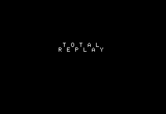

  • Log 10: The Proof is in the Puddin'
    Jorj Bauer • an hour ago • 0 comments
    It's exciting weekend time here at Bauer Labs!

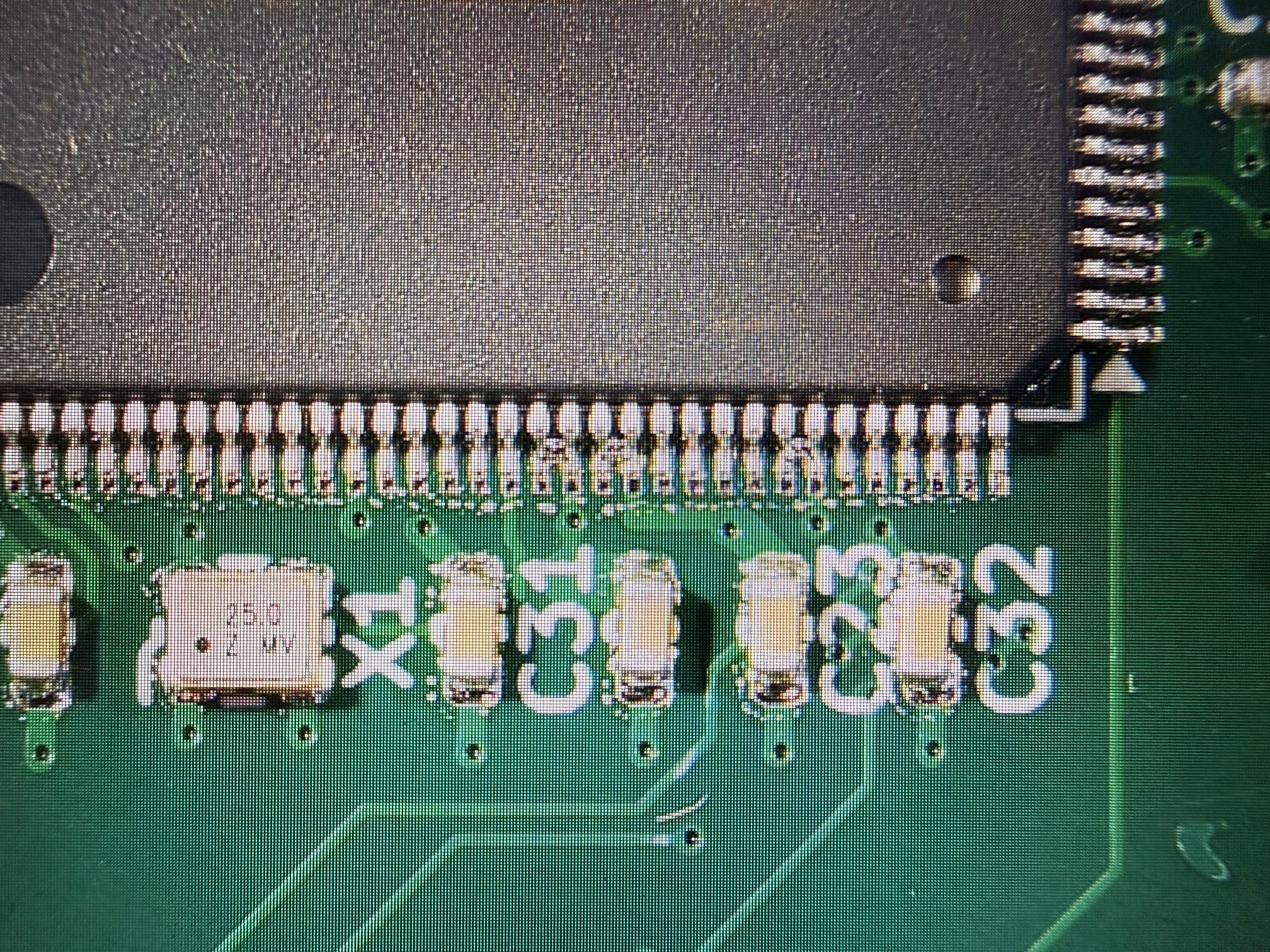

    A pile of PCBs has plopped itself upon my bench thusly...

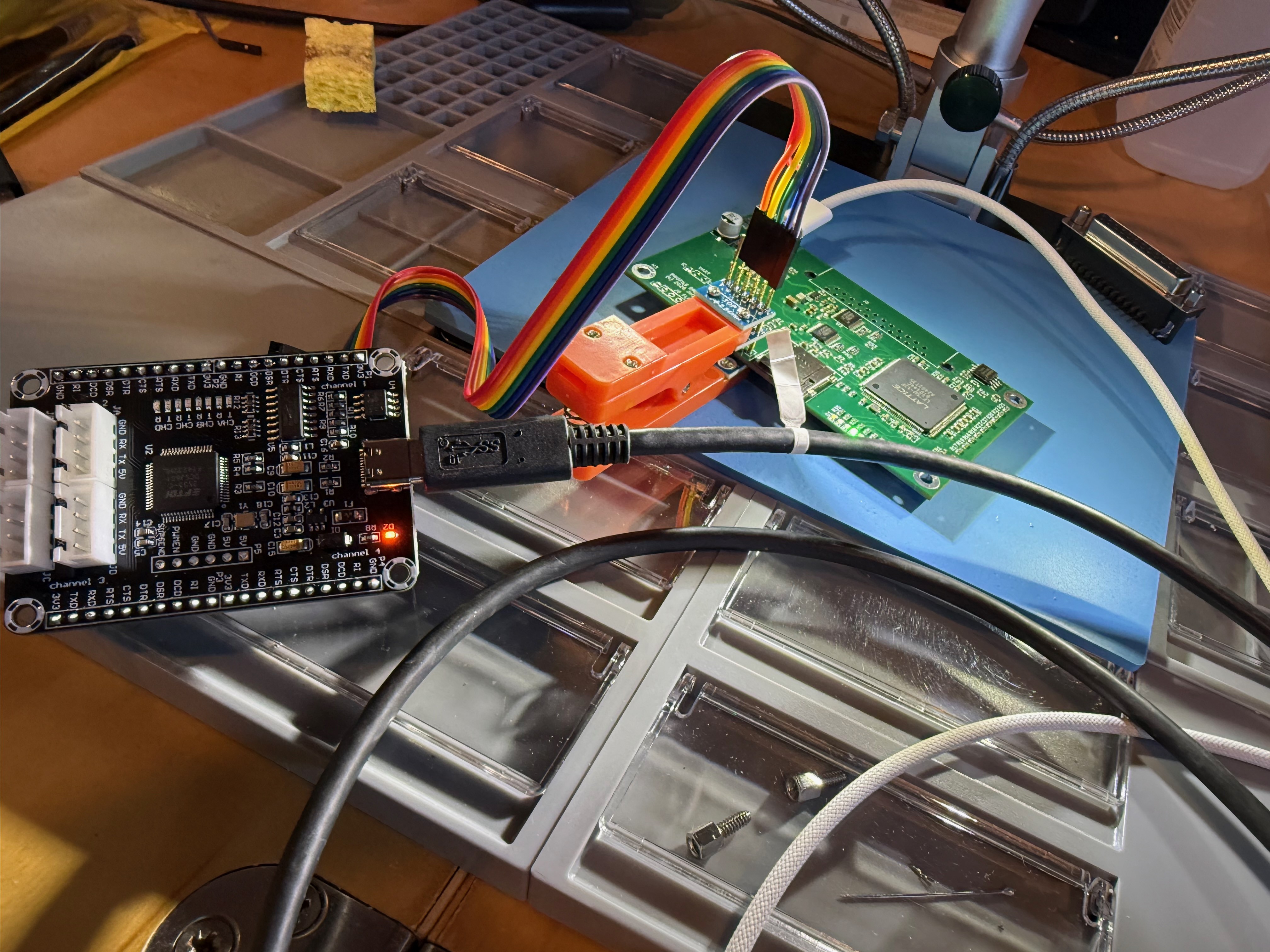

    which, after my toaster-oven-reflow treatment, had a few solder bridges that needed removing...
    And then a bit of programming...

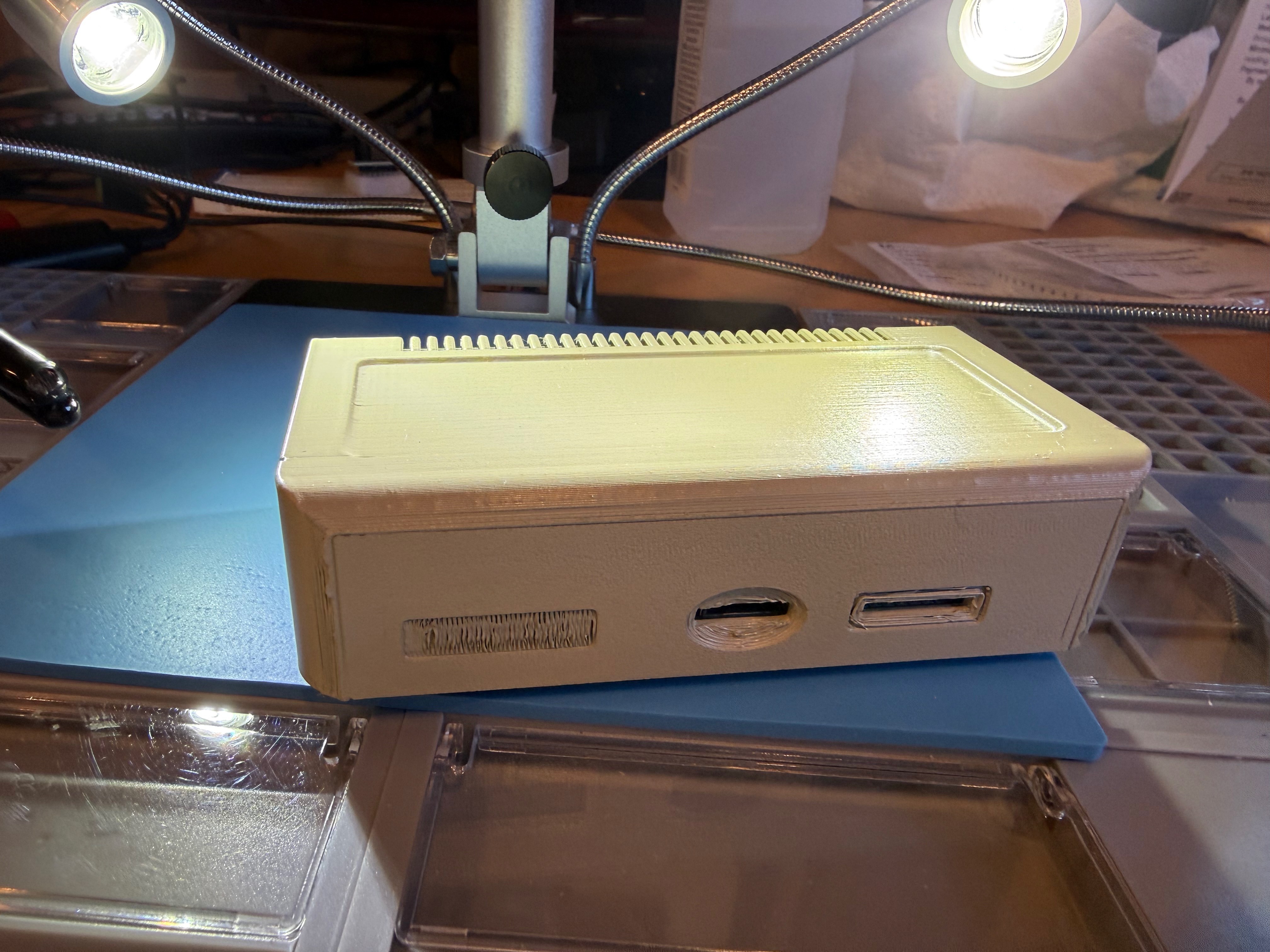

    A tiny bit of case painting (yes, I could have sanded it down a little, but I'm impatient!)...
    and voilá, Bob's your uncle.

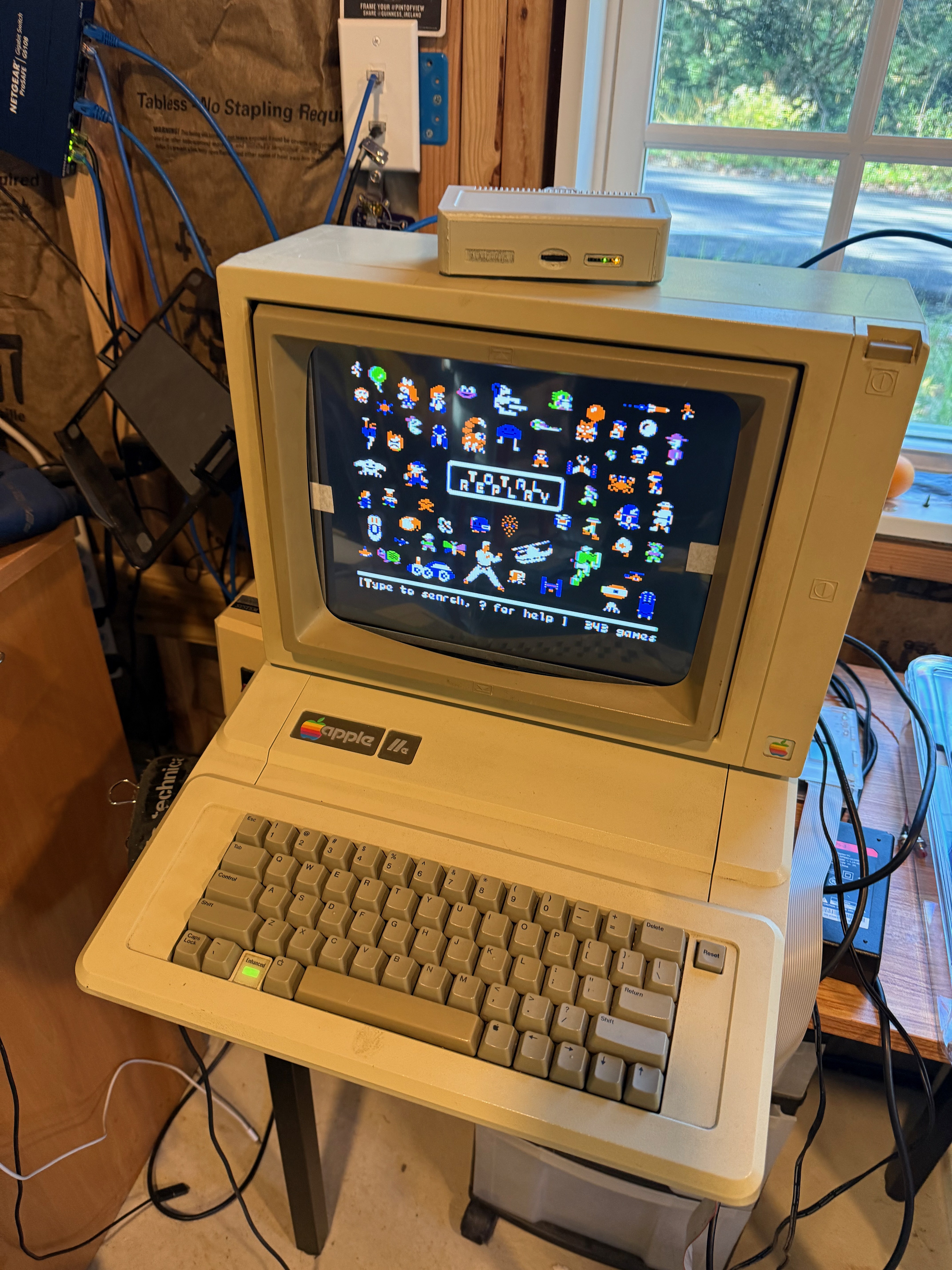

    Fully buttoned up:
    I'm in a little bit of disbelief here. This has been a six-year journey of learning about FPGAs to get to the point where I could design and build this thing. I had no idea that I'd be able to support multiple boot images using the stock ProFile interface card; or that I'd be able to mount multiple volumes at the same time from ProDOS. Nor that I'd be able to support full 32MB volumes. Heck, I didn't even know that I'd be able to wrap my head around FPGAs.
    But here we are.
    The last piece for me to do is publish all the code, which I'll be doing shortly; I just need to clean up the repo (there are hundreds of useless artifacts I'm not going to pollute the world with). Look for a link in the project description to my github when it's done. The schematic, code, and case STL should all be there in the near future...

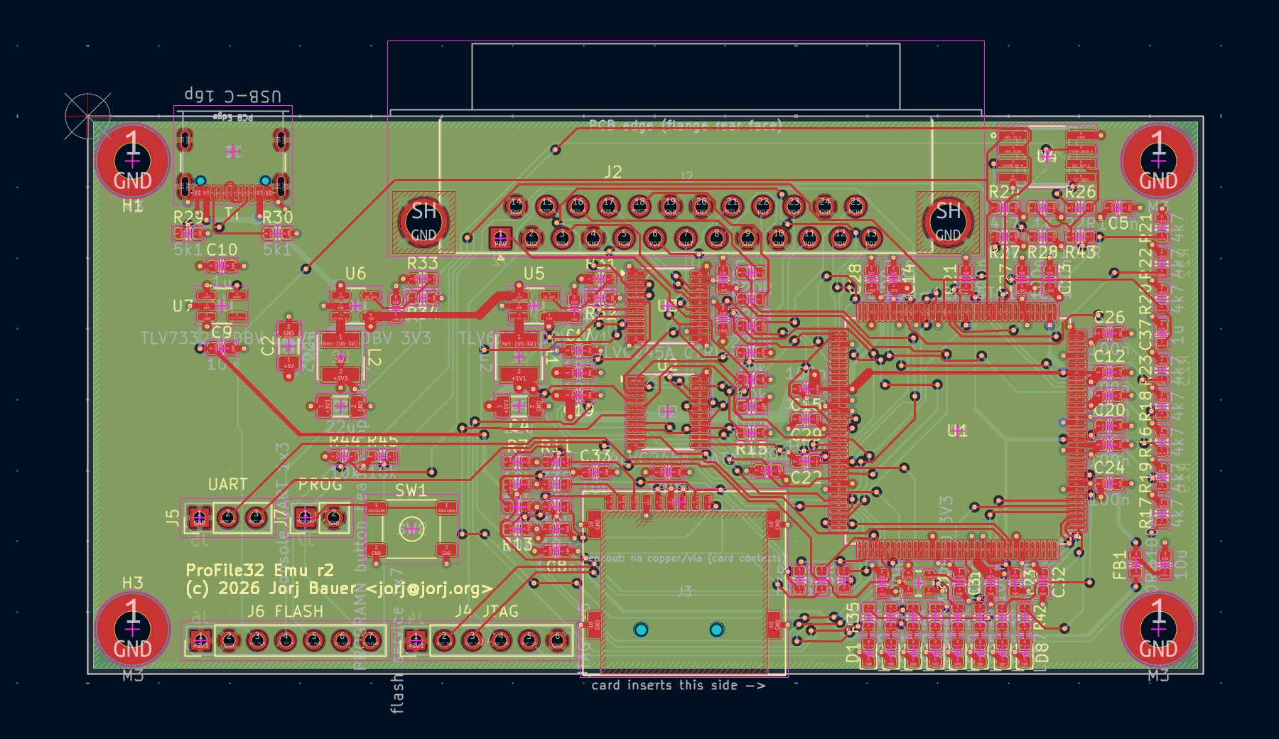

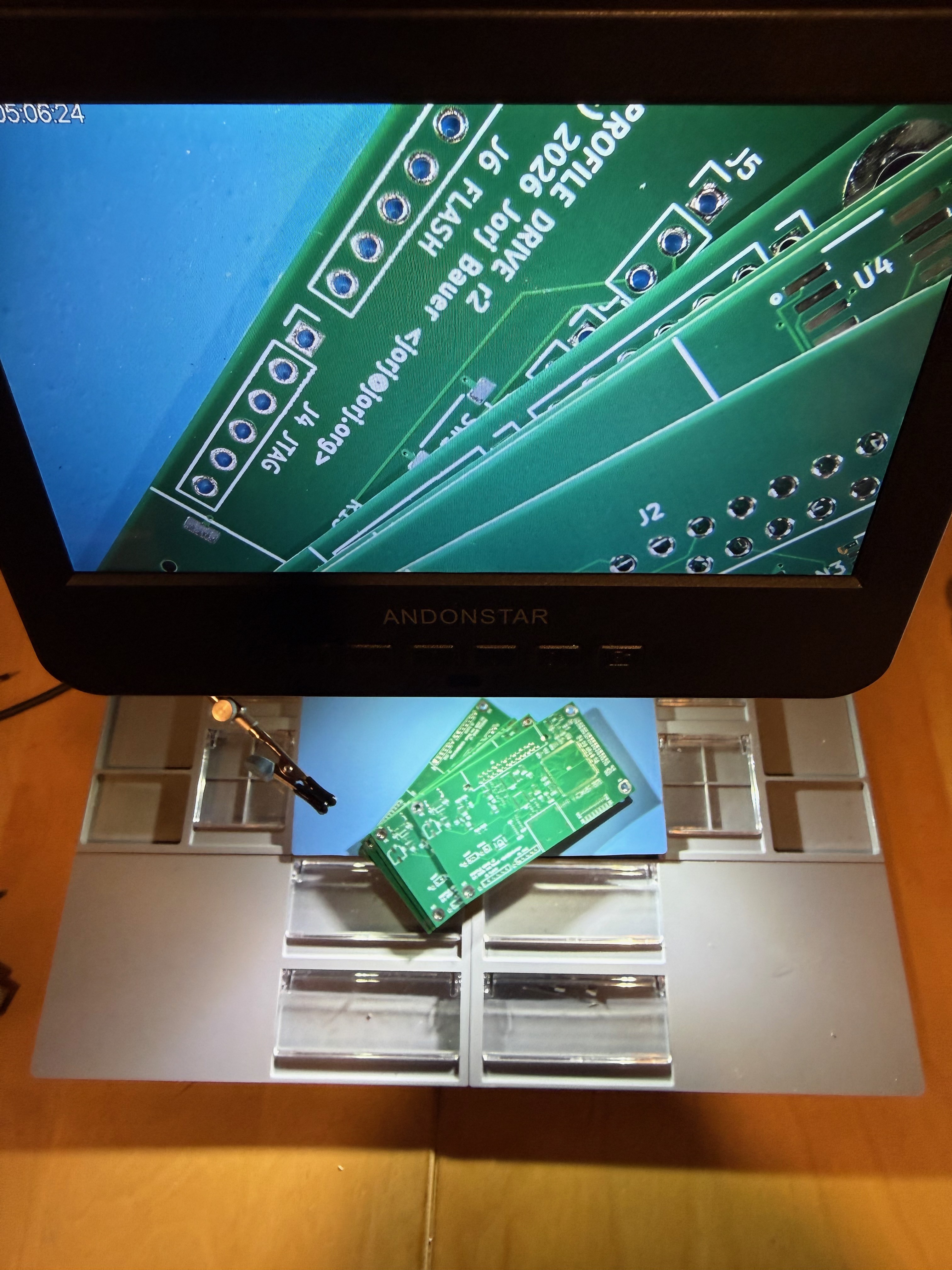

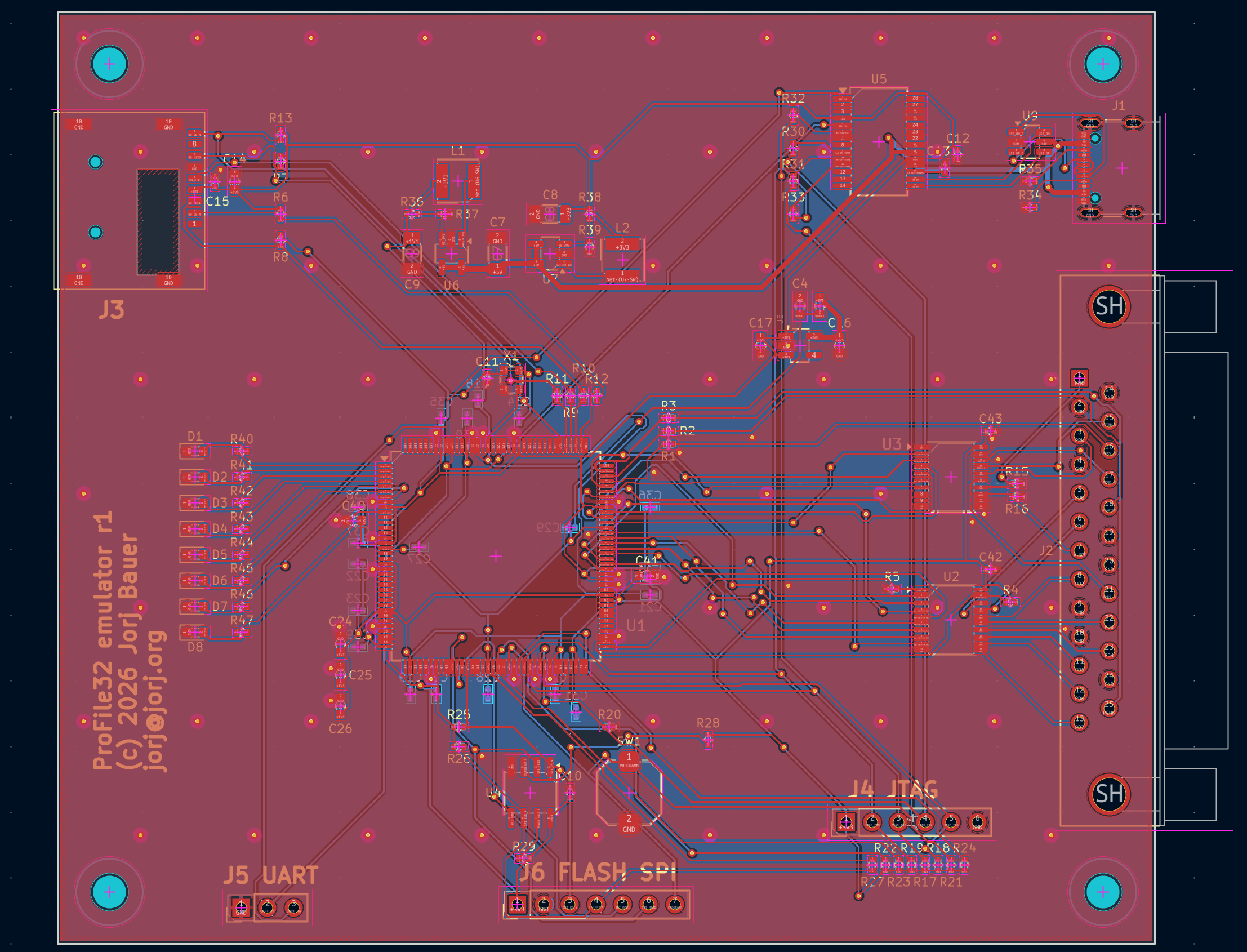

    Obviously, I'm prepping the r2 board. Here's where I am so far; still a few bits to clean up...
    The r1 board was large and spaced out intentionally; more room to repair errors. Now it's time to crunch it down.
    And while I'm smallifying the board... I'm biggifying the parts. I'd never worked with 0402 size parts before and, while I did manage to get it all working, it was not exactly fun. So we're back to 0603 here; unless I have need to shrink down more, I see no reason to use the little beasties I can barely see, and easily fling around the room accidentally. (The R3 lesson from my r1 board is really what made my mind up here: I dropped a 220 ohm resistor, picked up another resistor that was right there that I thought was the one I dropped, but it was a 10k.)
    I've also dropped the parts I never used - the USB-C JTAG driver and all its support electronics are gone. I left in the LEDs because LEDs are cool, but they can be left out in a final build. As can the flash and jtag headers. I'll just need some way to initially program the flash (maybe an SOIC adapter, program them before they're even on the board).

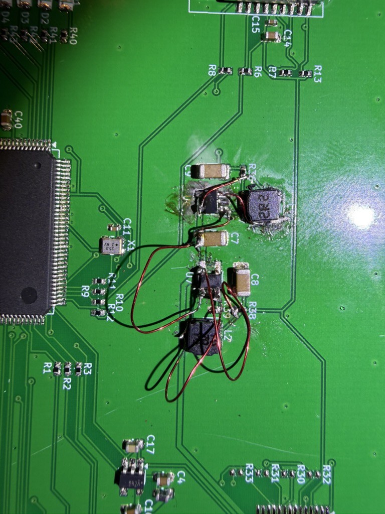

    The buck regulator pinouts are corrected; I've changed the footprint for SW1 to match what I've got sitting around; added a few passives to correct missing pull-ups that should make the flash more reliable, and stub terminators where the leads continue to an unpopulated header.
    One thing I have to give up here, though: I really like having all the part labels right next to the parts. I've packed a lot of parts in places where I can't necessarily do that... so they're all on the back.
    I also want to address a minor noise issue here. I've always been able to hear high frequency noise - like flyback transformers in CRTs. I've lost some of my hearing but that's never faded. Consequently, I was not surprised to hear the buck circuits doing their thing. For those that don't know how they work: high efficiency voltage converters work by rapidly turning on and off the supply, storing energy in magnetic fields and converting it back to electrical supply in a carefully timed dance. The frequency at which it switches on and off is usually very high, so that we can't hear what it's doing - something in the MHz range, well above what any animal can hear. But some parts (and, notably, the parts I picked for r1) do their best to be ultra-efficient; if the demand for current is not high, then it falls back to a much slower speed to save power. In this case, the TLV62568DBVR normally runs at 1.5 MHz and absolutely drops to something I'd estimate at 16kHz. Which is undocumented (the frequency, that is; the behavior is well documented as a power saving measure). There's no way to tell it to not do that, and it is very annoying. So we'll switch to the TPS62A01APDDCR - this is a forced-PWM-mode device that does waste a few extra mA of power, but should stay at its 2.4MHz switching speed so that we don't hear it. (Okay, so that *I* don't hear it.) The cost? Well, I've got a few of the old parts that will now do nothing. Some new inductors and resistors. And overall? It's actually cheaper, by about $1.34/board.
    In a couple weeks, we'll see how the r2 PCB fares. And in the mean time, at least I've replaced the pile of boards and adapters with a single bodged-together PCB!

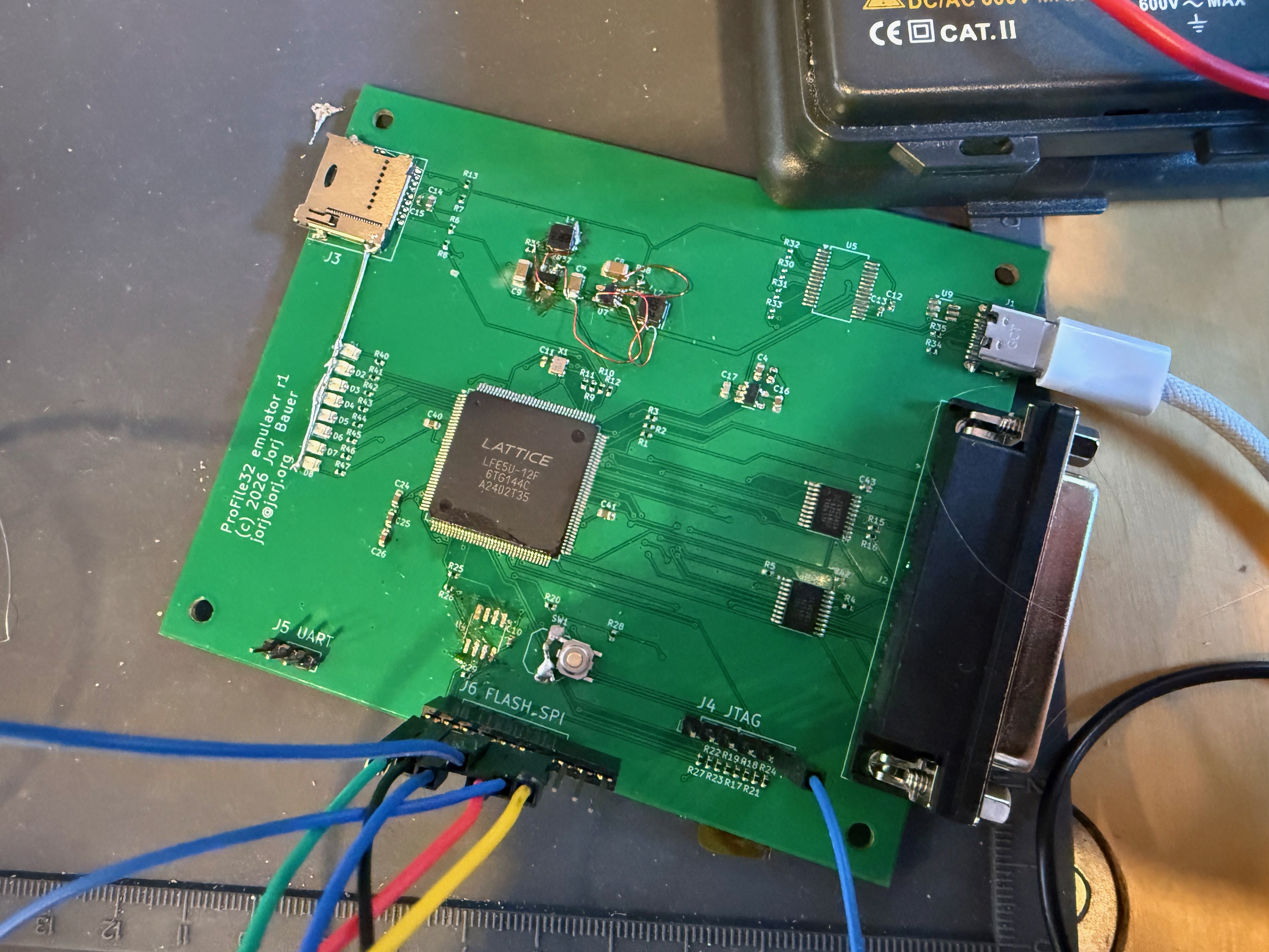

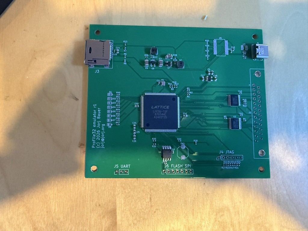

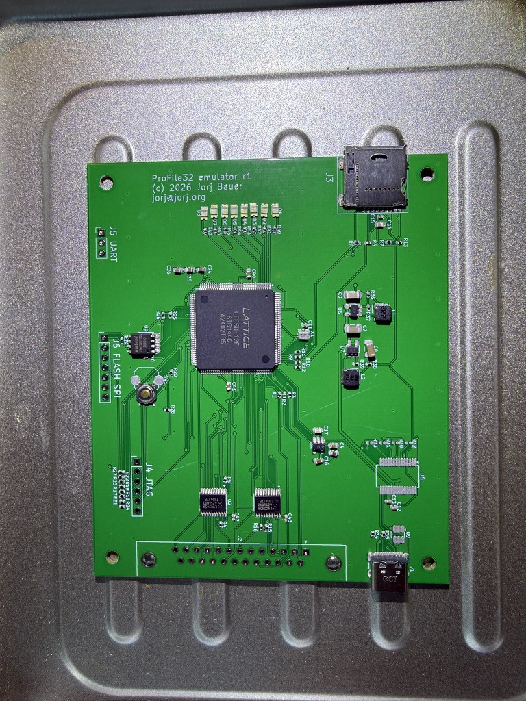

    Well here it is, the r1 prototype 2-layer PCB.I opted to take some risks: 0402 parts (look under "J4 JTAG" - those little black dots are 0402 resistors) and to err on the side of caution in other places (the TQFP-144 FPGA is a compromise: fewer pins, but I avoid BGA).
    What you're looking at here is just after the solder mask was squeegeed and most of the important parts have been placed. Notably absent: U5 in the upper-right, although I did fit most of the support parts in case I put it in later; SW1 down bottom-center; and a bunch of LEDs on the left, D1-D8. I picked out some spare LEDs and a random surface mount switch before reflowing the board - but that U5 part was very much "just in case".
    Just in case of what? Just in case I couldn't figure out how to program it. There are three paths on this board to programming the flash chip - most obviously J6, the "FLASH SPI" port; then the J4 JTAG port, to have the FPGA itself program the flash; and lastly, a direct serial JTAG connection through USB-C, which is also supplying power to the board.
    I was certain that the USB-C serial path would be one I tear out for r2 of the board, once I understood how it all worked. And that turns out to be true - I didn't need it, and it's not moving to the next revision. But it was touch and go for a while.
    Now, I"m a toaster-oven-reflow kinda guy. I've never made anything big enough where that's a problem; I don't even have temperature sensors in the oven. I use low-temp solder and, by hand, preheat (soak) the PCB below the melt temperature before cranking it up to melt-temperature and then cooling it back off. I've made hundreds of PCBs this way - all small, about 6" x 3" or smaller. But this relative behemoth, with its large TQFP-144 FPGA, I had no idea how it would go. And the answer would be "poorly."
    The board is large enough that it heated unevenly. Even with a long soak period, I had inconsistent melting of the solder; I wound up reflowing it a second time, rotated 180 degrees. And even then some of the solder joints on the FPGA looked a little rough. But no matter; it passed basic inspection for shorts and conductivity, which just left the question of "did I accidentally fry anything."
    Not as such. Which doesn't mean it worked. But it also didn't explode, which I'm taking as a win.
    Let's start counting the errors, though. Some are simple - the registration holes under the MicroSD card were in the wrong place, so it doesn't sit flush and doesn't have all the mechanical strength it should really have for a part that has something pushed into it. Easy enough to fix in the next revision, and doesn't really stop me from using it in r1. And I missed connecting the DB25 shell to ground, which is inconsequential here but weird.
    Then we have the actual "it can't work that way" errors. The easier ones: the footprint for the SPI flash is for a narrow JEDEC SOIC-8, where I've got a wider part (EIAJ 208 mil). Half the pins made the pads, and the other half did not. The LEDs I picked had the same problem; wrong size footprint. Not a huge problem but ones I would have preferred to deal with before the first reflow. A little wire down the edge solves that one.
    Worse: somehow, I completely bungled which pins were on which pads on two parts. This FPGA is a low-voltage part, and as such needs three voltage rails: 1.1v, 2.5v, and 3.3v. The buck regulators I used for 1.1v and 3.3v? Yeah, that's gonna leave a mark:
    Not pretty, but it works.
    And lastly we have the "that's... not great" errors. When the FPGA boots, it needs the flash to be ready at precisely the right time. And if you press the reset button it needs to make sure the button doesn't cause multiple different presses through the cycle. Both of those are solved with an extra 1uF capacitor across the switch. And all of that leads to this fun version of the PCB:
    Now, you being the astute, detail-oriented reader that you are, may have noticed that the flash chip is now missing from the bottom of the board,...

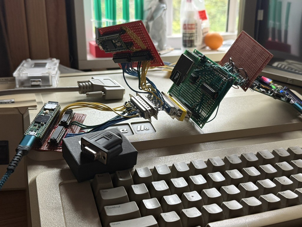

    This emulator isn't running on a Teensy 4.0.
    Yes, it started that way; the hacked-together prototype used for debugging, which was useful through the proof of concept that I was, indeed, emulating a ProFile. But it had some timing issues and rather than pushing the brute-force "my CPU can out-CPU your CPU" race, I decided to take the more robust path.
    It's on an FPGA, carried on a commercially made PCB, built so that anyone can build their own.
    My first pass was on an Alchitry Cu dev board - which I quickly outgrew, and moved up to the Alchitry Au. Overkill, but functional.
    Then I rebuilt it on the ULX3S-12F, which meant building another adapter in the middle to keep the wiring I'd built for the Au. Not pretty, but functional just the same (shown here with my bus sniffer in the middle of the wiring, and the original Teensy ProFile reader on the left).

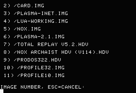

    Yes, I built it - specifically for ProDOS, it's possible to hot-swap volumes. And something more that I'll save for the end.

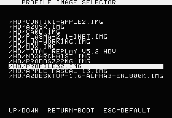

    ... performs the knock, checks that the returned data looks like it should, and then runs the same picker menu that the bootloader uses. Boom - in-OS, runtime, re-selection of what drive is connected.
    That's great if we're doing it by hand, but the actual use case I have is: moving files between two images. And to do that, it needs to be automated in some way. ProDOS really isn't command-line-ish, but how close can we get?
    This is an excerpt of PICK, a binary that performs the knock, transfers file names from the emulator as data blocks, prints them onscreen, takes input to choose one of them, and then performs the swap.
    After the knock, the info block ($FFC0) gives a count; and each catalog page ($FF80 + (idx>>3)) is an ordinary 512-byte block payload with 64-byte records. Those records were cached by the emulator at its startup, so there's no extra overhead; it's just data transfer couched in special terms, overloading block numbers near the end of the device within a short time frame. Wait too long and you get the normal disk block instead.
    Great; I can now...

    From my ProFile 10MB reader project you can see where I started: a 10MB hard drive and Apple //e which did not want to talk with each other. That reader was the "divide the problem in half" project: is the failure the drive, or the interface card in the Apple //e?
    It was the card.
    And having passed that hurdle, the next question was: can I repair the card?
    In 2021 I did a brute force IC replacement of all of the components I could easily source, just as a "if this fixes it, fine, I'm done" - but it didn't. So I swapped the components back out, put the whole lot in anti-static bags, and shelved it as a future project.
    But here in 2026 it *is* the future! How lucky.
    Now, I had no idea how I was going to find the problem; and once I did find the problem, I wasn't sure what I was going to do with the card. A ProFile card is a rare thing to have these days and it's compatible with precisely one line of hardware that has precisely two choices of what to connect to it. And while I've got the bigger of them - my whopping 10MB hard drive - I also know from my 2021 work that the drive is magnetically failing. The blocks are being spared out every time I spin up the drive.
    Right. First things first: "what will I do with it once it's fixed" is a yet further future problem (for which you probably know the answer, given the title of this project). The one to focus on right now is: how do I find what's wrong?
    Let's list the issues.
    1. It fails to boot the ProFile, but the drive works well enough to suck its contents out via custom hardware.
    2. I don't have a schematic. The best that exists is the Apple ProFile service manual which helpfully includes the schematic for the Apple /// interface card (p. 247), but not for the Apple ][.
    3. I don't know how it works. Even if I had the schematic, I'd need some way to tell that behaviors are or are not in line with expectations. I know the protocol now, sure - my dumper proves that - but exactly how the interface card performs its magic and how that interfaces to the operating system is, as I start, unknown to me.
    And the assets.
    1. I have the card, inserted in a working //e.
    2. I have the ProFile - but it has developed a hard short on its logic board, so I'd have to repair it in order to use it directly.
    3. I have my ProFile reader and the other variants I built during that test cycle: a bus sniffer that sat between the ProFile reader and the drive, very useful while I was trying to understand the protocol; and a ProFile emulator, which I never quite got fully working but did use for some testing in order to limit how many times I needed to turn on the ProFile 10.
    A lot to unpack, but this feels very tractable.
