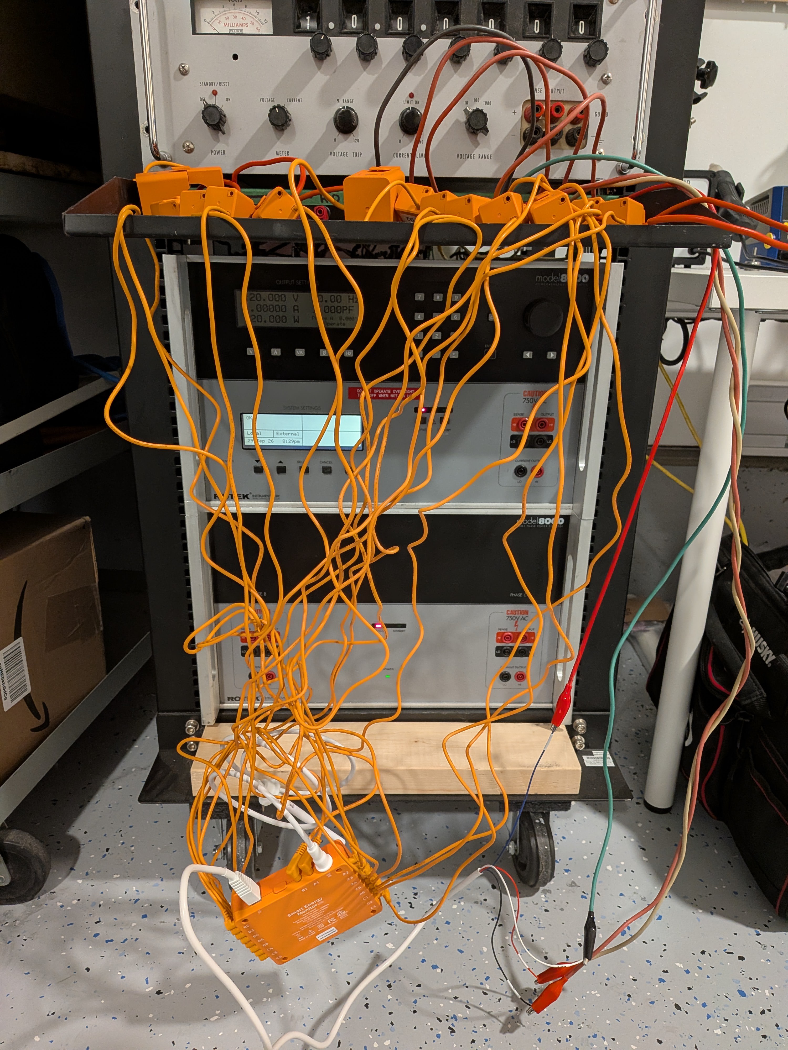

To verify this ±2% claim, I’ll be looking at instantaneous readings of voltage, current and real power, while varying one of voltage, current, power factor, or frequency.
These so called “accuracy sweeps” will include the following test points…
| Sweep Type | Current [Arms] | Voltage [Vln] | Power Factor | Frequency [Hz] |
| Test#1 - Current | 0.01 - 20 | 120 | 0.999 | 60 |
| Test#2 - Voltage | 1.0 | 100 - 240 | 0.999 | 60 |
| Test#3 - Power Factor | 1.0 | 120 | -0.999 - 0.999 | 60 |
| Test#4 - Frequency | 1.0 | 120 | 0.999 | 50 - 60 |
My reference is only rated for 20A, and most of the circuits the EM16P will measure are 15/20A anyhow. The voltage sweep is limited by the power supply of the EM16P, and same goes for the frequency sweep.
