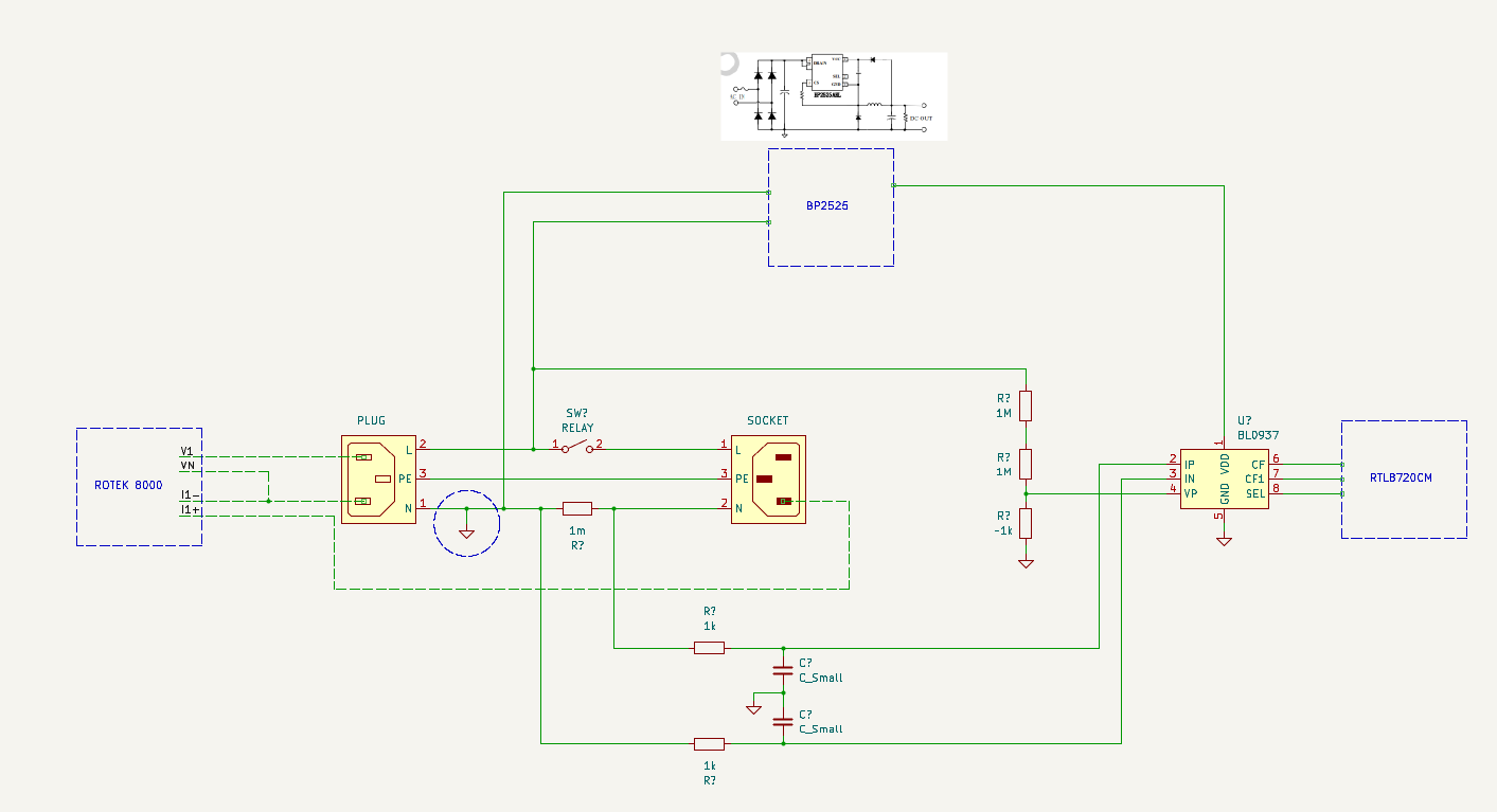

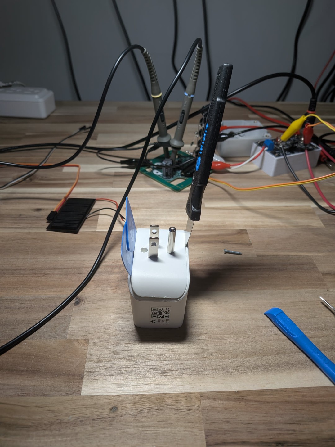

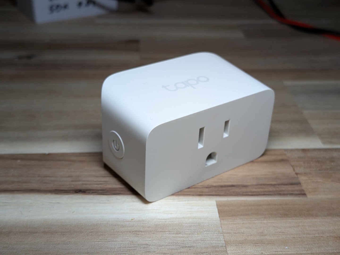

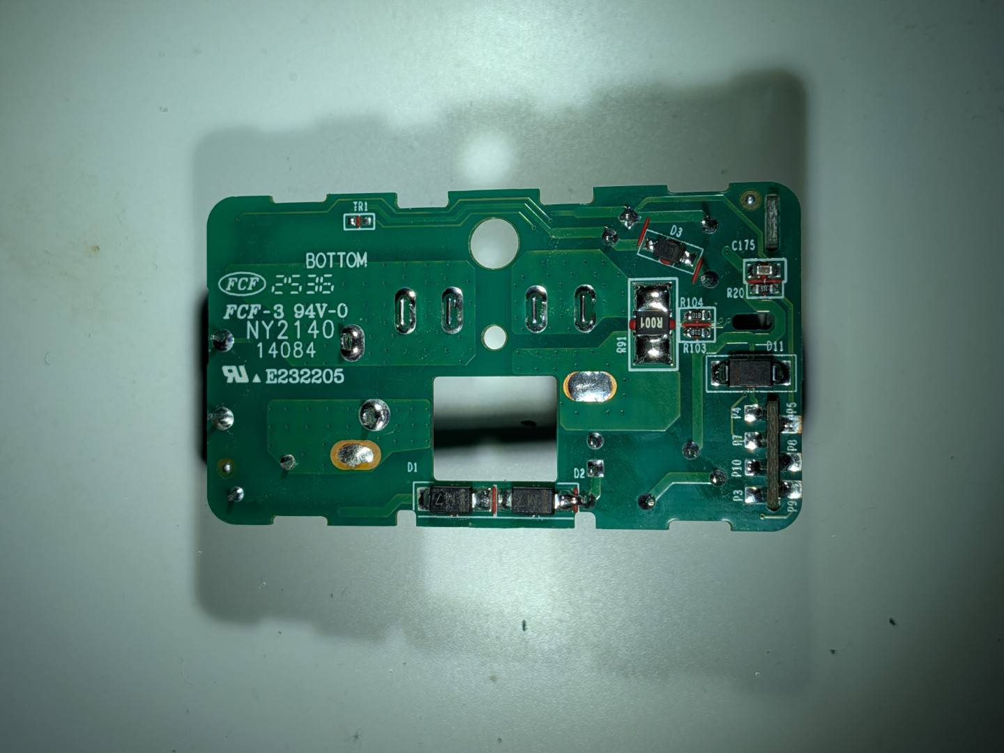

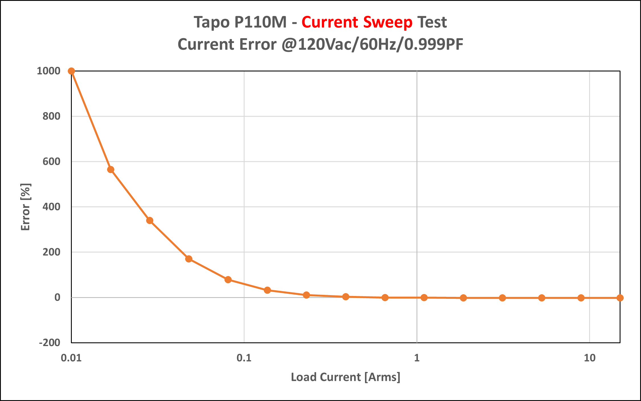

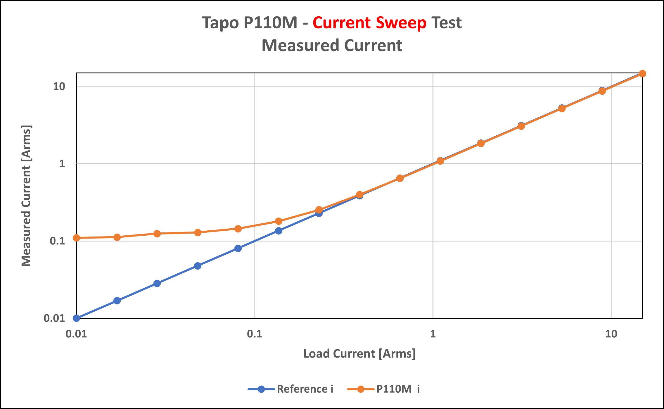

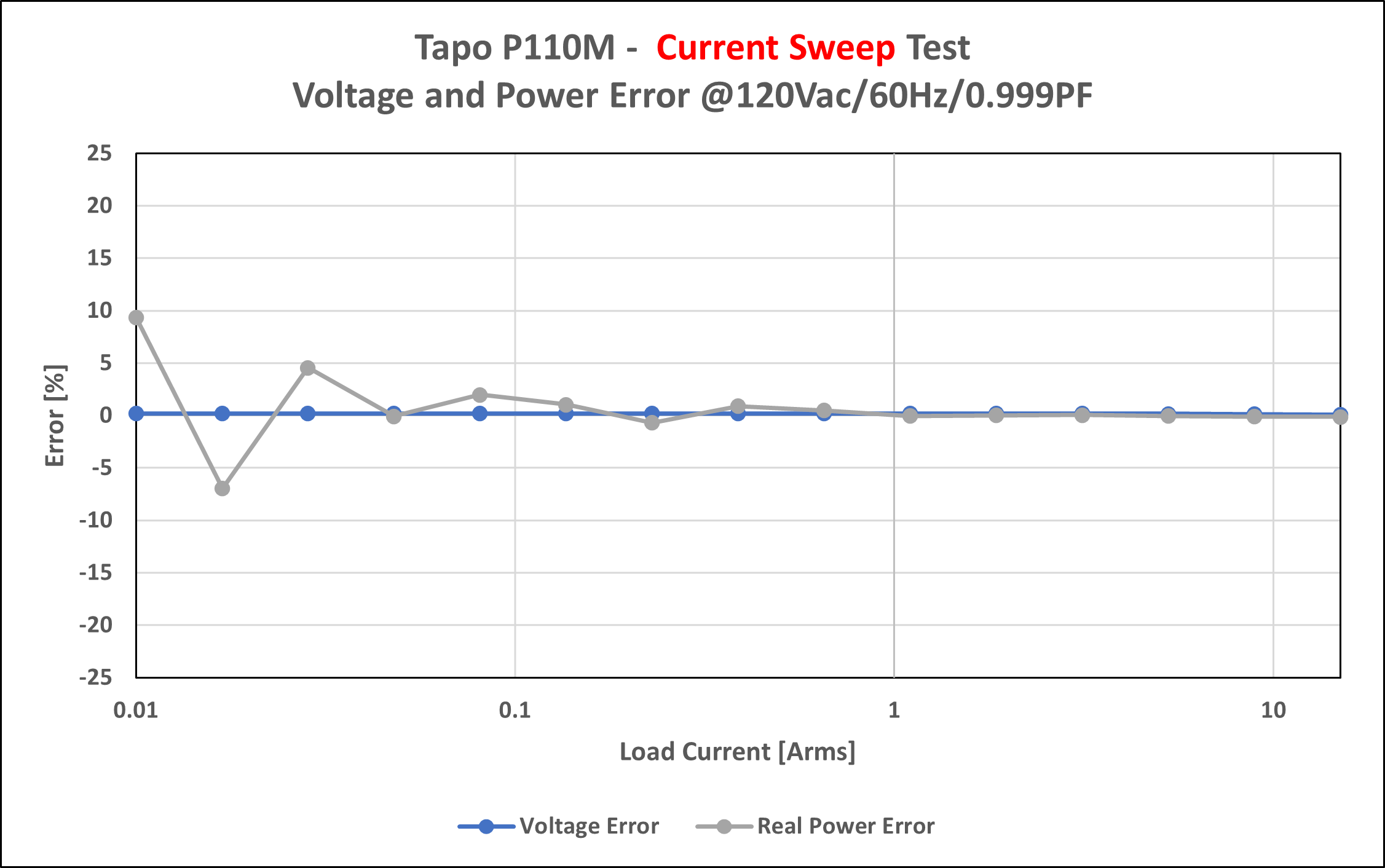

Tapo P110M - Accuracy
05/18/2026 at 17:23 • 0 commentsRefer to project page -> https://hackaday.io/project/205662-tapo-p110m-accuracy
TLDR - Reported power and voltage are reasonably accurate. At low power current is inaccurate.
