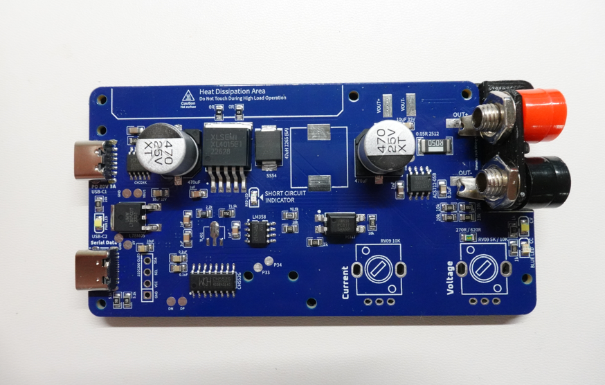

    Design & Send PCB to Print
    First, you might want to send the PCB to print. The PCB files can be found over here
    https://github.com/tobychui/PD-Adjustable-DC-Power-Supply/tree/main/PCB
    I am printing it with 1.6mm thickness and in white color just to make it easier to debug. But you can pick any color you want.
    Usually, when designing a PCB, people will start with a circuit diagram of some sort, but since this project is quite simple and I am busy unpacking my stuffs, so I just hand drawn the circuit diagram with MS paint (see the last attached screenshot) and start the PCB design. It turns out quite well though?
    Btw, this is what I got after the PCBA done by PCBWay, and I got it installed to the 3D printed base I made in next step.
