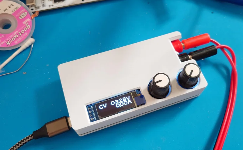

Btw, this is what I got after the PCBA done by PCBWay, and I got it installed to the 3D printed base I made in next step.

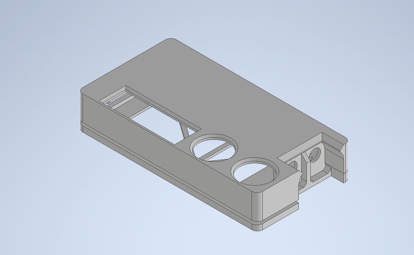

Design & Printing the Case
After sending the PCB to print, you can start working on the case as the PCB printing is gonna take a while. After some 3D modeling and test-fitting, I created the v3 of the case (note the case versioning differs from the PCB).
After the design is done, you can start printing it with your preferred printer. I am using white PLA here but I guess if you got a 3D printer that can print ABS, that would be better for this application.

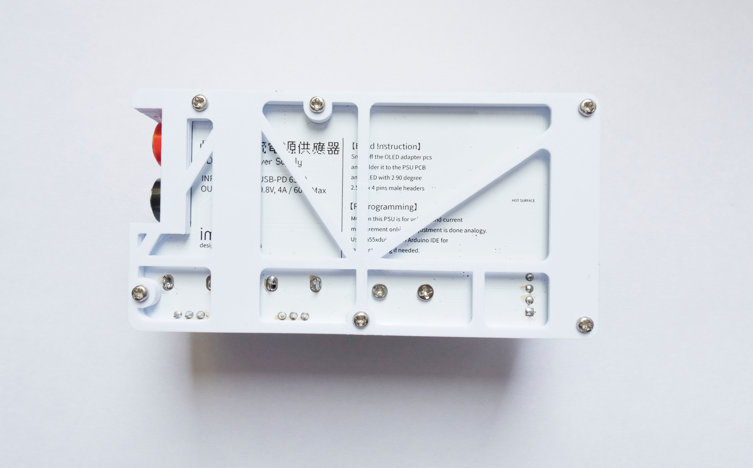

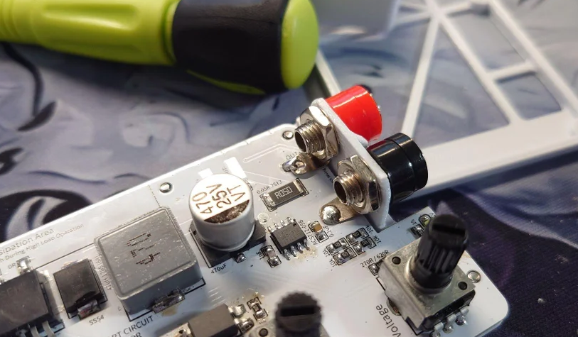

Install the PCB on the Base Plate
There are 2 holes on the 3D printed base plate for the screw in terminal of the output jack. You can first bent the metal tab on the connector and screw in the terminal / jack to the 3D printed base.
Next, slide in the PCB into the gap between the metal tab connecting to jack and the 3D printed base as shown in the photo above.
Then, solder the tap directly on the PCB while trying your best to align the screw holes with the bottom plate. Sometime inserting a few long M2 screws into two of the screw holes on the base, poke through the PCB might help stabilize the location of the PCB while soldering the jack.

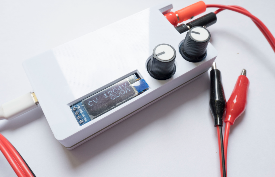

Afterward, you should get an assembled unit of the lower half of the power supply as shown in the above photo. Now, insert the OLED module into the 4 pin I2C connector and start flashing the firmware.

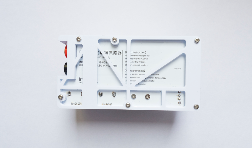

Install the Top Cover
The next step is install the top cover. The top cover can be screw in place with the bottom assembly with 6 M2 x 10 screws. It should look like what the above photo show after everything is correctly installed.
