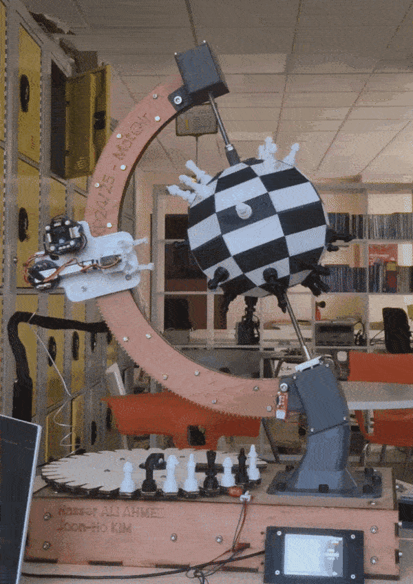

MatAir - A Robotic Spherical Chessboard
A spherical chessboard where a robotic arm plays moves from an online game.
The goal of this project is to create a spherical chessboard where moves are played by a small robotic arm moving along a circular track.
The robotic arm will execute the moves made by players in an online chess game.

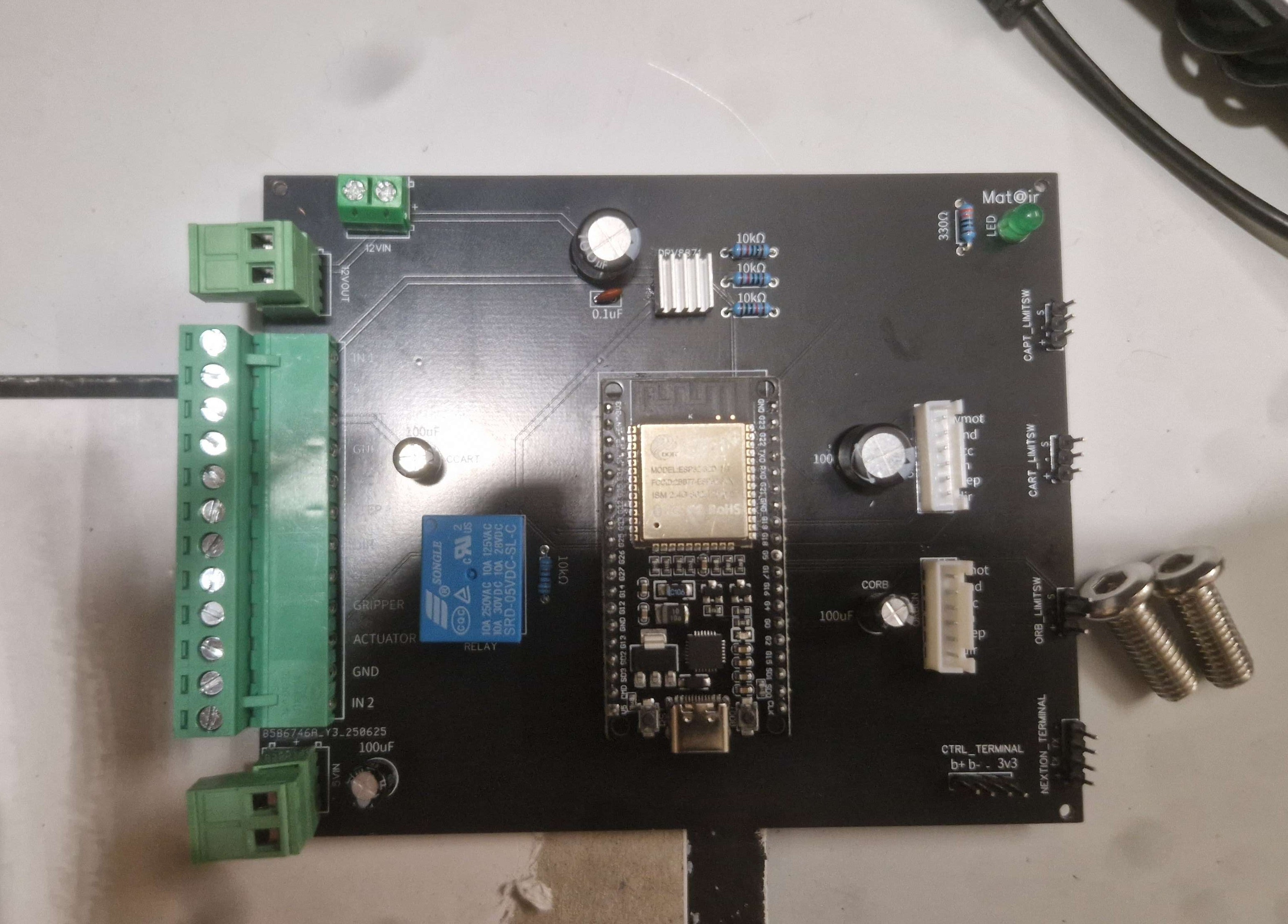

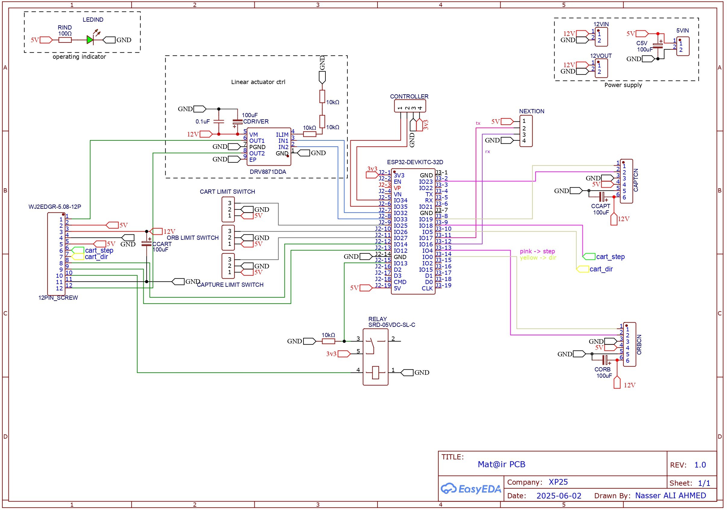

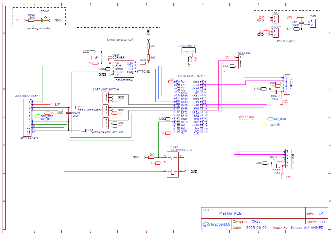

    Once the project was working, we ran into many electrical issues and signal noise, especially with the servos. Our original wiring was a mess, which made troubleshooting a nightmare.
    We upgraded to a PCB to solve this. Here is the wiring diagram:
    The PCB:
    This is how the wiring looks now.
    With this latest addition, we have decided to end the project.

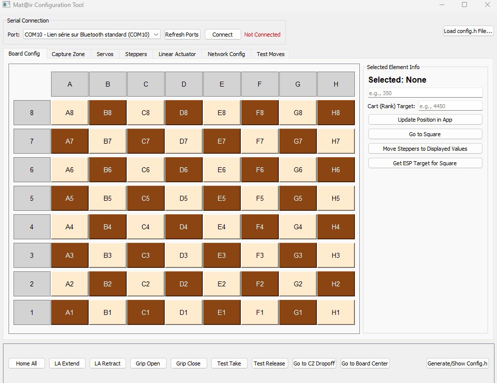

  • SOFTWARE & PROGRAMMING
    Nasser05/10/2025 at 17:07 0 comments
    With the mechanical and electronic parts assembled, we moved on to programming to connect the motors, servos, sensors, and user inputs.
    We defined the main behaviors the system needed:
    • Homing sequences for all actuators
    • Moving and capturing pieces
    • Communication with the Nextion touchscreen
    • Manual control via the two-button interface
    We wrote the program for an ESP32 using the Arduino framework. Since networking code ran in the background, all motion routines had to be completely non-blocking.
    We used multiple state machines to control the cart, gripper, capture system, board rotation, manual controller, and screen.
    We started with a simple test program for the controller. Using the two buttons, we sent signals to the actuators to confirm the mechanical and electrical systems worked
    After that, we wrote a second program to control the actuators via serial commands from a computer. We used this to figure out the right angles and positions for each motor to reach every square on the board and the capture slots.
    We used the Nextion Editor to build the touchscreen interface. It allowed us to:
    • Trigger homing
    • View system status
    • Manually control the system
    Here are some screenshots:

  • MANUFACTURING PART 4 : ELECTRONIC
    Nasser05/10/2025 at 14:43 0 comments
    After assembling the mechanical parts, we moved on to the electronics. We laid out the components:
    • 3 stepper motors (for the sphere rotation, rail cart, and capture zone)
    • 1 linear actuator (to extend and retract the gripper)
    • 2 servos (one to rotate the actuator, one for the gripper)
    • 3 limit switches (for homing and calibration)
    • ESP32 (main microcontroller)
    • Motor drivers (1 DRV8871, 1 Makerbase MKS SERVO42D, 2 Makerbase MKS SERVO42C)
    • Power (12V supply, 5V buck converter)
    • 1 Nextion display
    Next, we made the circuit diagram.

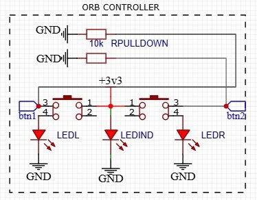

    We also added a custom controller with two push buttons to manually jog the orb.
    The diagram shows a relay connected to the actuator. We used this to detect when the linear actuator fully retracts. Because the actuator has an internal limit switch, we soldered wires directly to its motor terminals. This lets us monitor the motor voltage; when the current drops, the relay triggers, signaling that the actuator hit its internal stop.

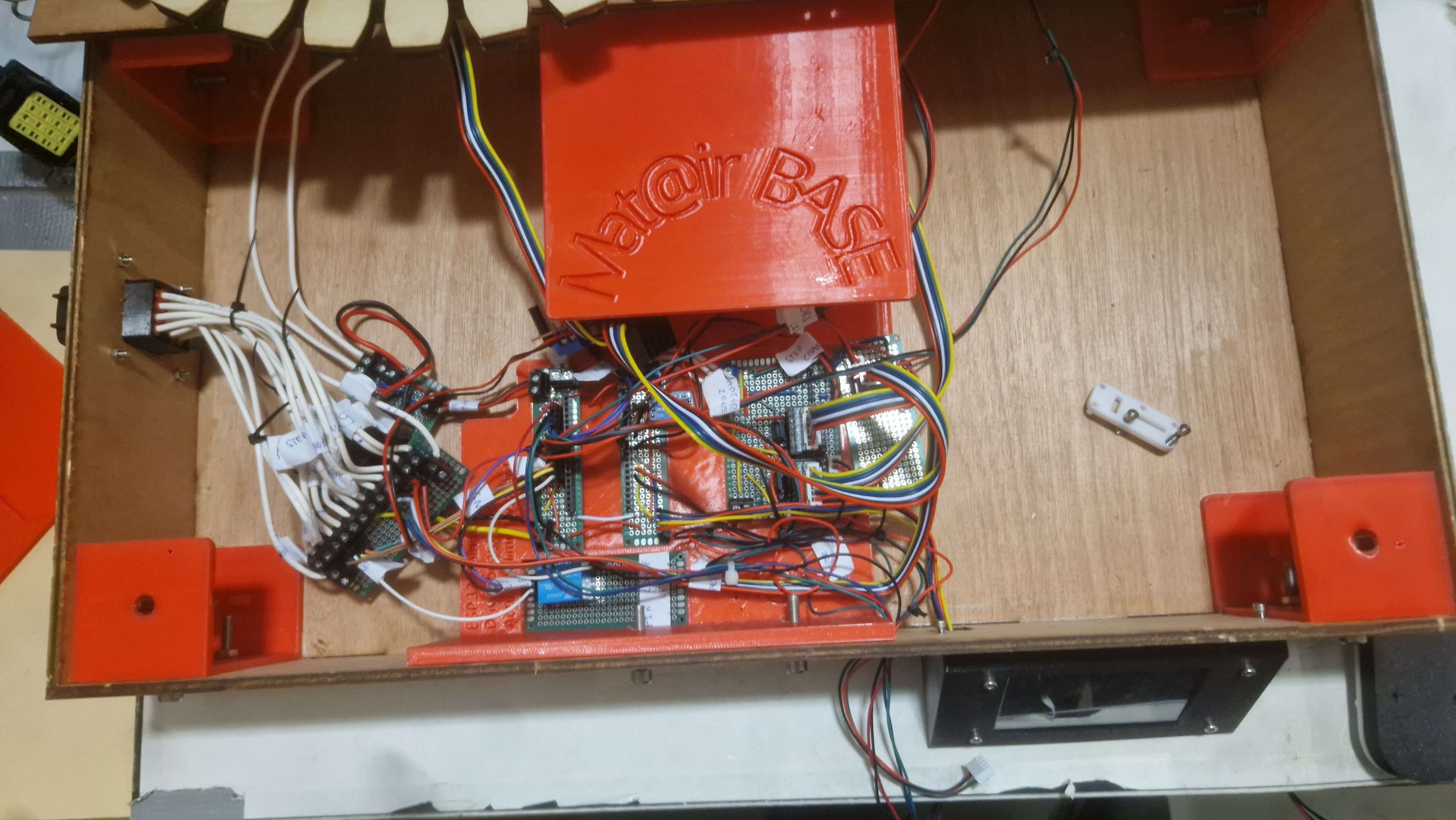

    We laid out the components on perf boards to plan the layout, then soldered everything.
    Another major task was creating the cable bundle that connects the main circuit to the moving cart on the rail. To do this, we positioned the cart at its furthest point and measured out the cable lengths accordingly to ensure proper reach.
    To allow for easy disassembly, we didn't solder the cart's cables directly to the circuit. Instead, we used a 16-pin connector like this:
    We wired the cart to the male connector and the circuit to the female connector. Here is the final cable assembly:
    Finally, we installed the electronics into the base.

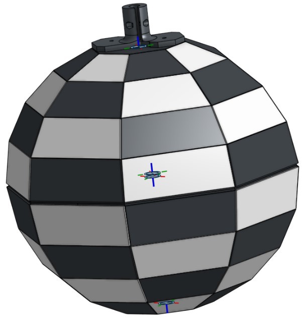

    First, we built the spherical chessboard. We glued the four 3D-printed dome parts together using the built-in hinges and some epoxy. We inserted each square into its slot and added magnets so the chess pieces would stick.

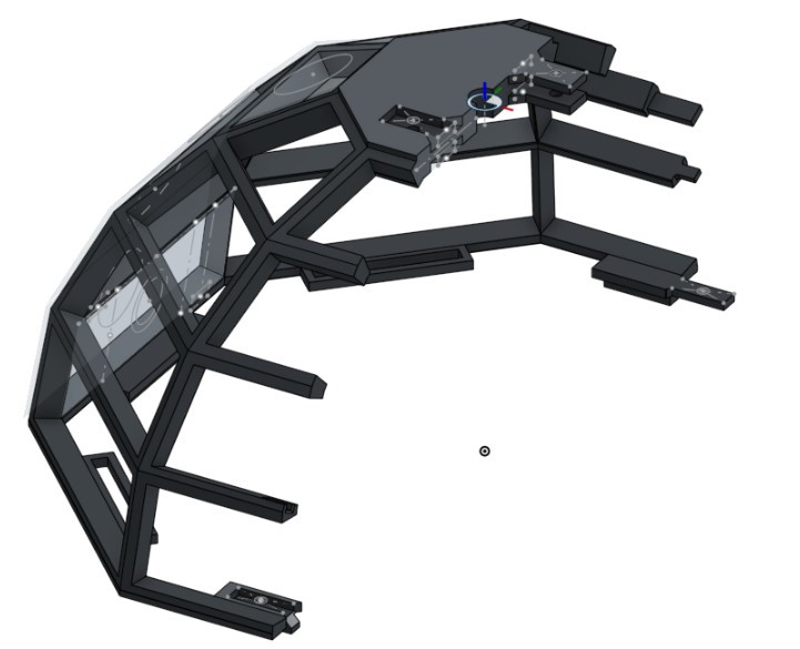

    To hold the rail we designed those two piece :
    Rail feet

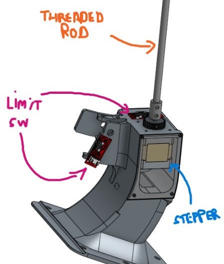

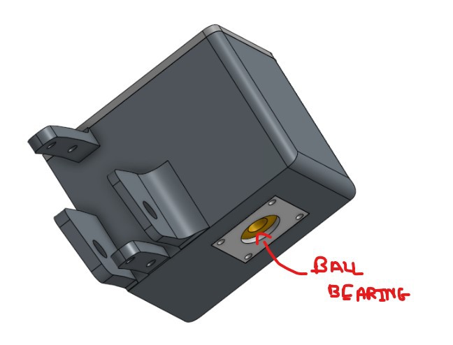

    The rail "Feet" is a very important part, it house the chessboard stepper motor, the cart and the orb limit switch.
    It connects to the rail using a m8 bolt

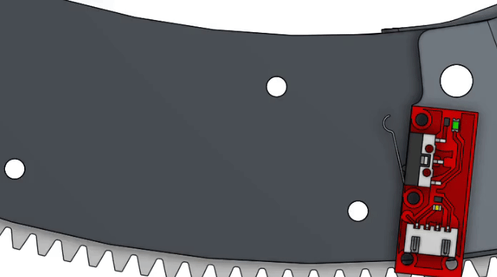

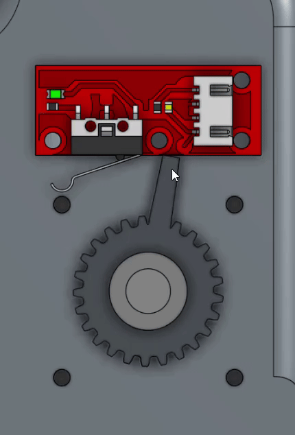

    Limit switch

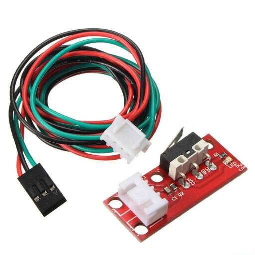

    As we're using stepper motors to move the cart and chessboard, we should be able to achieve a high degree of accuracy when moving to a position, but one problem with stepper motors is that, being an open-loop system, they wouldn't know, for example, where they are at start-up.
    To solve this problem, we used limit switches in the path of each motor so that they could have a base (reference) position.
    Here's the limit switch for the chessboard and the cart :

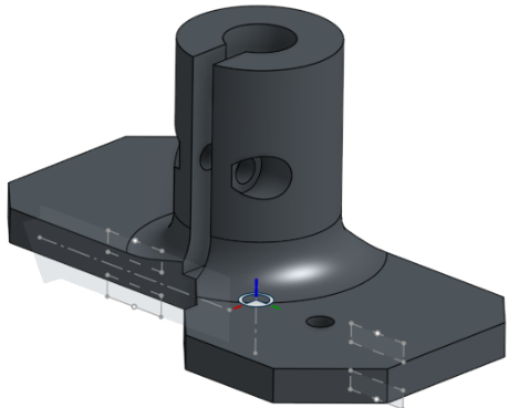

    A 3D printed piece is fixed to the stepper shaft.

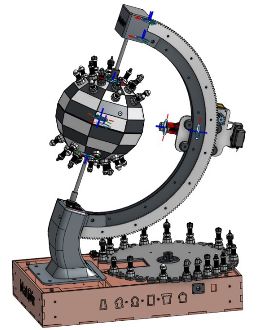

    Here is the final assembly showing the curved rail, feet and top parts, stepper motor, the spherical chessboard, and the chess pieces:

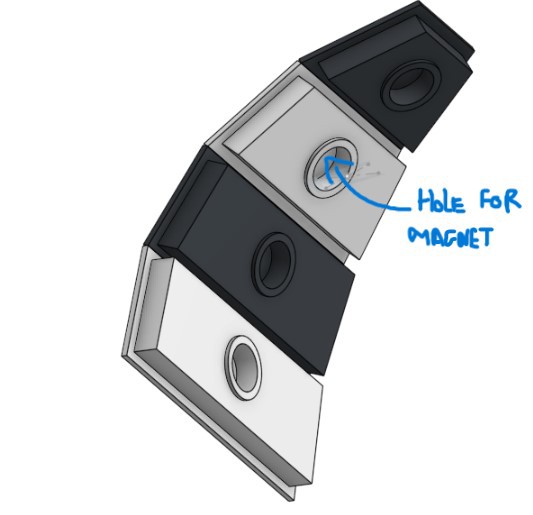

    We used magnets to keep the pieces on the board and help them self-center. We needed 128 magnets total: 32 for the pieces, 64 for the squares, and 32 for the capture zone. We chose 12mm x 3mm neodymium magnets with a center hole so we could screw them in instead of using glue
    Because neodymium is so strong, we had to find the right amount of plastic to put between the board magnets and the piece magnets. If they touch directly, they are too hard to pull apart. We needed enough grip to hold the pieces upside down during movement, but not so much that the robot couldn't lift them.
    We built a test bench with plastic thicknesses ranging from 1mm to 5mm. We attached a ring to a piece and used a luggage scale to measure the force needed to pull it off. We also checked if the pieces stayed attached during abrupt movements or when held upside down
    After conducting our tests, we obtained the following results:
    (The infamous inverse square law is back at it again, see our log on the small hydraulic arm •_•  )
    The tests showed that 3mm of plastic was the best balance. The pieces stayed on while upside down or moving, but the pull force was still manageable
    With this decision, we updated the sphere design accordingly to incorporate the 3mm thickness.
