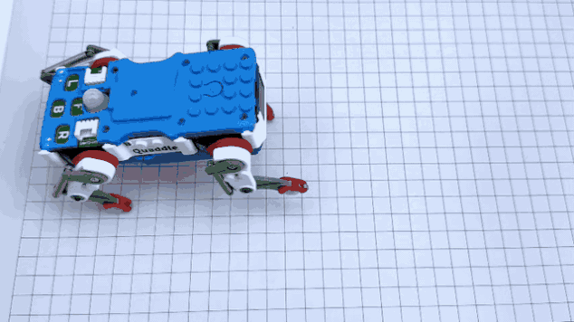

When only the shoulder drives a rigid leg, the leg sweeps an arc. The toe tends to drag as it crosses beneath the shoulder. Simple quadrupeds often avoid that collision by keeping the leg in one half of the arc. This creates a fan-shaped dead zone beneath the shoulder. The robot can shuffle, but its stride remains short and stiff.
To cross that zone, the robot must change the leg's effective length. It retracts the unloaded leg, passes it beneath the shoulder, and then extends it to accept load. A conventional quadruped gives that sequence to a knee servo. Quaddle's MinDoF (Minimal DoF) leg derives it from the shoulder motion itself.
When the shoulder reverses, geometry, elasticity, and loading change the leg's response. The shoulder-to-toe length shortens during swing and extends again before support. Quaddle needs no separate phase sensor here. The mechanism reacts directly to direction and force.
Each leg still has its own shoulder servo. Quaddle is not a one-motor toy with four legs locked to a crank. Firmware can vary each leg's phase, direction, amplitude, and timing. MinDoF removes the second commanded joint from each leg, but keeps the four legs independent.
This is motion reuse. One servo sweeps the leg forward and back. The structure derives a second, phase-dependent change in leg length from the same motion. The resulting foot path covers more useful space than a rigid arc. The controller cannot place the foot anywhere in Cartesian space, but it recovers a useful subset of the gaits that usually require more active joints.

The foot needs different friction at different moments. It needs traction during support. During swing, an accidental touch should not stop the leg or tip the body. Quaddle's toe combines an elastic element, a small roller, and asymmetric friction. It favors grip under load and rolls more freely during glancing contact.
The roller also opens another motion mode. Different gait timing can produce several forms of gliding, including continuous contact on all four toe wheels. On a suitable smooth surface, a prototype reached 3 body lengths per second this way. The result depends on the surface, but it avoids some of the repeated lifting and impact of walking.
The wheel does not simply turn Quaddle into a wheeled robot. The shoulder still decides when and where each leg pushes. The toe changes whether that contact behaves more like a foot or a wheel. In this way, one active DoF serves several functions.

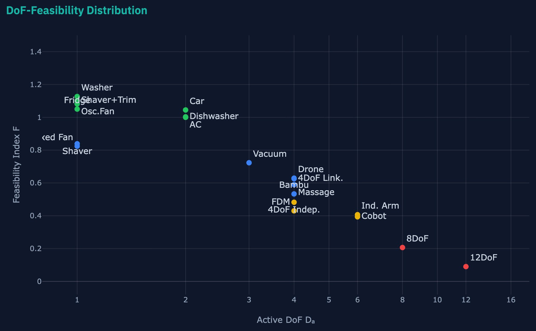

That idea grew from a broader question about robot feasibility: what happens as active DoF rises, and how much can function reuse change the result? I made a heuristic model and interactive calculator at dof.petoi.com. The model treats each active DoF as both added capability and added cost, then asks how reusing one DoF for several functions changes that tradeoff.

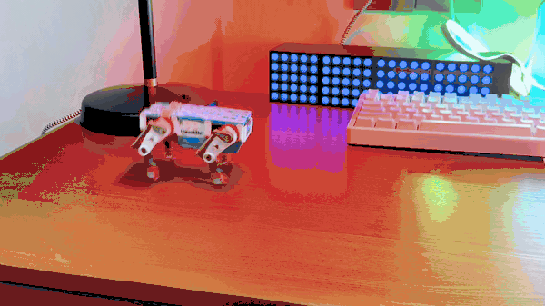

Quaddle still needs software. A CPG-inspired gait layer coordinates the relative phase, amplitude, direction, and speed of four periodic shoulder motions. Symmetric patterns move forward. Differences between sides turn the body. Sideways motion needs a more delicate combination of phase, compliance, toe contact, and friction.
Here, “omnidirectional” describes forward motion, turning, and surface-dependent sideways motion—not the arbitrary planar velocity of a Mecanum platform or independent 3D foot placement. Prototypes have also walked on three legs, righted themselves, flipped, and glided. This range shows what four servos can do, not that they can replace twelve in every application.

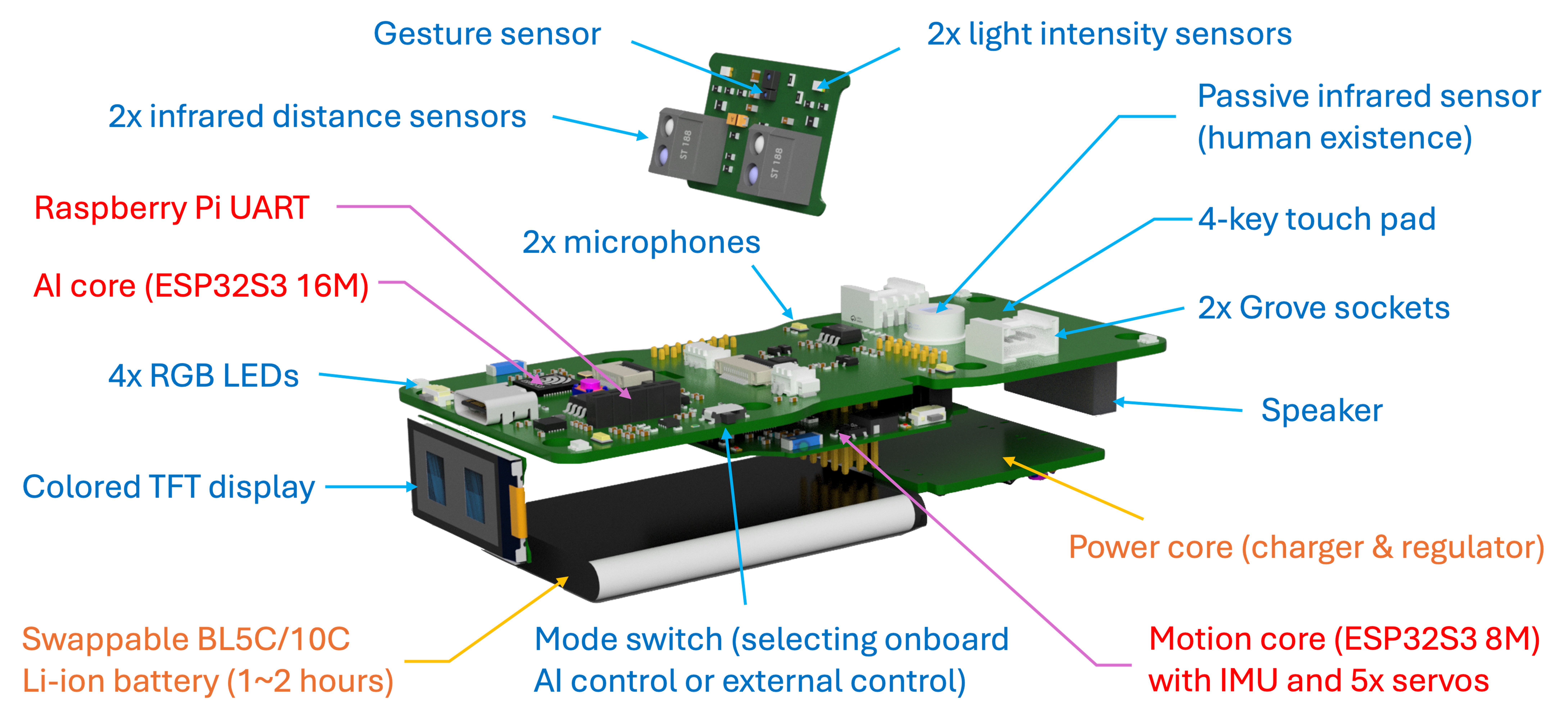

The electronics keep real-time motion separate from fast-changing applications. A lower board manages charging and power. A shared USB Type-C connector supplies power and provides a programming link to the middle board. This ESP32-S3 motion board controls gait timing, reads the IMU, handles communication, and enforces safety limits. Users can program it in Arduino C or MicroPython and connect hardware through unused GPIOs.

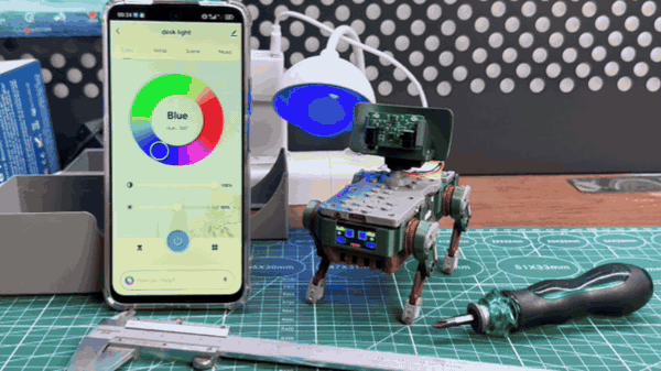

An optional upper board adds sensing, touch, voice, networking, and higher-level interaction. The application layer sends commands for gait, skill, posture, direction, and speed. It leaves servo timing to the motion board. In turn, the motion board does not need to understand natural language. A phone, gamepad, PC, Python script, voice agent, or Linux board can all use the same motion vocabulary.
The Education/Classroom upper board carries an ESP32-S3 AI Core and a socket for a Raspberry Pi Zero. They share one UART connection to the motion controller. A physical switch connects to one or the other. Selecting the Pi also cuts power to the AI module. The Builder version omits the upper board. A replaceable BL-5C/BL-10C-format battery supplies power instead of a sealed proprietary pack.

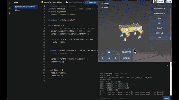

You can play with this simulator (also an emulator for ESP32 S3) in your browser, even on your mobile phone:
https://www.petoi.com/pages/quaddle-robot-dog-simulator
We've uploaded the URDF to Hugging Face.
https://huggingface.co/petoi/quaddle
The mechanism has moved beyond a sketch. We compared the simulated model with physical prototypes, adjusted the geometry, and made injection molds for the leg. Tests then confirmed that the molded parts reproduced the modeled behavior at this scale.
