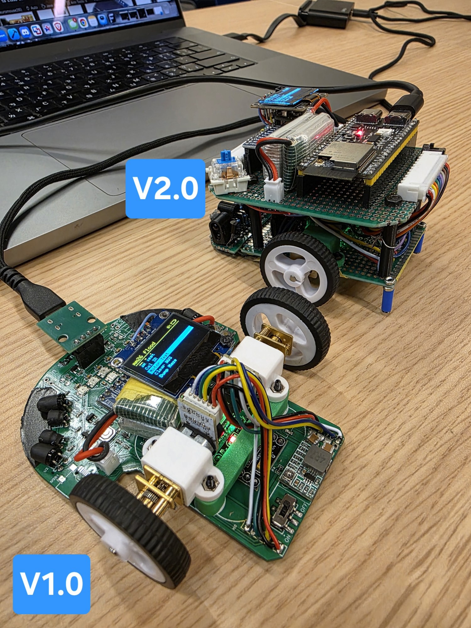

We built two mice. V1.0 was a custom PCB, and every mistake (a wrong resistor, a noisy power rail, a sensor too close to a wheel) meant another board spin of about a week. V2.0, the one that placed, is point-to-point wiring on protoboard. Moving a sensor and re-testing took about fifteen minutes.
V2.0 (hand-wired protoboard) next to V1.0 (custom PCB).

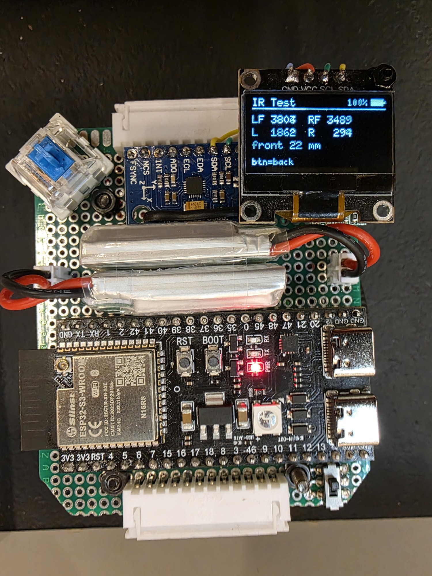

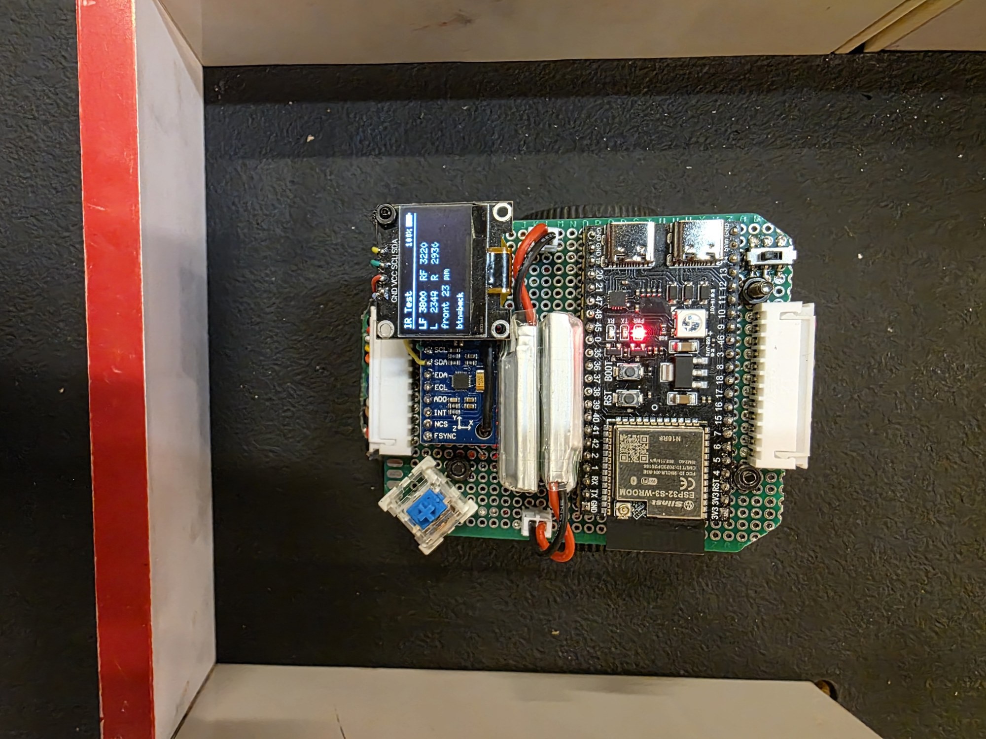

  • ESP32-S3-WROOM dev board, PlatformIO + Arduino 2.x
  • 2× GA-N20 1:30 gear motors (500 RPM at 6 V) with 7 CPR magnetic encoders, on a DRV8833
  • 4 IR channels (SFH4545 emitters + TEFT4300 phototransistors), all facing their wall at 90°: two forward, two sideways
  • MPU-6500 gyro and 0.96" SSD1306 OLED on one I2C bus
  • 300 mAh 2S LiPo; 95 × 85 mm; about 161 g
Top of the V2.0 protoboard stack: ESP32-S3 dev board, OLED, keyswitch.
The motors run 10-bit PWM at 200 Hz. It whines, but on this DRV8833 + N20 combination 200 Hz gave the most breakaway torque; 10–20 kHz gave weaker low-PWM response. The repo has no V2.0 schematic, so include/PinConfig.h is the wiring reference.
Close-up of the hand-wired protoboard and OLED.

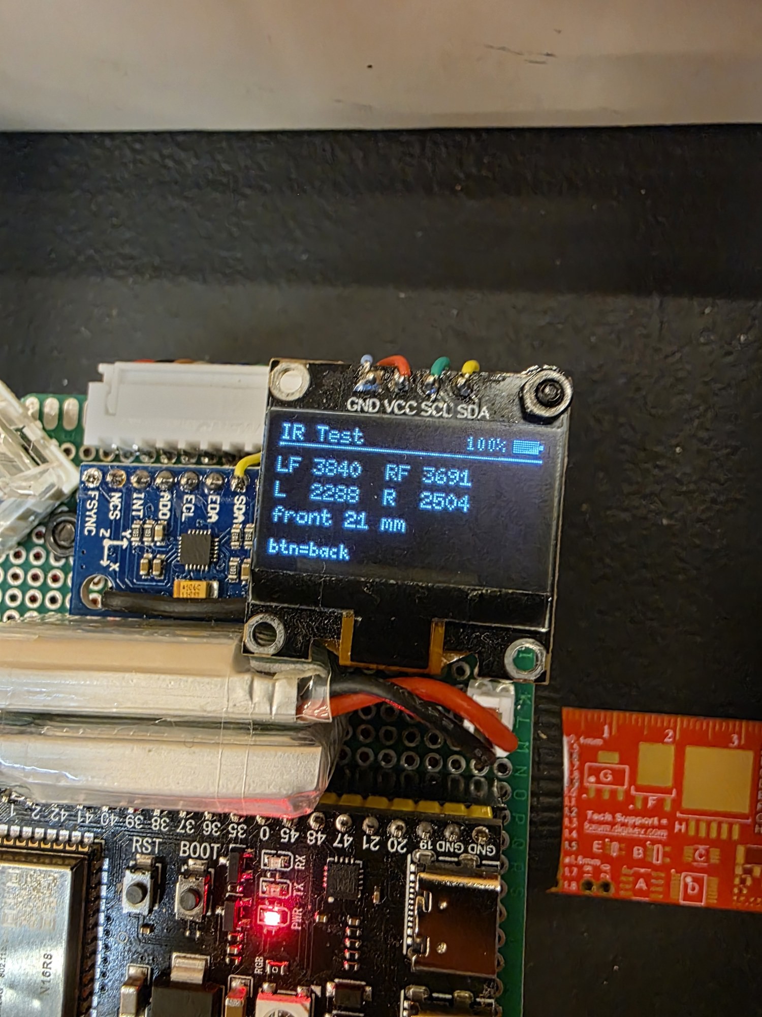

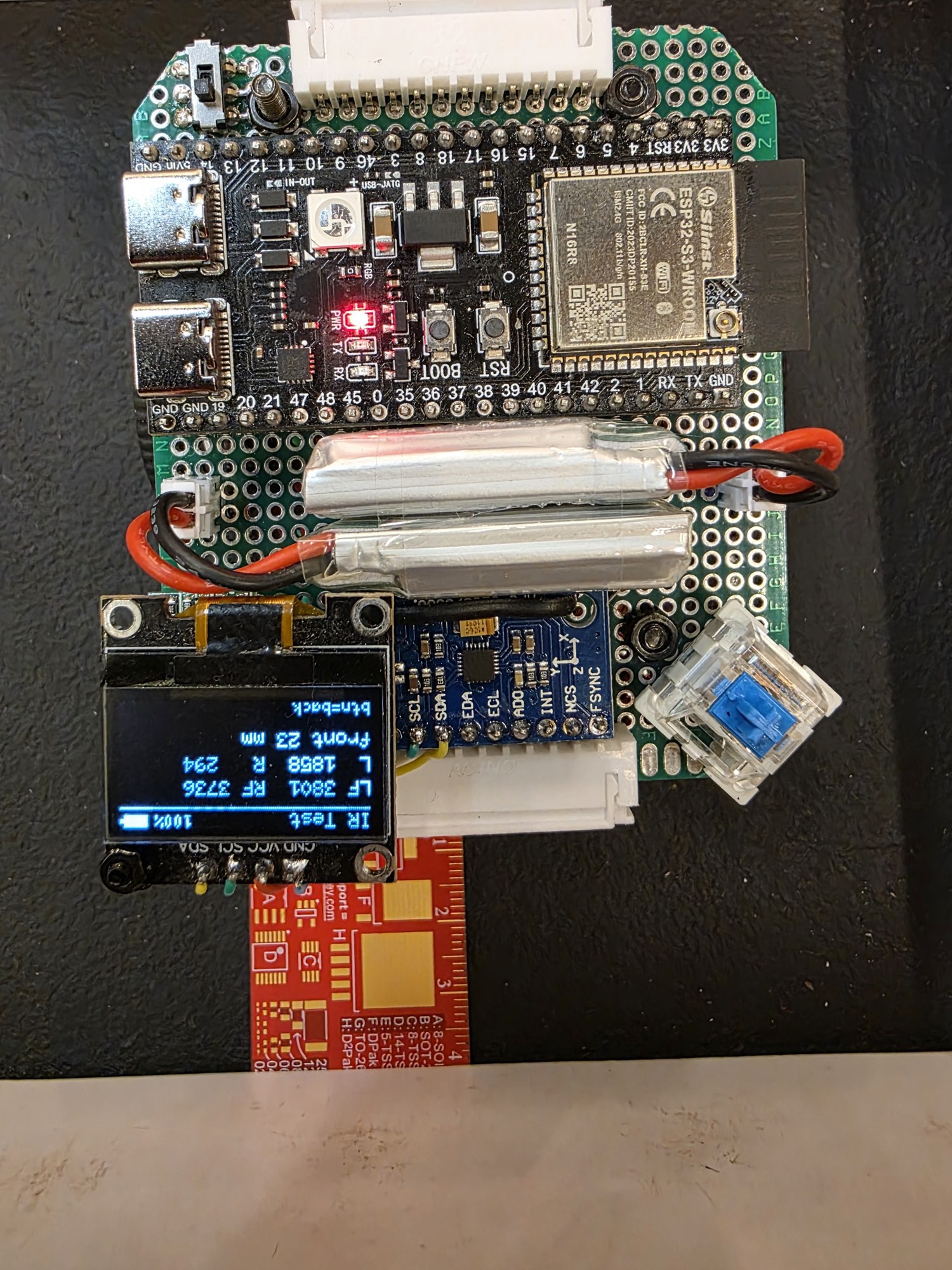

  • The OLED shows the menu, IR counts, encoder ticks, run state and battery. Dump Walls prints the map to serial. Spinning the right wheel scrolls the menu.
The OLED IR Test screen with live LF/L/R/RF counts and front distance.
Bench debugging with the laptop next to the mouse.

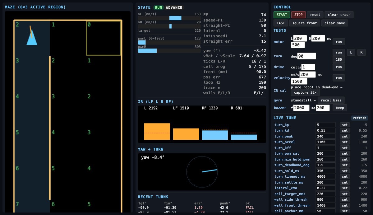

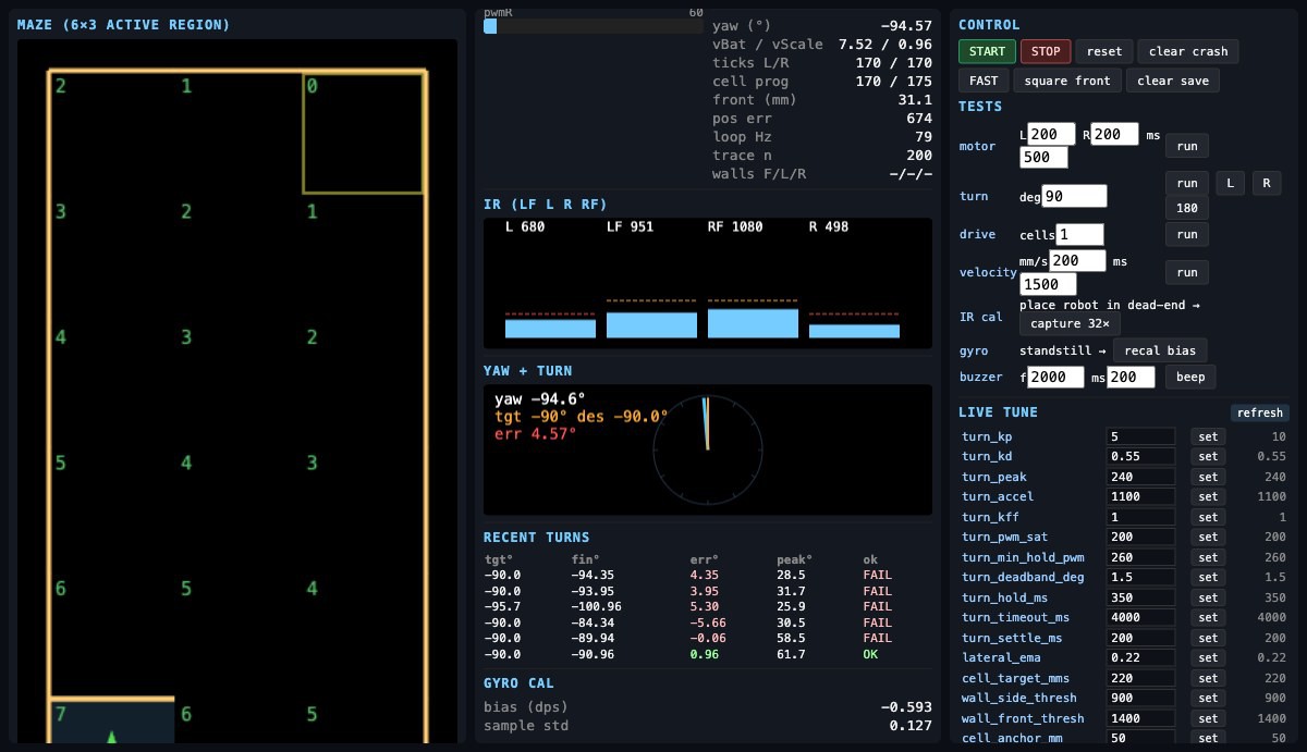

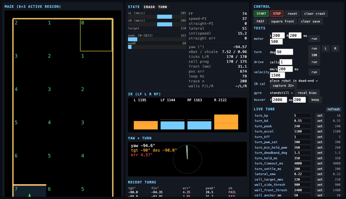

The web-debugger screenshots below come from an earlier firmware sketch that has since been removed from the repo. The repo marks the HTTP debug server in include/WifiDebug.h dormant. It isn't part of the main build, and its page looks different.
Web debugger (earlier sketch, since removed): run state.
Web debugger (earlier sketch, since removed): turn PID.
Web debugger (earlier sketch, since removed): full telemetry and live PID.
