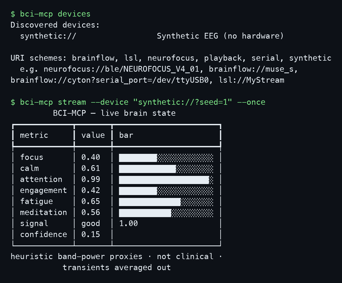

Real terminal output from bci-mcp devices and a one-shot stream on the synthetic device. Confidence is 0.15 on the first reading.
In 0.2.0 the FastMCP server exposes 14 tools, 2 resources and 1 prompt. Main adds a third resource, brain://citations, which isn't released yet. The same pipeline drives a CLI meter, a dashboard, a recorder and a neurofeedback trainer. Tool inputs are validated and capped, recordings are sandboxed, and playback:// and serial:// are refused over MCP.

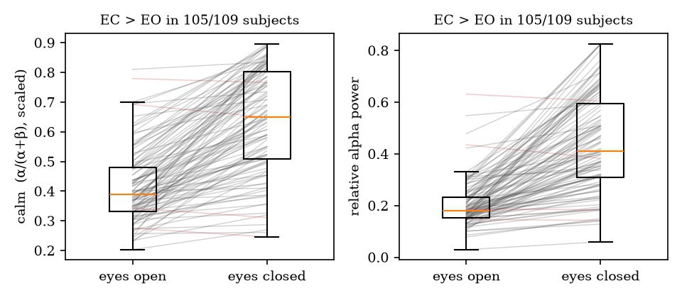

I ran the pipeline on the eyes-open and eyes-closed baselines of all 109 subjects in the PhysioNet EEG Motor Movement/Imagery Dataset (O1/Oz/O2, 2 s windows, uncalibrated). Calm rose with eyes closed in 105 of 109 subjects (median 0.39 to 0.65; Wilcoxon p = 3.2×10⁻¹⁹), which reproduces the classic Berger alpha effect. Within a subject, a single calm threshold separated the two conditions with a median AUC of 0.87. Pooled across subjects it was only 0.78, which shows why per-user calibration is there.
Calm and relative alpha rise with eyes closed in 105 of 109 PhysioNet subjects.
