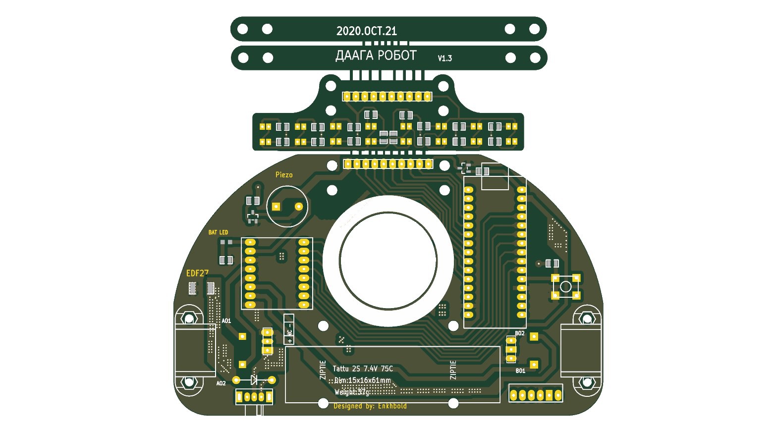

Daaga V1.3, converted with epro2kicad and rendered with kicad-cli (top side). This is the render in the repo.

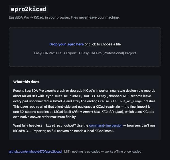

There is also a browser version at https://enkhbold470.github.io/epro2kicad/docs/. It is a JavaScript port of the normalize and package stages, so the file never leaves your machine, and its zip contains the repaired project as <name>_fixed.epro. It cannot produce a .kicad_pcb, because KiCad's C++ importer does not run in a browser, so you finish with one import step inside KiCad.
The browser version at enkhbold470.github.io/epro2kicad/docs.

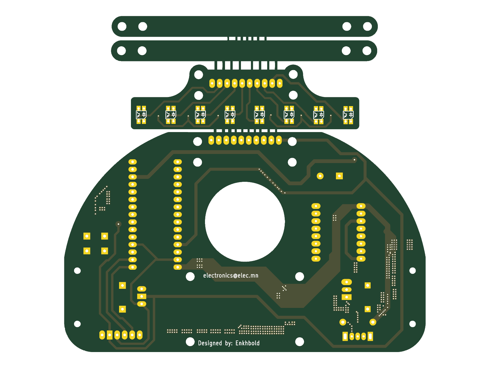

The repo ships a real test case, the .epro for Daaga V1.3. Daaga is a robot controller board I designed in 2020 (Arduino Nano, TB6612FNG dual motor driver, QRE1113 reflective sensors, HC-05 Bluetooth header). The v1.0.0 release notes record 45 footprints, 1068 tracks and 63 nets for it. The render in the repo was made with kicad-cli pcb render from the converted .kicad_pcb. Footprints, tracks, zones and the breakaway sensor panel all came through.
Bottom side of the same converted board, rendered with kicad-cli pcb render.
