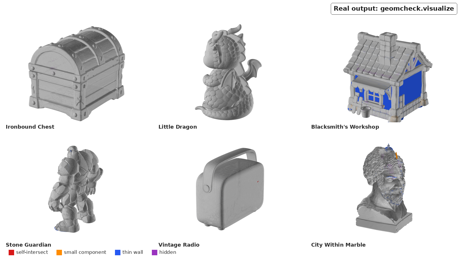

Real output: geomcheck's per-face flags on the six test models. Blue = thin wall, purple = hidden, orange = small separate piece, red = self-intersection.

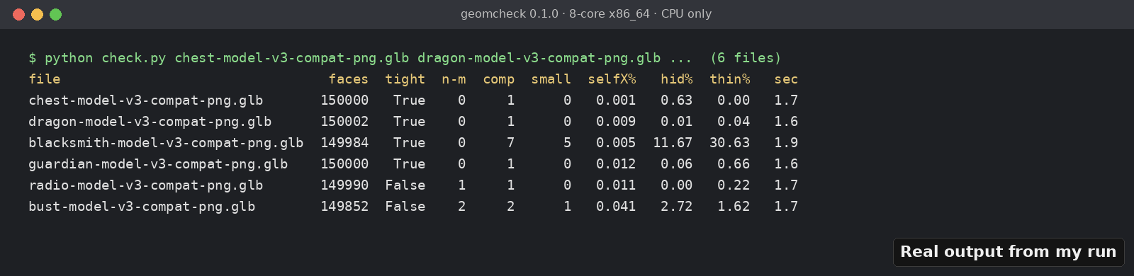

The whole script:
import sys, time
from geomcheck import compute_all
for p in sys.argv[1:]:
t = time.perf_counter()
r = compute_all(p) # full resolution, default thresholds
nm = round(r["nonmanifold_edge_frac"] * r["n_edges"])
print(p, r["n_faces"], r["watertight"], nm, r["n_components"], r["n_small_components"],
f'{100*r["self_intersect_face_frac"]:.3f}', f'{100*r["hidden_surface_frac"]:.2f}',
f'{100*r["thin_frac_0.005"]:.2f}', f"{time.perf_counter()-t:.1f}s")
Real output from my run (formatted version of the script above), 8-core x86_64, CPU only.
| File | Closed solid? | Edges with 3+ faces | Parts / under 1% area | Crossing faces, full res → decimated | Never-visible surface | Surface under 0.005 diag |
| chest | yes | 0 | 1 / 0 | 0.001% → 0.000% | 0.63% | 0.00% |
| dragon | yes | 0 | 1 / 0 | 0.009% → 0.000% | 0.01% | 0.04% |
| workshop | yes | 0 | 7 / 5 | 0.005% → 1.170% | 11.67% | 30.63% |
| guardian | yes | 0 | 1 / 0 | 0.012% → 0.030% | 0.06% | 0.66% |
| radio | no | 1 | 1 / 0 | 0.011% → 0.020% | 0.00% | 0.22% |
| marble bust | no | 2 | 2 / 1 | 0.041% → 0.190% | 2.72% | 1.62% |
"Decimated" is the same run with decimate_to=10000 (Log 4). None had an open boundary loop. compute_all took 1.5–1.9 s per model in this first pass (Log 7 has cleaner timings). Running it a second time on the bust returned an identical dictionary.
Log 3: what it actually caught
A buried set of blocks in the workshop. "7 pieces, 5 small" sounds like floating debris, so I coloured each connected component. Piece #2 is the anvil: separate but intentional, 4,740 faces. Pieces #3–#7 are five small pad blocks at floor level under the wall corners. Then I crossed the component labels with the per-face visibility flags from geomcheck.visualize.face_flags. All 2,412 faces of those five blocks are hidden, and none of them self-intersects. They sit completely inside the walls. You could delete them and...
