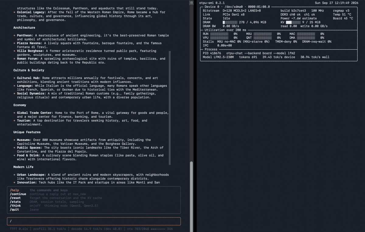

Running on the FPGA
The README demo shows LFM2.5-230M running in otpu-chat, alongside otpu-smi monitoring utilization and DRAM bandwidth.
Animated openTPU FPGA chat demo with card utilization and DRAM bandwidth

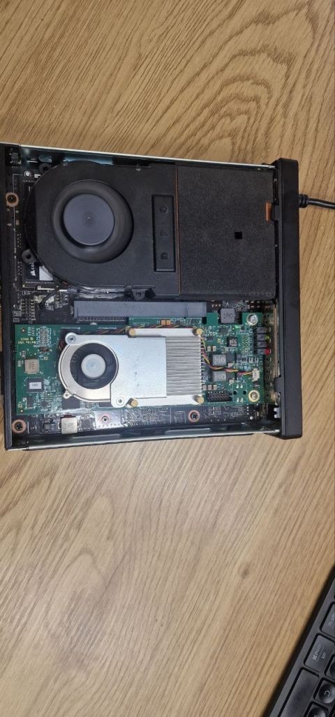

The hardware
The YPCB-00338 board provides 4 GiB of DDR3 across two 2 GiB channels and connects to the host over PCIe Gen2 x8. Its board build combines a four-column systolic matrix unit, eight vector lanes, and LiteDRAM memory controllers. The repository documents building the bitstream, programming the FPGA, and checking the card with host diagnostics.
openTPU accelerator installed in the host PC
