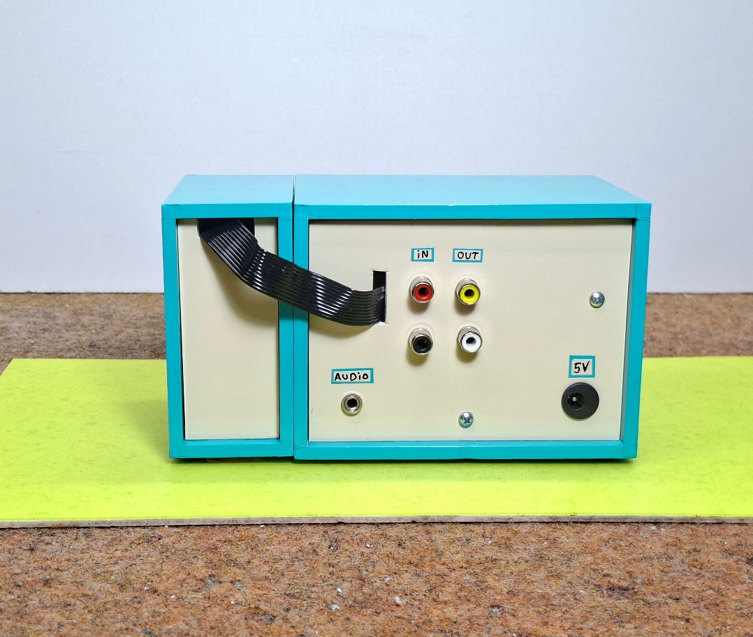

  As you can see, the device I built is a tangle of wires, but this is merely a test unit intended to demonstrate functionality. The actual, final Hi-Fi device needs to be constructed using shielded and grounded components—particularly the display and the ESP32—to prevent interference with the audio. Additionally, a "star grounding" scheme should be implemented, and coaxial audio cables should be used for the inputs and outputs.

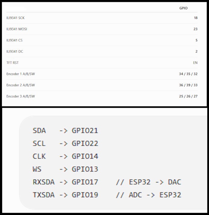

The image below shows a table regarding how the components are connected.

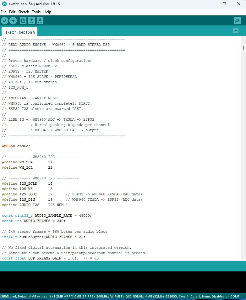

  As for the code, it generally consists of two parts, namely a visual part that represents the current settings state and sends commands to the audio board, and the part that performs the audio processing, i.e. the Audio Codec Board. Unexpectedly, the second part of the code was much more complex than the graphical control part, considering that there is no library specifically for this purpose. To compile the code without errors, it is necessary to install the given libraries, especially TFT-eSPI which is modified specifically for this configuration.

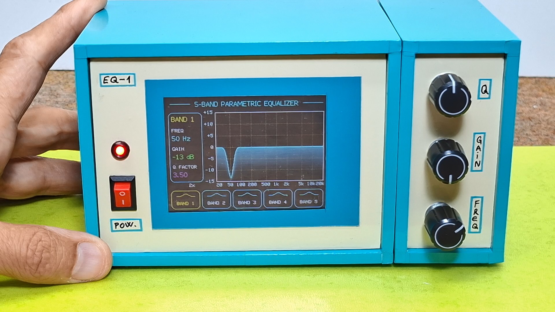

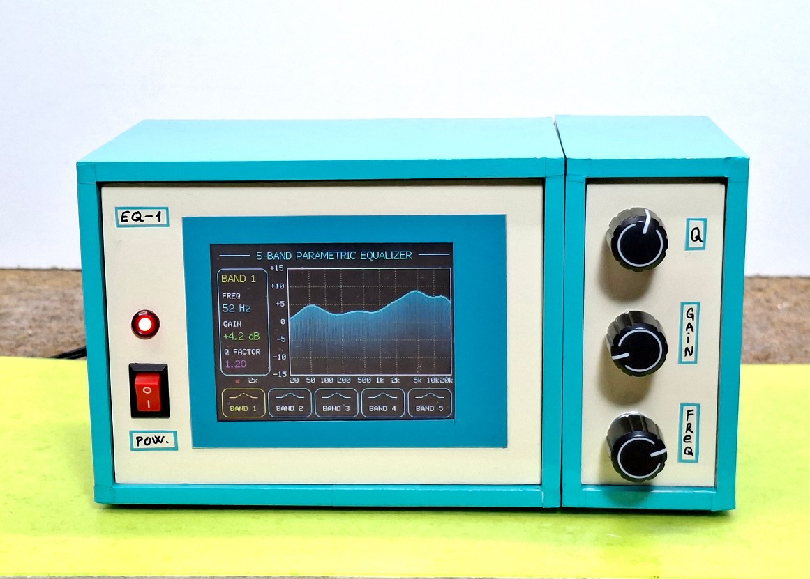

  First, let me explain all the functions. When turned on, the last set configuration appears on the display. In the bottom row of the screen there are five buttons that select the five areas by clicking on the first rotating encoder. On the left side are the values of the three parameters for the selected area.
-By rotating this encoder, the center frequency for the specific area is changed. With a long press, bypass is performed, i.e., a clean unprocessed sound is sent to the output for comparison. With a repeated long click, we return to the equalized sound.
-By pressing the second rotating encoder, the speed of changing the curve is changed, normal and 2x speed. By rotating it, the Gain value is changed in the range from -15 to +15 dB. With a long click on the button of this encoder, the device is reset to the initial factory settings, i.e., an unprocessed audio signal to the outputs.
With a single click on the third rotary encoder, the way the curve is displayed changes between Single Band/ All Bands Show, and with its rotation, the Q factor of the curve changes. A long press on the third encoder enters a special PRESET mode. Specifically, I have reserved five slots for saving settings. "P1" appears on the screen, and rotating the encoder allows you to select a slot from P1 to P5. After making a selection, a short press loads the previously saved state, while a long press saves the current EQ state to the selected slot.
So with these three encoders we can adjust any shape of the curve, which is almost impossible for a graphic equalizer. This equalizer also has the ability to detect clipping distortion caused by a too strong input signal, which is manifested by the graph turning red at moments of clipping.
For example, if there is a 50Hz hum caused by the power supply, we can remove a very narrow area around that frequency, thus eliminating that defect.
