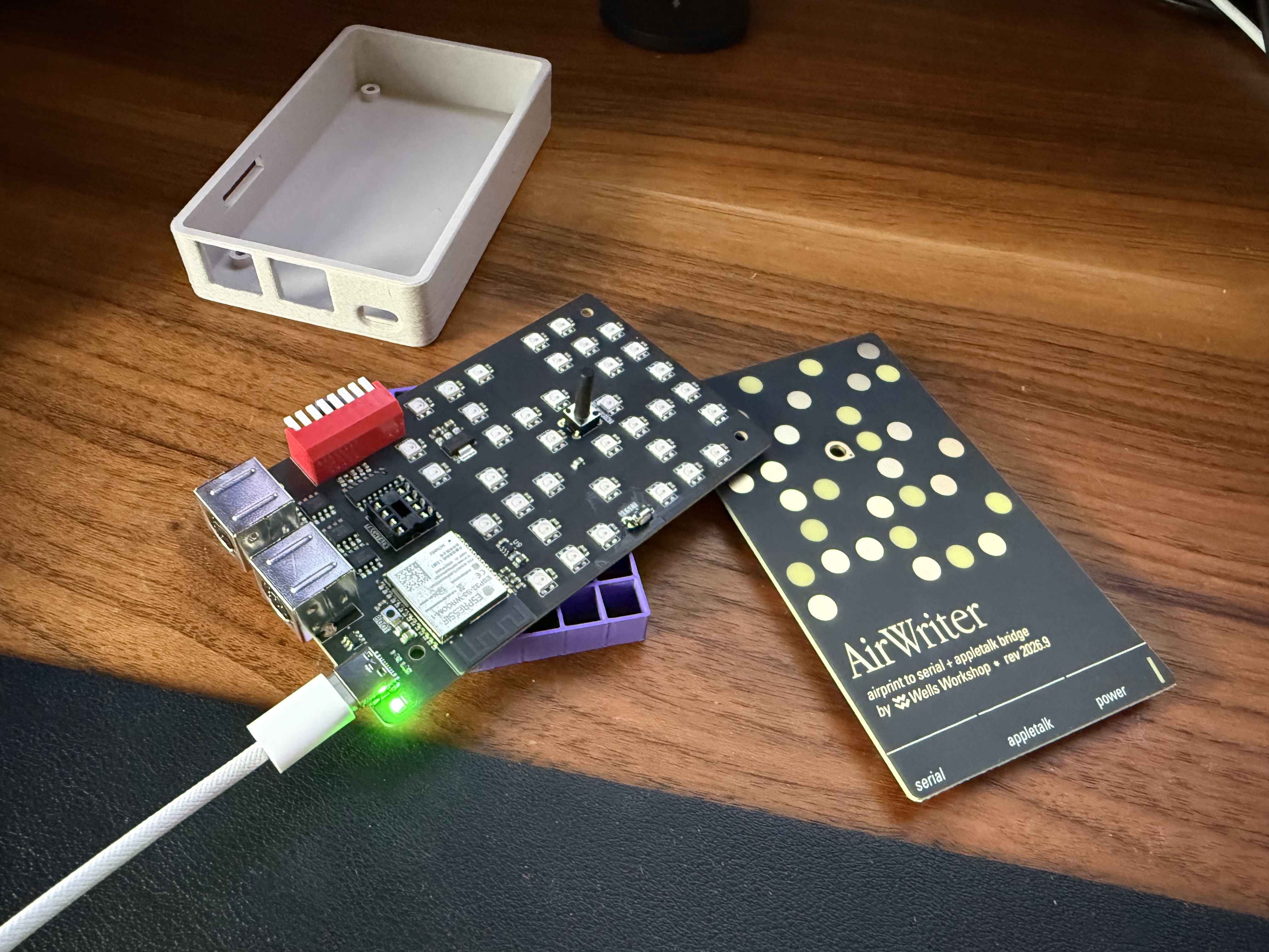

It's an ESP32-S3 on a custom board with two mini-DIN ports, one for the printer and one for LocalTalk. When you hit Print, AirWriter takes the job over Wi-Fi, dithers it with Atkinson dithering (the same one the original Mac used), converts it to the ImageWriter's graphics mode and sends it down the serial cable. It uses the same Apple cable that connects the printer to a Mac, so you probably already have one.
If the printer runs out of paper or someone presses SELECT, your phone gets an alert, and the page carries on once you fix it.

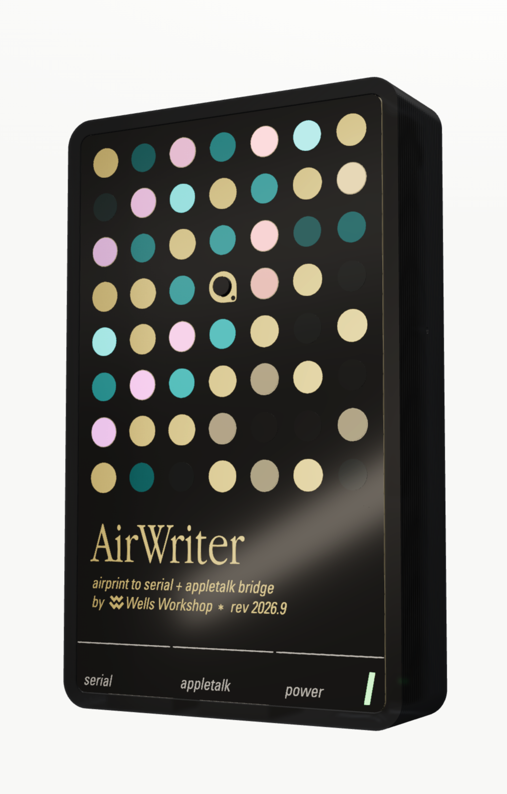

The front is a second PCB with no parts on it, just artwork. Its grid of dots is made from bare FR4, soldermask and gold, and 37 RGB LEDs behind it show what the printer is up to. A little print head runs across the dots while it prints, they turn amber when it needs paper, and they glow like embers when the printer is switched off.

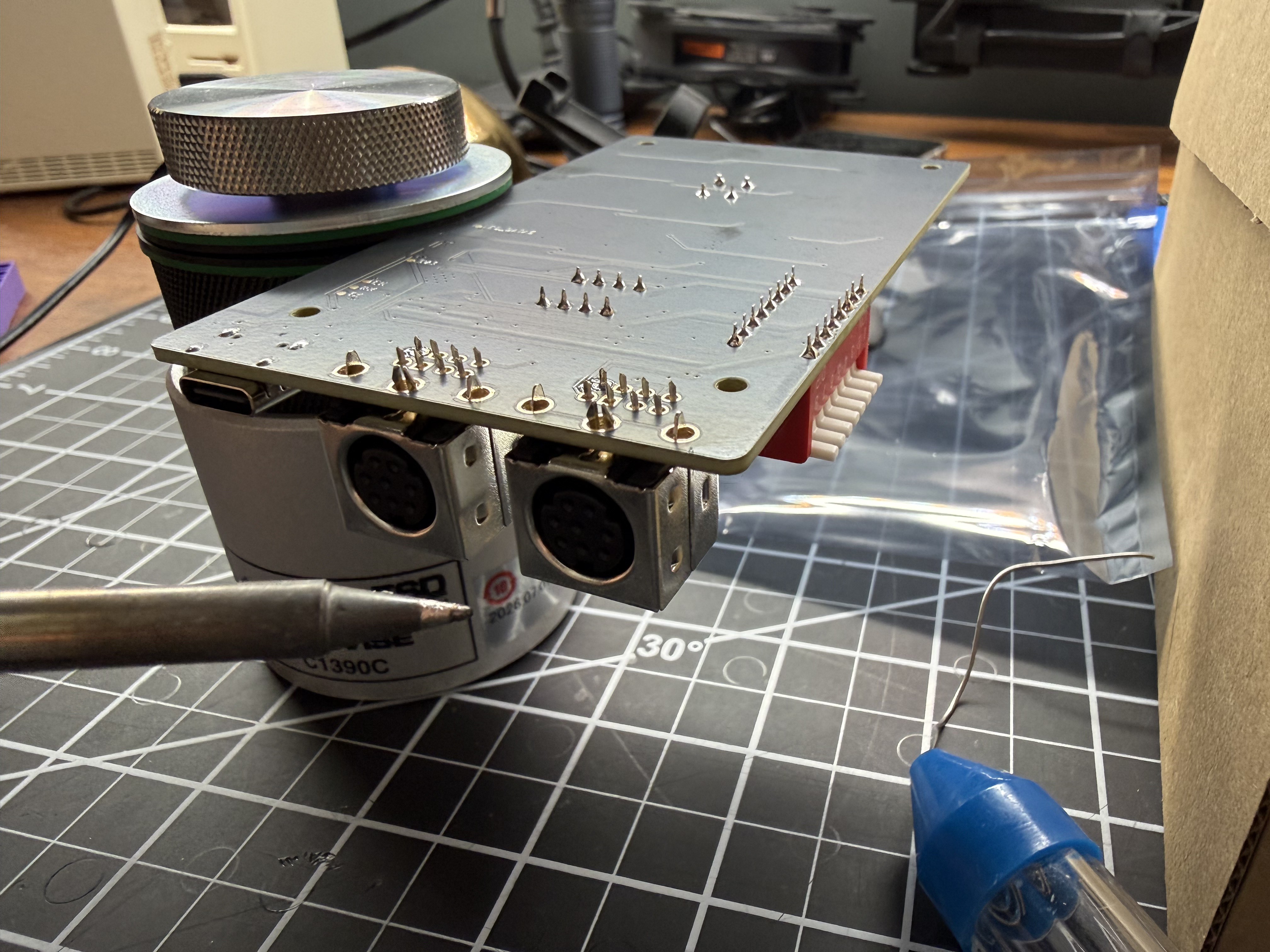

    The boards came back from PCBWay, and I soldered on the two mini-DIN ports by hand. The LocalTalk chip is a PIC, and rather than buy a programmer I had the ESP32 program it right in its socket. That took a couple of tries.
    The first print came out exactly the same as the laptop version, byte for byte, which was a relief. A full-page photo from my iPhone takes about two minutes to print. I also printed a case for it, which took a few rounds to get right. The board slides in past a flexible wall on one side.

    I tried a few looks for the front before landing on this one. It's a second PCB that snaps off the same panel as the main board and has no components at all. I draw the art in Figma, and a script turns the export into a KiCad board, with each colour mapped to a PCB material. Bare FR4 lets the LEDs through in full colour, soldermask turns them teal, and the gold dots stay dark.
    The first version would have leaked light everywhere, because black soldermask lets teal light through. So the back of the panel is solid copper, with holes only behind the dots that are meant to light up.
