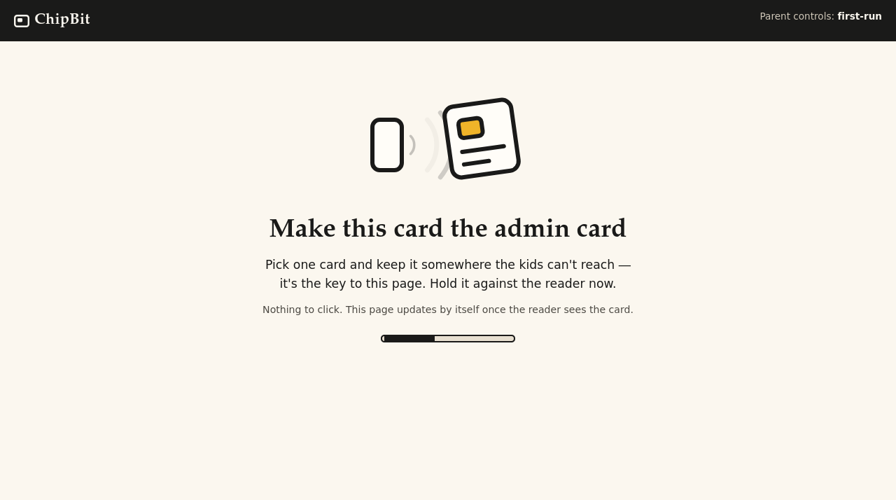

There's a web UI served from the Pi itself that you access by tapping a special admin card you enroll on setup. From there you enroll cards, bind titles, and set screen time limits.

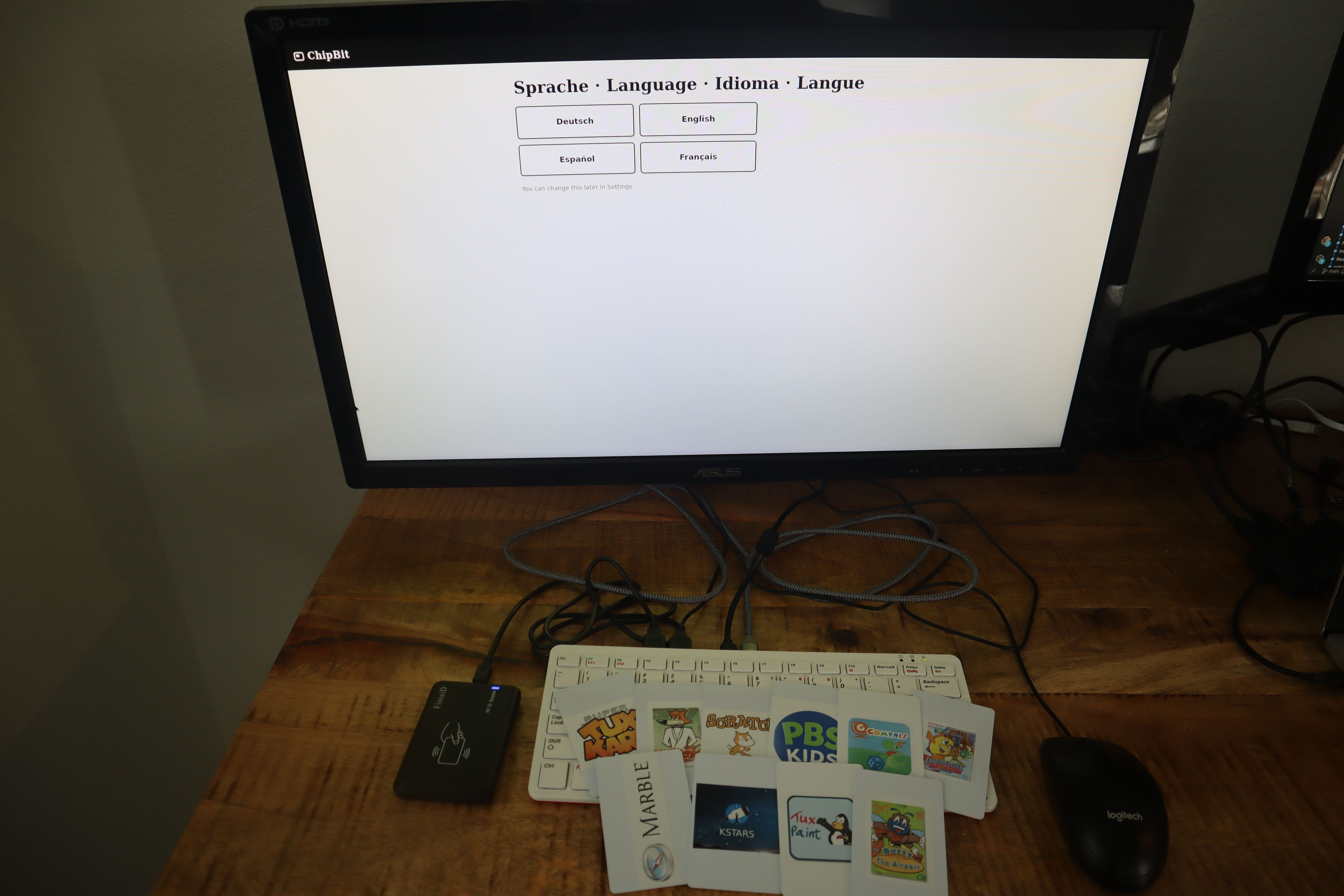

  • 1 × Raspberry Pi 400 or newer
  • 1 × USB HID RFID reader, 13.56 MHz MIFARE Here's the one I used https://a.co/d/0bN2XUZ1
  • 1 × Computer monitor
  • 1 × USB mouse
  • 1 × MIFARE Classic 1K cards One for every app or website you want to launch. Any 13.56 MHz card with a factory UID. Nothing gets written to the card, so blank cards are fine and you can reuse hotel keys and transit cards.

    • Raspberry Pi 400 or 500. You can also use a Pi 4 or newer, just remember to get a keyboard.
    • 13.56 MHz USB HID RFID reader. Any reader that enumerates as a keyboard will do.
    • MIFARE Classic 1K cards. Nothing is written to them, so blanks are fine. Old hotel keycards work.
    One thing worth knowing before you order: most of these readers ship in a mode that types the UID as a decimal number, and ChipBit wants hex.

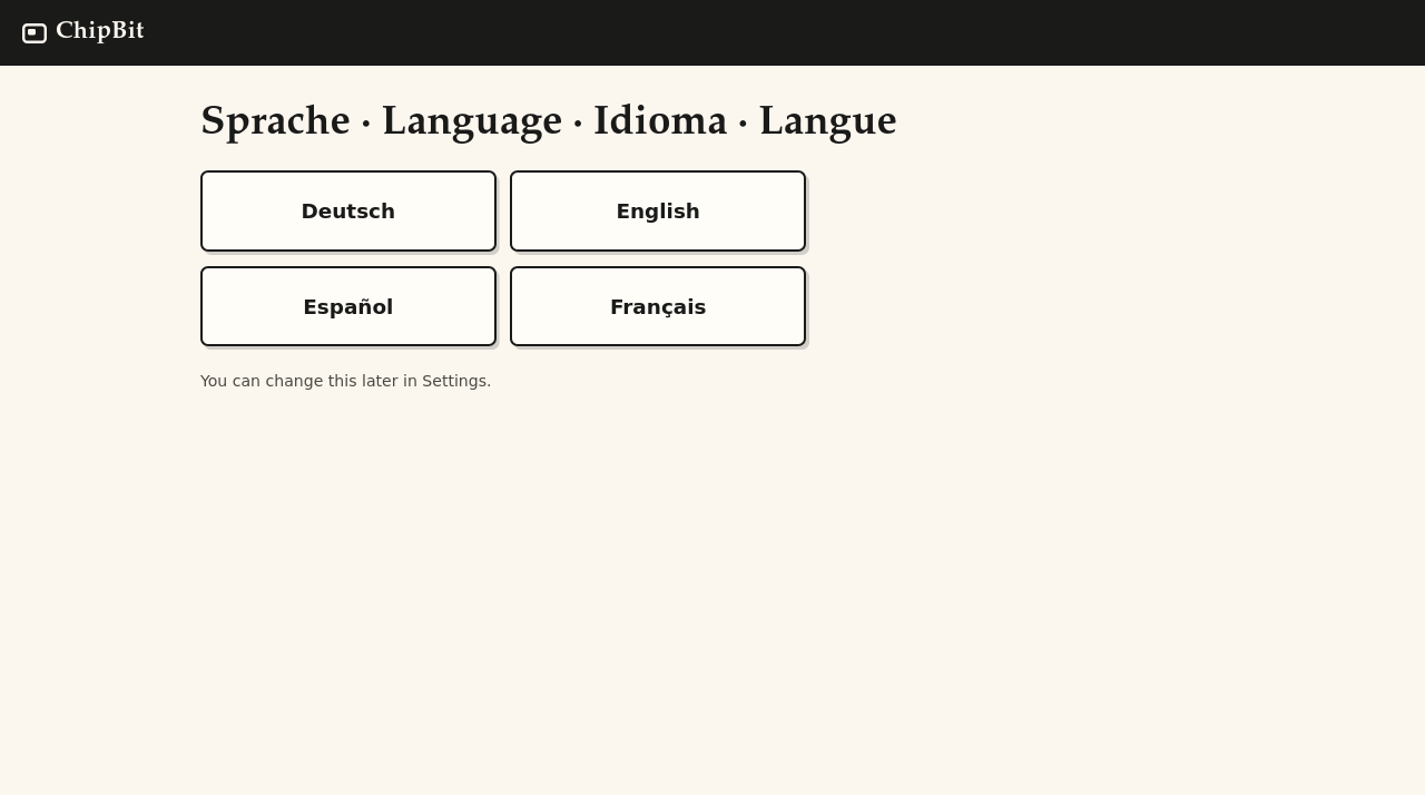

    Plug in a monitor and the reader, power it up, and wait a couple of minutes while the filesystem expands. You will need to choose a card to be your admin card, which gives you access to the admin panel as a parent. The wizard asks for your language and lets you set up WiFi.
