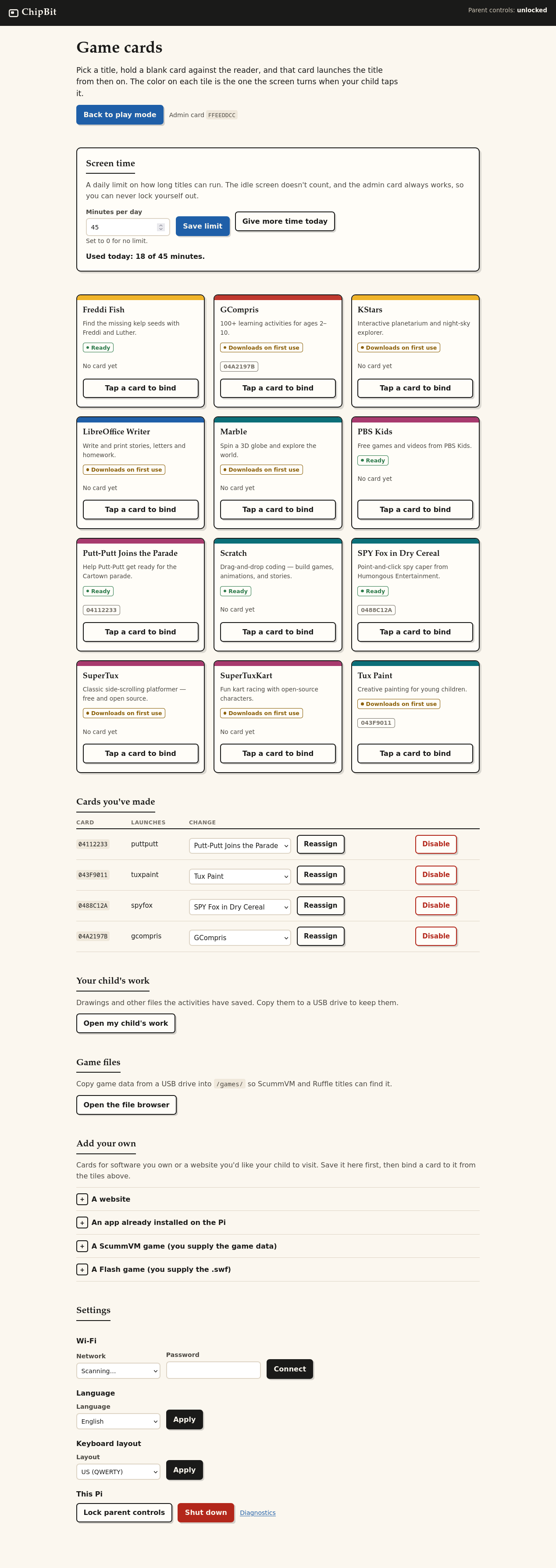

Plug in a monitor and the reader, power it up, and wait a couple of minutes while the filesystem expands. You will need to choose a card to be your admin card, which gives you access to the admin panel as a parent. The wizard asks for your language and lets you set up WiFi.
4Enroll Cards and Add Game Data
Pick any title from the console to enroll a card that launches it. Further down you'll find wizards that help you import data for ScummVM games or Flash SWFs from external media, like an external CD drive. Simply follow the on-screen instructions. You'll first select the drive where the data exists, import it, then tell the console what type of game or media that import was. You will then be able to enroll a card that launches it. The "Add your Own" section also enables you to enroll sandboxed websites.

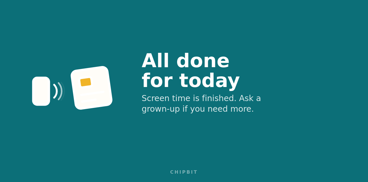

5Set limits
The parent console has a form at the top of the screen that lets you set daily screen time limits. When the budget is exhausted, your child will see this:
You can also grant more time for today using this form.
