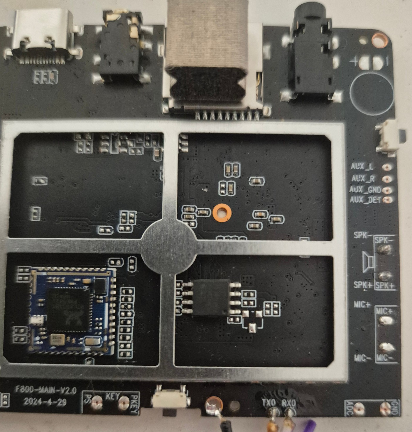

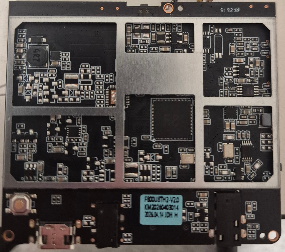

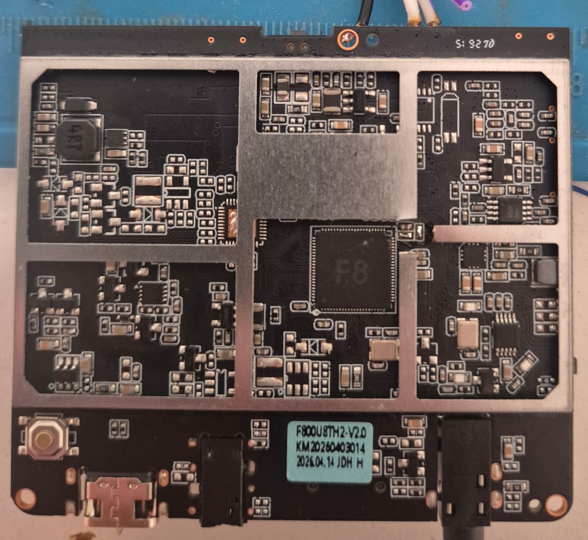

The board inside is very compact and labeled F800-MAIN-V2.0. All components sit under two metal cages whose lids come off without a soldering iron.
  • CPU: the marking is etched away and only "F8" remains. There is no DDR chip nearby, so the memory appears to be integrated into the SoC package. So this is most likely an Allwinner CPU from the V85X family with 64 MB DDR2 RAM (from bootlog).
  • Storage: 16 MB SPI NOR flash (XMC XM25QH128D).
  • Wireless: a combined BT/Wi-Fi module based on the RTL8733BS.
  • Other: a power button (not a switch). The mic and speaker cables are soldered directly to the board without connectors.
My first guess was that it's a V851S which also has 64 MB SiP RAM. But in the bootlogs appears the "v837s-f801u8_102" string which turns the CPU model into cost-optimized V837S version without NPU. Both cores seem to be the same, that's why FEL reports it as V853 family.
UART
The board has RX/TX test points on the side, but there was no activity on TX. Tracing showed that the 0 Ω resistors between the CPU and the test points are not populated. Two solder bridges fixed that and the boot log appeared on the UART lines. To access that pads I had to cut out small part of the cage.
Bootlogs also confirm 64MB DDR2 inside and probably v837s.

FEL mode: the puzzle
From the HZ-B500, the first thing I knew about Allwinner devices was that shorting an SPI flash data line to GND activates FEL mode after no bootable media was found. I did that with MISO, connected the cable, and the boot process stopped, but nothing happened...
The PC saw no FEL device. That surprised me, so I started to investigate.
  1. Is USB-C power only? I traced D+/D-. There are two pairs of 0 Ω resistors, all present, and the connections to the USB0-DM/DP pins of the CPU are intact. The missing CC resistors could explain problems with USB-C-to-USB-C power, but my USB-A-to-USB-C cable powered the board without problems.
  2. The power button. After more experiments I noticed that FEL mode is entered only while the power button is held down, and disappears when I release it.
So the button only starts the power circuit, something has to latch it on after boot. In FEL only the BROM runs, and nobody does that.
The power-hold pin: PH0
I dumped the flash in FEL (holding the button) and analyzed the bootloader.
The result:
  • boot0 does this as the very first thing in its main function: it sets PH0 as an output (PH_CFG0 at 0x02000150) and drives it high (PH_DAT at 0x02000160, bit 0).
  • The 4.9 kernel does the same through a sys-power driver, from the device-tree node sys_power with gpios = <&pio PH 0 …>.
So the "boot stopped, FEL not entered" symptom was FEL running only while the button was held. Holding the button, I could latch power by hand:
sunxi-fel writel 0x02000150 0x1    # PH0 = output
sunxi-fel writel 0x02000160 0x1    # PH0 = high
After that the button can be released and the FEL device stays on USB. sunxi-fel -l shows:
USB device 003:086   Allwinner V853    [chip ID redacted]
FEL reports V853 because the chip ID seems to be shared, so this identifies the family but not the exact part.
