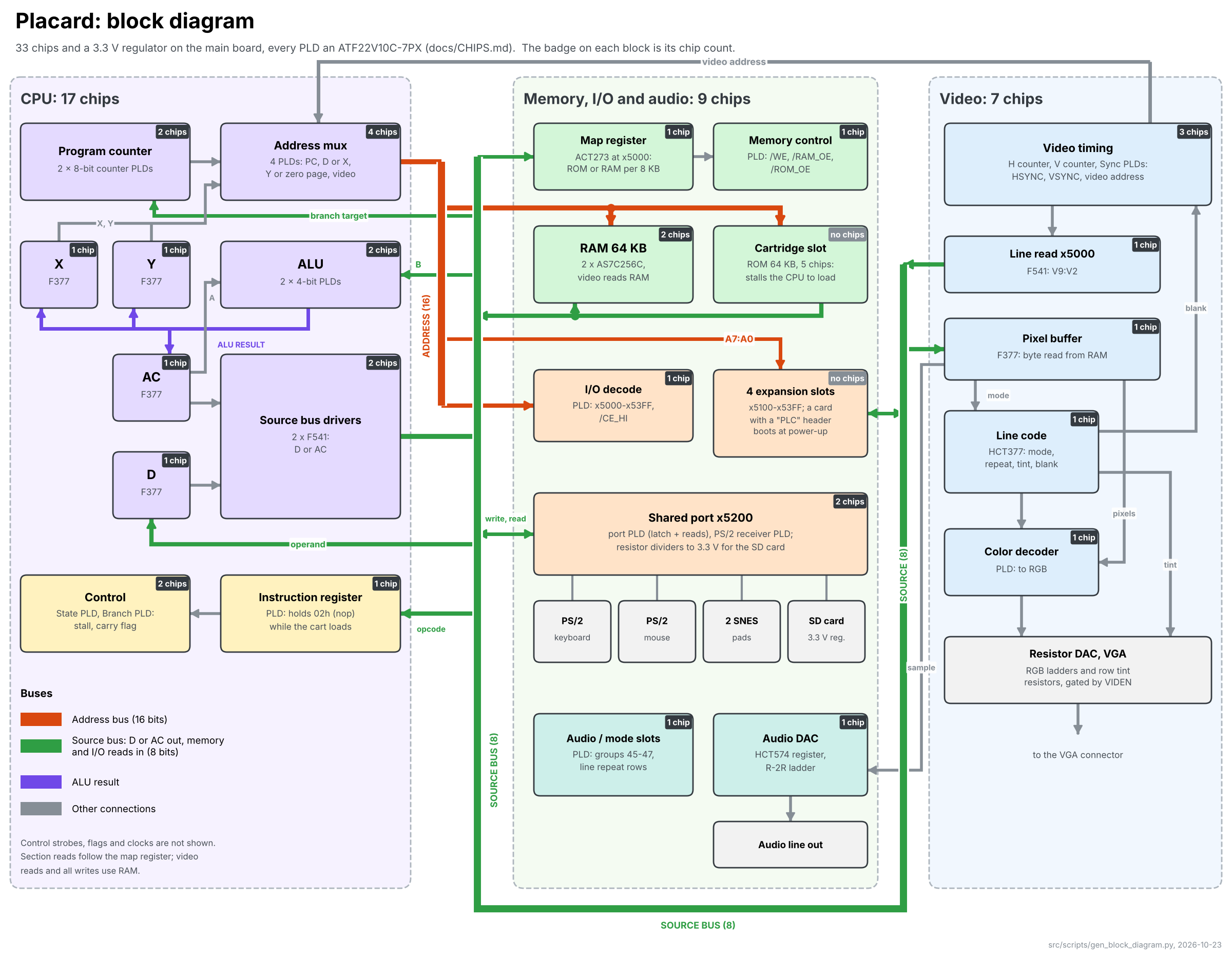

The project started as a pure 7400-series computer, but to meet the goals I conceded it would take too many simple gate chips to achieve it.  So I swapped some gates for 22V10s.  The first PLA was on the market in 1970 - the first PLD in 1977, so thematically it still meets project goals.  It ended up 33 chips on the main board plus a 3.3 V regulator, and 3 on the cartridge.
This computer was inspired by the ones which came before - the Gigatron, Ben Eater's, Novasaur, Isetta.  There are similarities in the architecture.

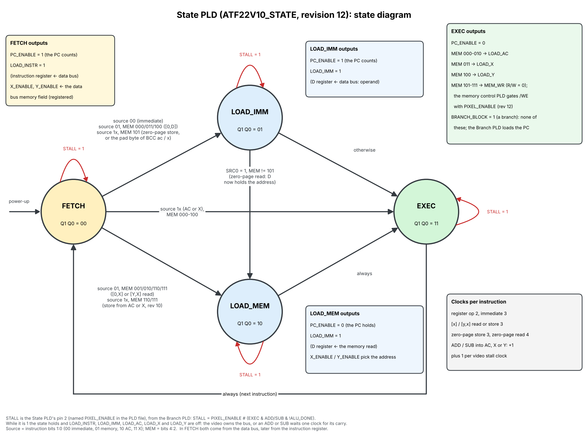

CPU
  • 8-bit data, 16-bit address, von Neumann, 25.175 MHz clock (the VGA pixel clock).
  • Instructions take 2, 3 or 4 clocks
  • Registers: accumulator, X, Y and D (immediate/memory operand), each a 74F377.
  • Controlled by a 4-state machine (FETCH, LOAD_IMM, LOAD_MEM, EXECUTE) in one PLD
  • ALU: two 22V10s, 4 bits each, with zero, sign and a carry flag (reminiscent of the obsolete -181 ALUs)
  • Program counter: two 8-bit loadable counter PLDs.
  • Address mux: four PLDs pick Program Counter, zero page, [Y,X] or the video address.
  • Addressing: immediate, [0,D] and [0,X] zero page, and [Y,X] 16-bit.
  • Instruction register is itself a PLD, which also holds a NOP while the cartridge loads so the CPU waits without gating the clock.

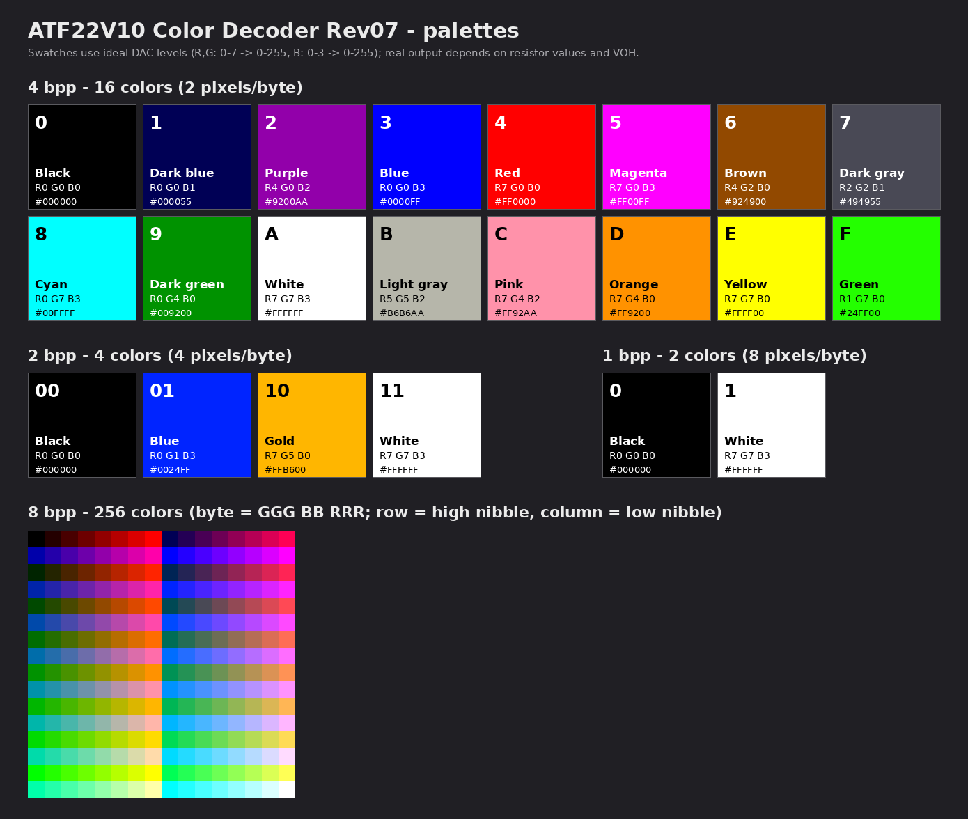

  • Colors modes are adjustable per line:
    • 640 monochrome pixels or
    • 320 4-color pixels or
    • 160 16-color pixels or
    • 80 256-color pixels
  • RAM can be conserved by select lines to repeat
    • 1x mode reads every line
    • 2x mode skips every other line (half of required RAM)
    • 4x mode skips 3 lines at a time (quarter of required RAM)
  • Modes mix freely down the screen: 80-column text above a 256-color picture, for example.
  • Each row can be tinted with another 8 colors
    • Gives colored text backgrounds and raster bars for free.
    • Provide some background color in monochrome mode
    • Provide color gradients in other color modes
  • Each RAM byte is processed by the Color Decoder PLD which turns it into RGB with a resistor DAC.

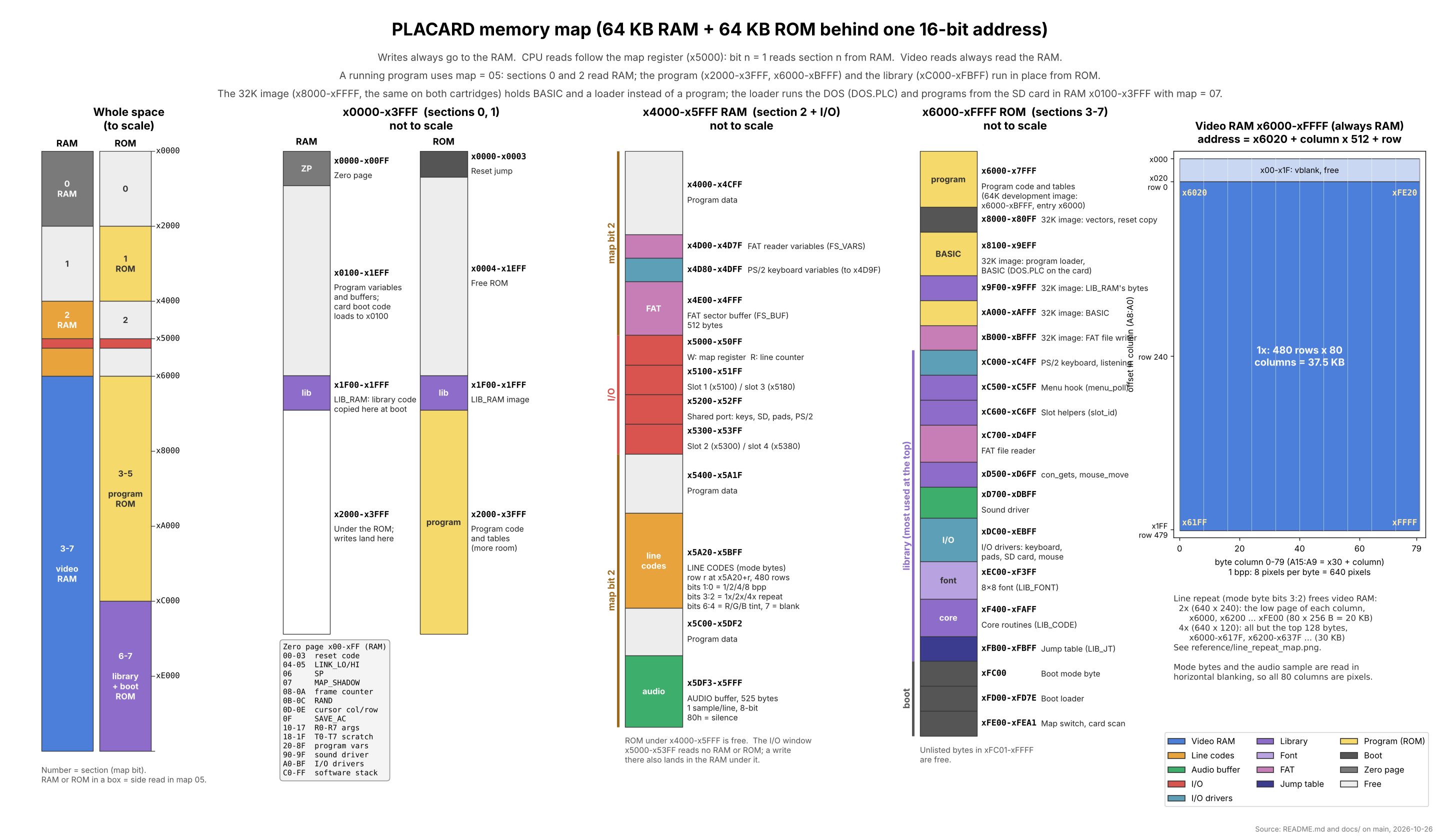

Memory
  • 64 KB RAM (two AS7C256 15 ns SRAMs) and 64 KB of ROM space behind the same addresses, in eight 8 KB sections;
  • A 8-bank select register picks RAM or ROM per bank for reads (writes always go to RAM)
  • Dedicated I/O window at x5000-x53FF address space
  • The video reads the same RAM as the CPU: the video area is x6020-xFFFF, and the video circuit steals clock slots from the CPU in a fixed pattern, so software never has to time its code to the beam.
