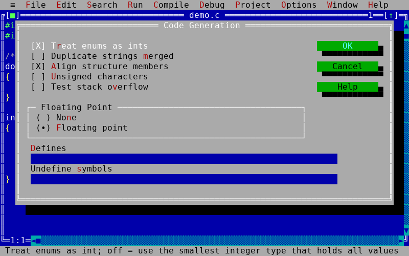

Flash C is a small C compiler with a full-screen, text-mode IDE. Both are written from scratch and both run on Linux. The compiler, fcc, reads C source code and writes a native x86-64 Linux executable directly. No assembler, linker or C library is used at any point. The IDE, fc, wraps the same compiler in pull-down menus, overlapping edit windows, an error window, option dialogs, a source-level debugger and hyper-linked online help. Its layout follows the classic Turbo Vision style IDEs. This post shows what is in the project and how it works inside.

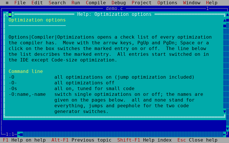

To bring the experience back, I first had to answer a question: how does a classic IDE of that era behave, in enough detail to rebuild it? To find out, I studied the executable of Turbo C++ 3.1, which is available from the Internet Archive. The study was purely static. I read the executable headers and segments, and I extracted the text tables: menu items, dialog controls, status-line hints, the diagnostic messages, the command-line switches and the color table from the settings file. Nothing was executed, and no code, library, header, help text or other file from the original product is used in Flash C. The result of the study is only a description of how the IDE looks and behaves: which menus exist and in what order, which options each dialog holds, how the Message window tracks errors, and what the diagnostics say. The method and findings are written up in analysis/EVIDENCE.md in the repository. The script that rebuilds the raw extracts is included, but the extracts themselves are not distributed.
With that as a guide, I built the compiler first. It follows a conventional pipeline. The source goes through the lexer and preprocessor, then a parser that builds a typed syntax tree, then the optimizer, and finally the code generator, which writes the ELF file.
