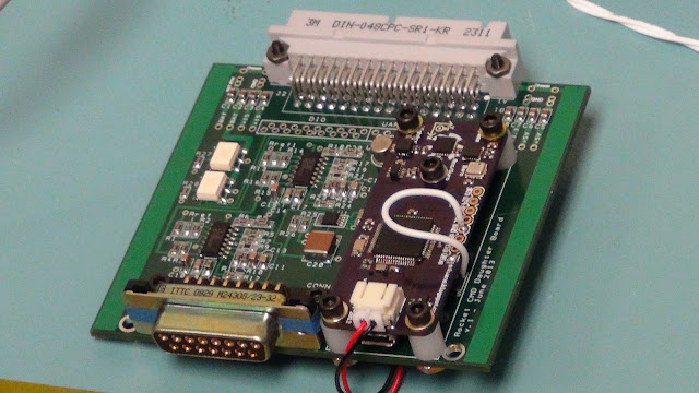

The Rocketometer is a set of MEMS sensors integrated along with a microcontroller and an SD card. One could say that it is a self-contained spacecraft, after the model of such distinguished predecessors as Explorer 1. It has sensors, self-contained power, and a structure capable of withstanding the rigors of launch and spaceflight. It does not have telemetry, but it is recoverable. Therefore, I like to claim that I built my own complete spacecraft.
I proved my claim on 21 October 2013, when the Rocketometer, traveling on board NASA Sounding Rocket 36.290, traveled into space, safely returned, and functioned properly through the whole flight.
One of my long-term projects, or rather dreams, has been to record a trip on the Space Mountain roller coaster in Disneyland, California. Since it is in the dark, it is difficult to get a good idea of what the track path is. I designed a Rollercoasterometer to measure the track with inertial sensors.
The first version, made in 2009, was on a breadboard in a small plastic box. I carried this box in a backpack and successfully measured the forces, but I was not able to analyze the data to the point where I could measure the speed and position of the course. This breadboard version consisted of a Sparkfun Logomatic and several analog MEMS sensors. The Logomatic was used to digitize and record the measurements.
Science Marches On, and after a short while, the sensor manufacturers were packing more and more sensors into smaller and smaller packages. In 2012, the state of the art was to have the ADC built into the sensors, which then reported their measurements digitally over an I2C or SPI bus.
Since the Logomatic is open source hardware, I used it as a jumping-off point for a custom board with an ARM microcontroller, three MEMS sensors, and one magnetic sensor. The high-force accelerometer was analog, so I used an external I2C ADC to convert that measurement.
I designed the board to be small and light enough to fit into the payload compartment of a small model rocket. The final dimensions are 0.9 inches by about 2.4 inches, easily small enough to fit within a 1.1" diameter payload section. This is when it became a Rocketometer in addition to a Rollercoasterometer. This device is much smaller and easier to carry in a pocket, rather than a backpack.

As things turned out, the Rocketometer functioned perfectly, on roller coasters (including Space Mountain in Disney World, Florida), in a model rocket (twice) and in the sounding rocket. I finally got around to mounting the device this past Christmas.
